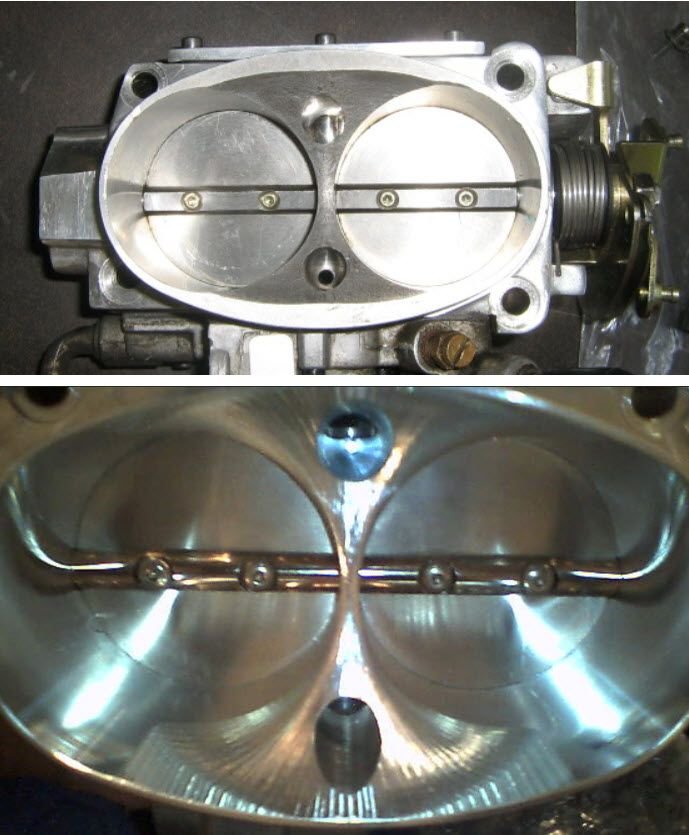

Mini update:
I was able to score a used AS&M 58mm TB today for a real good price so I'll be replacing my Professional Products 58mm TB with it. See below for the difference in the inlet portion between two (pics aren't mine, found these comparison pics from an old thread on here - Summit/PP on top, AS&M on bottom):
Realistically speaking, there may be no to a very little 1-3hp difference between the two but the integrated airfoil cannot hurt. I like the improved quality of the AS&M unit and always wanted one, price was too good to pass up so why not. I'll be posting my polished Professional Products 58mm TB for sale soon if anyone is interested.
I'm doing some EWP research so looking to pick up one of those as well. There may be a handful of hp there since it's moving less coolant at WOT, another benefit being the ability to run the pump in the staging lanes to cool the motor down.
Two very small improvements but they are steps in the right direction.

Beautiful throttle body man, very nice. As for the little dents in your headers and mufflers, idk. All I can tell you is that I watched an episode of Engine masters where they beat the crap out of a set of headers with virtually no change in performance. Based on that I wouldn’t be too concerned.
