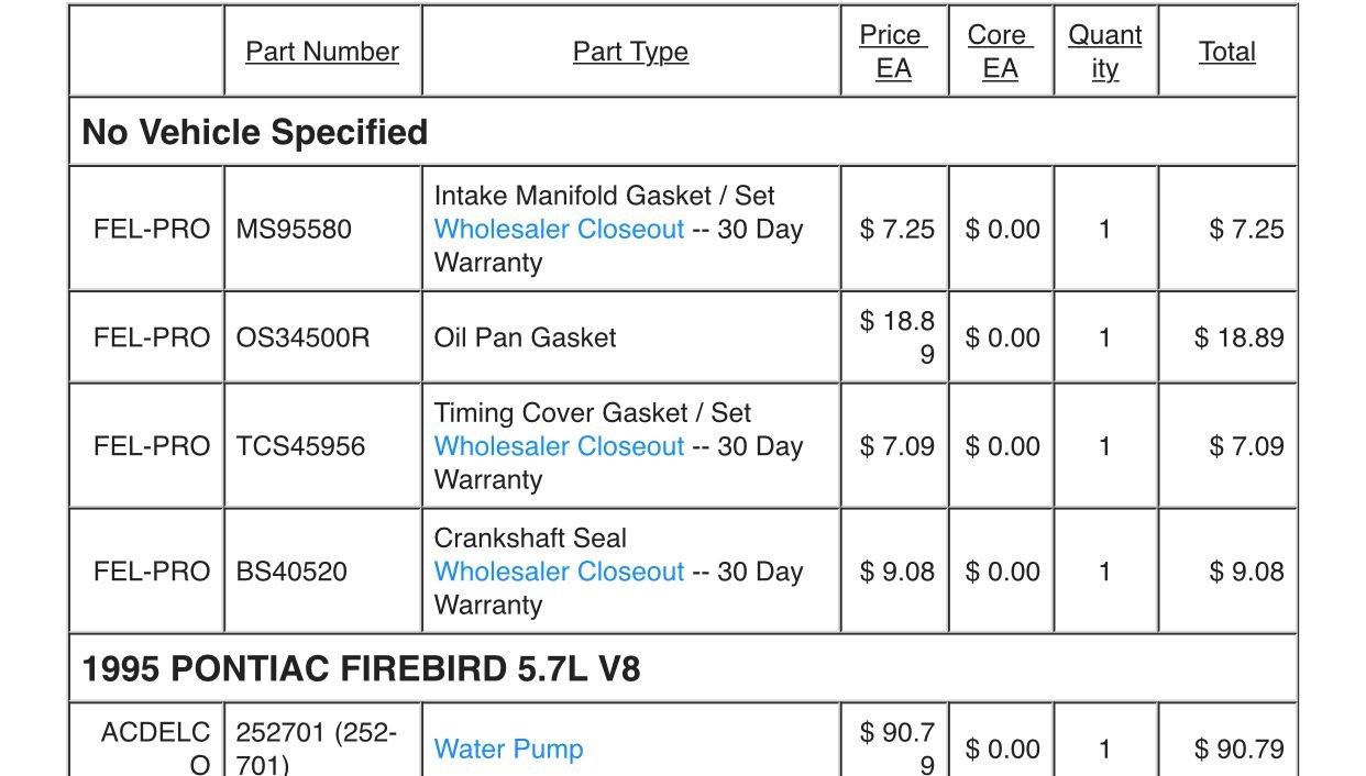

So I’m sourcing the gaskets needed for the cam/heads package I’m getting from Lloyd for my 95Z28, just want to make sure I have all the necessary gaskets. Here’s what I’m looking at buying:
Felpro timing cover gaskets:
https://www.summitracing.com/parts/fel-tcs45956/
Felpro intake manifold gaskets 1284:
https://www.summitracing.com/parts/fel-1284
Are there any other gaskets that I’ll need? I know the water pump gasket, but what about the oil pan? Balancer bolt? I was also looking into what water pump I should get; is the Meziere pump a good choice, or should I go stock? I’d really like to go with something nice/worth the money. Also, how about the timing chain, any recommendations? Any help is appreciated.

This is what I ordered. Cheap insurance to replace them all. Bolts should be fine. Not sure about the chain.
