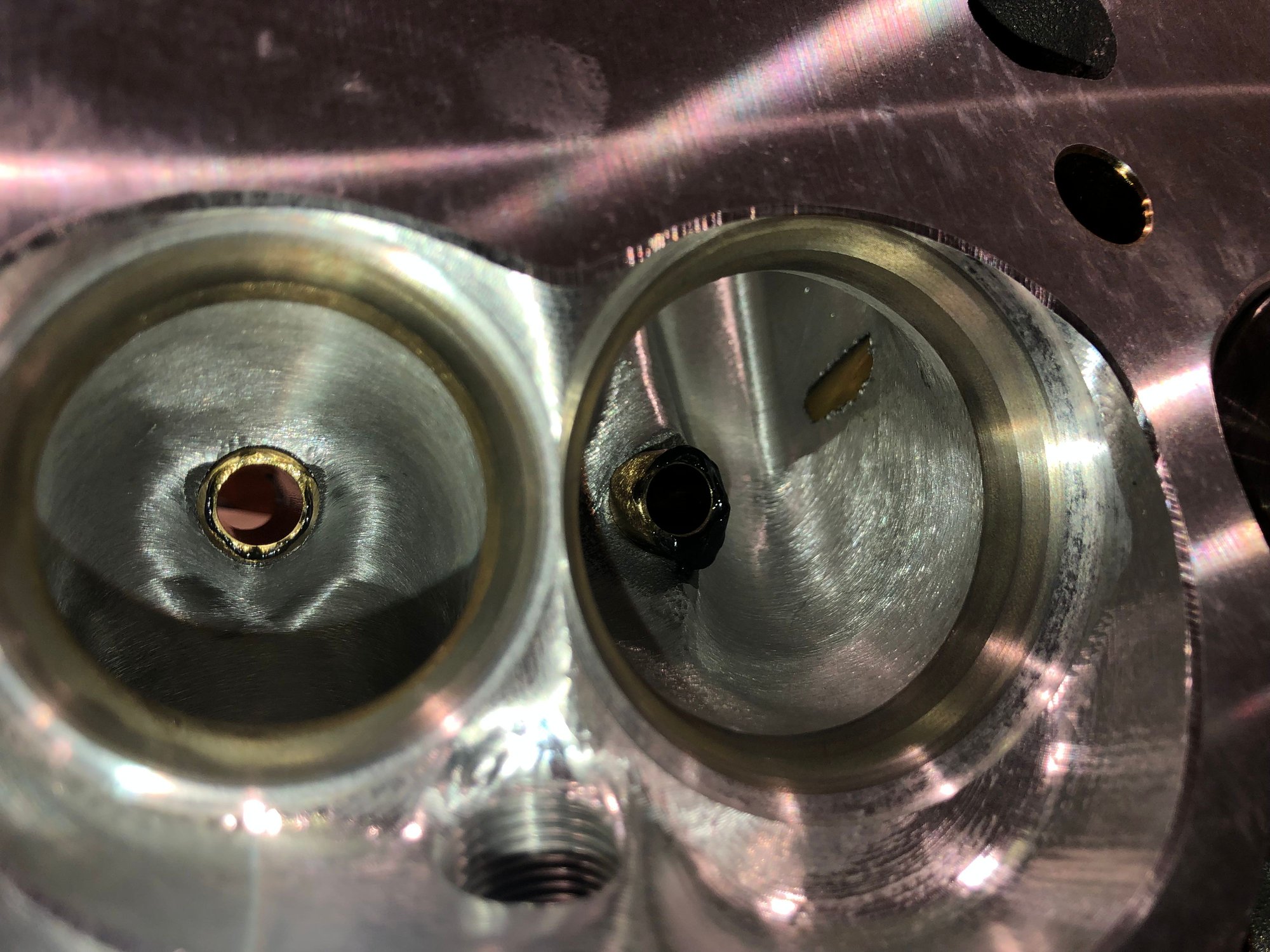

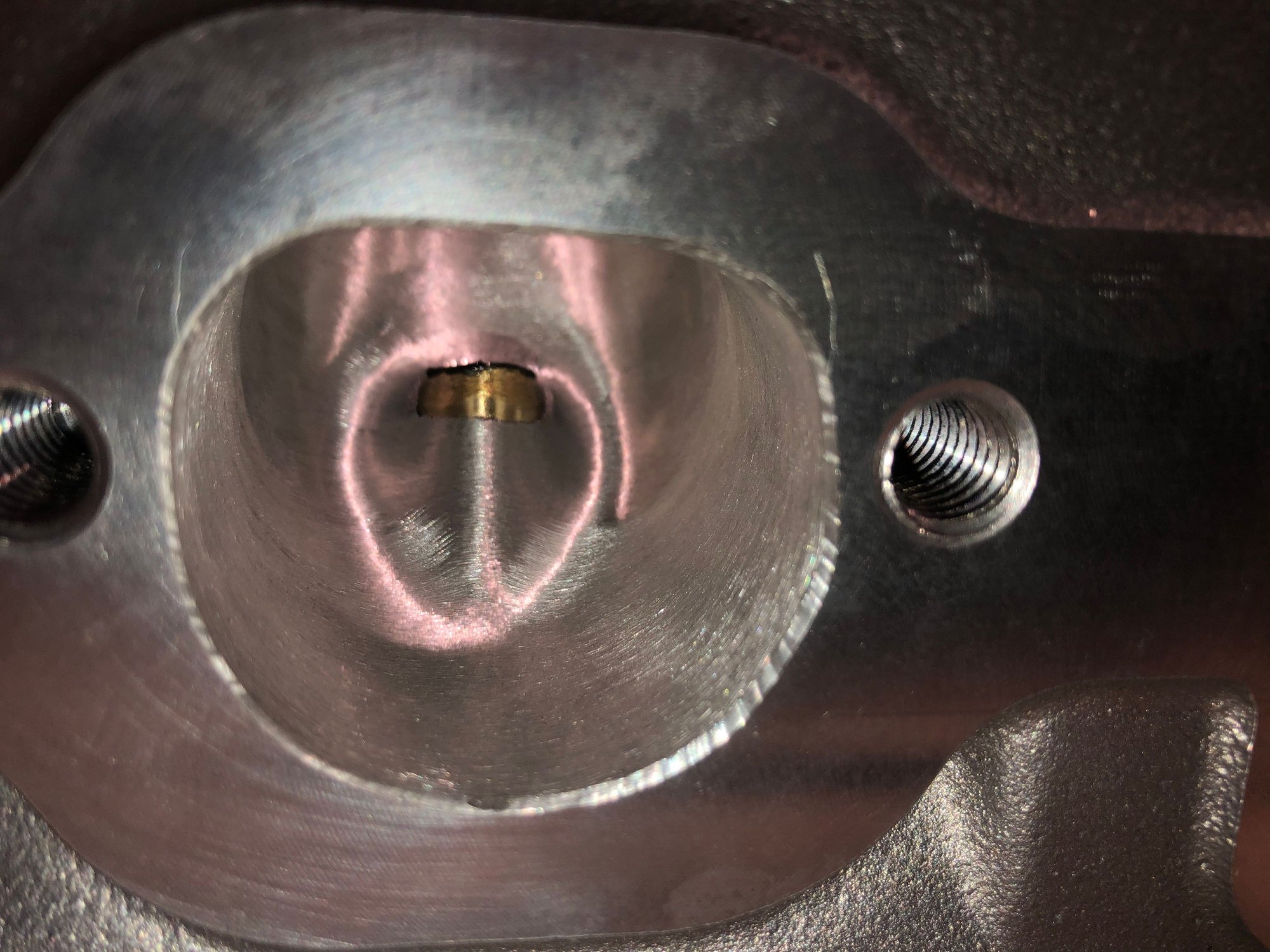

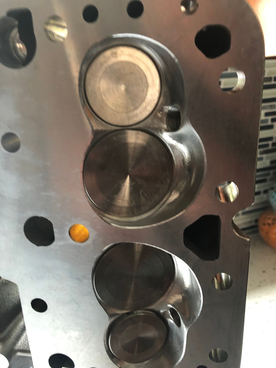

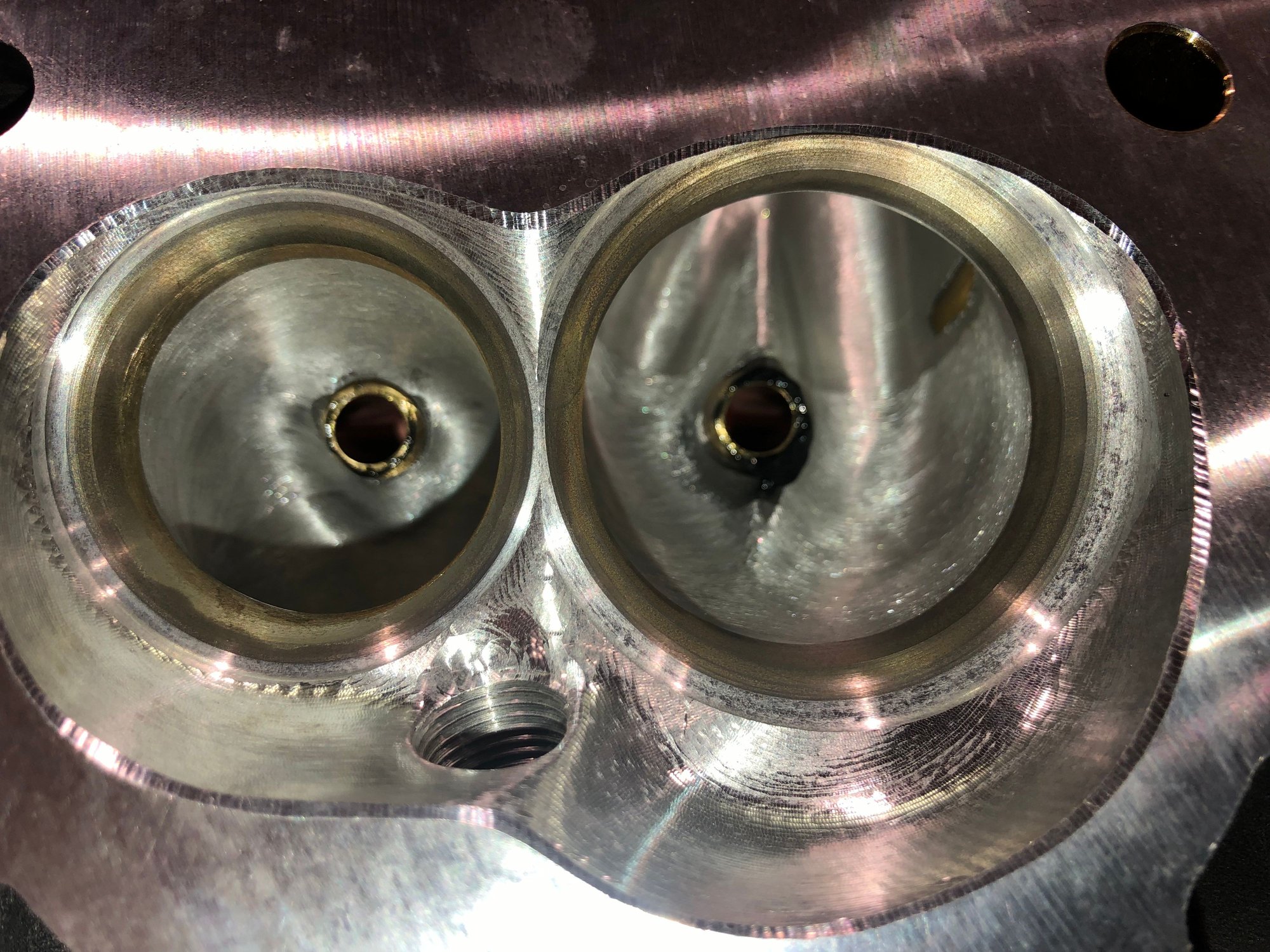

I love something beautiful!!! It don't get much better than my wife but these are hot!! I'm still awaiting a few things in the mail to get the heads fully assembled and back on the car. I'm excited to say the least.

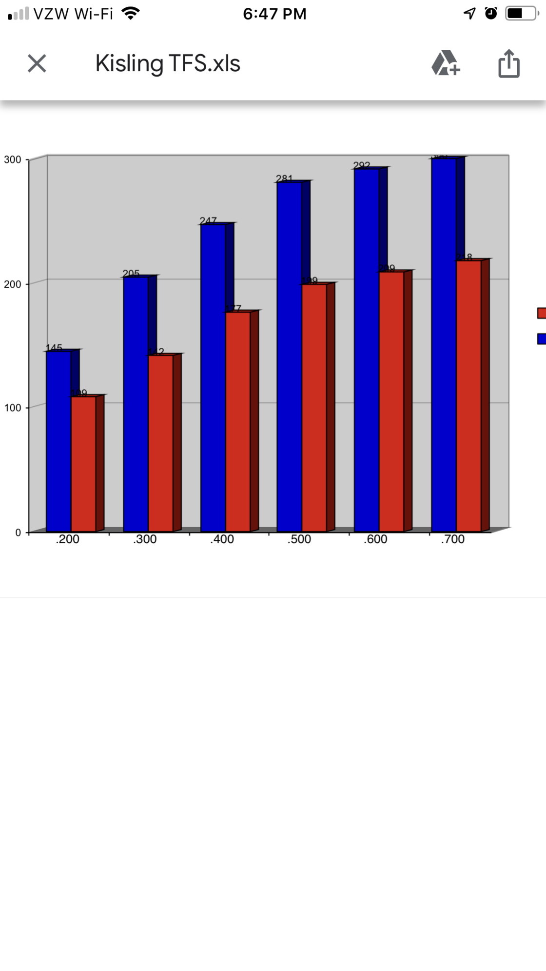

What are the specs on the ported 21° Trick Flows?

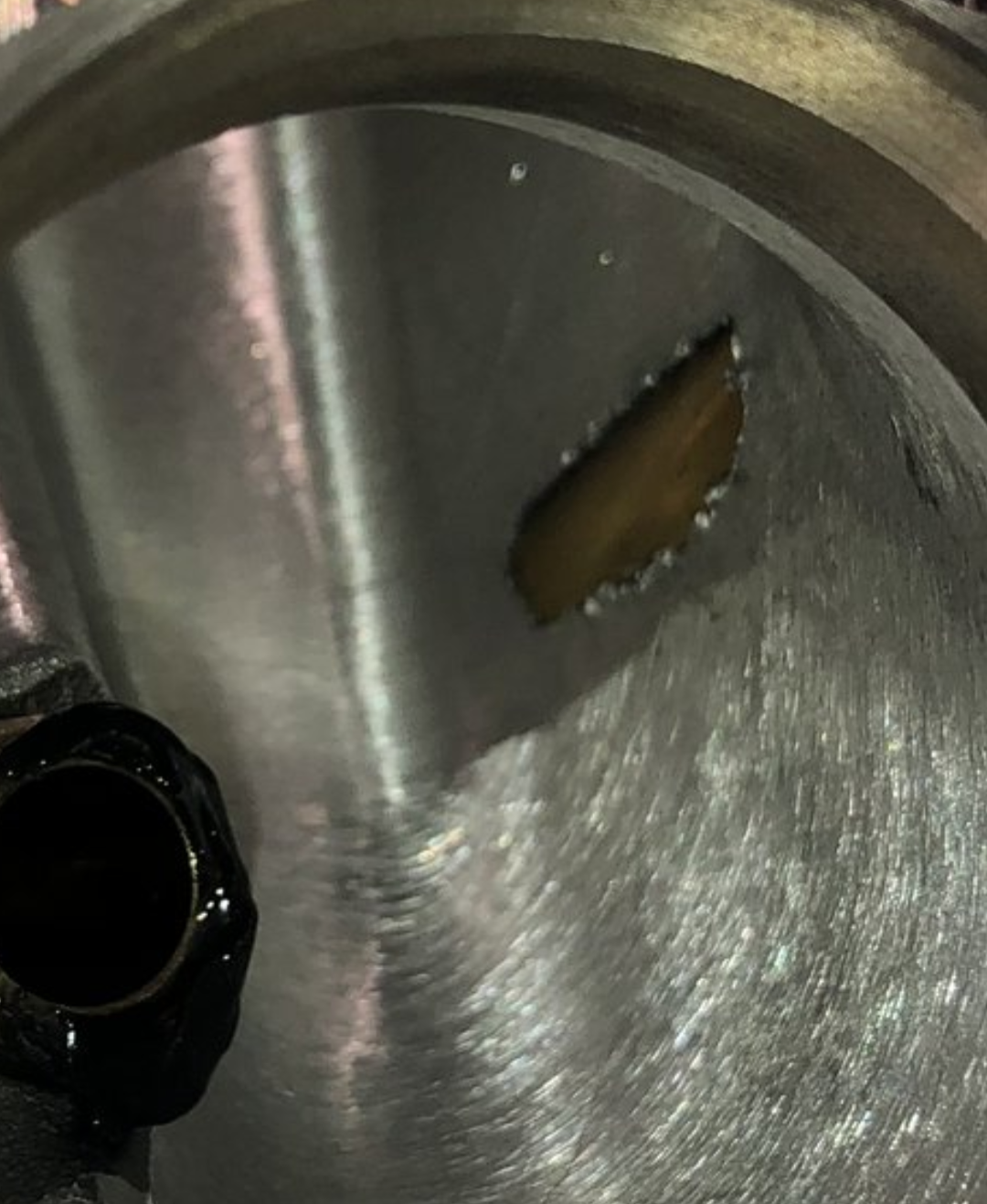

Did he break through the port on that runner?

Hmm, kinda looks like it.

He did on everyone of them. That's what it took to get the shape he wanted.

I guess it must go into a dry sealed area if he did it on every port.

But even then I would have thought filling the void with epoxy and then cleaning it up would result in less turbulence and a little more flow.

Ridiculous.

I've never hidden my disdain for **** like this. I really hope it works out for you. I would have an issue with epoxied heads on a street car. Before installing them I'd get a pressure test done. They have been known to leak before.
