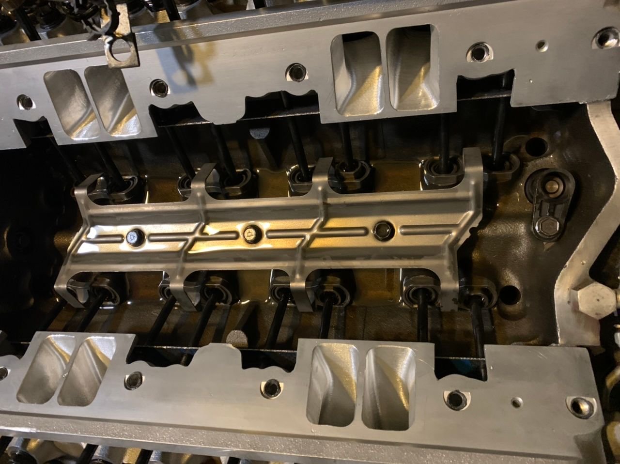

Success!!! Took like three minutes to get oil out the rockers. Blue loctited the gear drive and “snugged” it up using a 1/4” drive. Thanks again!!

From: Tucker, GA
You will sleep much better knowing you did the job correctly.
BTW - heads have some nice port work!
