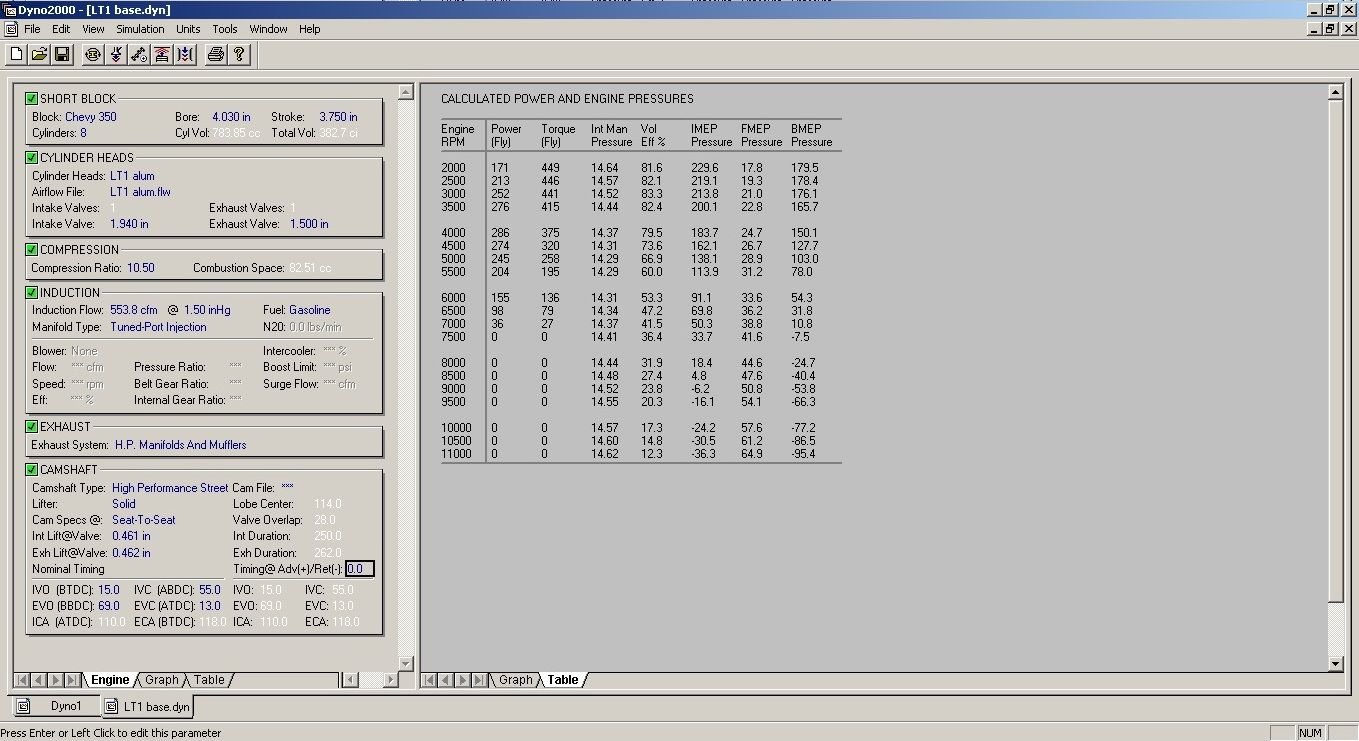

Just for giggles I attempted to spec a cam per David Vizard's 128 formula for this combo.
Assuming a 10.5:1 static 383, 1.94 intake valve
Specs calc'd out to 105.5 lsa, and roughly 250 duration (@ .006) - depending on how much overlap you want.
Picked out some CompXE lobes that looked close and ran them a few different ways. Lobes were 5440 for the intake and 5442 for the exhaust. Specs are 250/262 @ .006, 206/218 @ .050, 117/130 @ .200, .288/.308 lobe lift. All tests with 1.6 intake/1.5 exhaust rockers.
I went long on the exhaust to help offset the stock(ish) exhaust manifolds.
106 LSA on a 106 ICL (best looking graph IMO)
advanced 2 degrees (104 ICL)
Here's what happens when you widen the LSA (did not play with multiple ICLs OR wider LSAs - this is enough to make the point)
114 LSA on a 110 ICL

two more - same cam, stock lt1 intake
383
350
don't think I'd waste the money on a stroker tpi when you could hit the target with a baby cam, set of headers, and a tune on an otherwise untouched 350...

Originally Posted by Polyalphaolefin
Dyno2000 makes a lot of assumptions in its calculations, but I agree with it for the most part. I use Engine Analyzer Pro.
YES it does, but it's good enough for my purposes (general trends - not accurate predictions). I mostly play with junk these days and DGAF...
I don't have EA Pro anymore but even that one could give some 'out to lunch' numbers - GIGO
