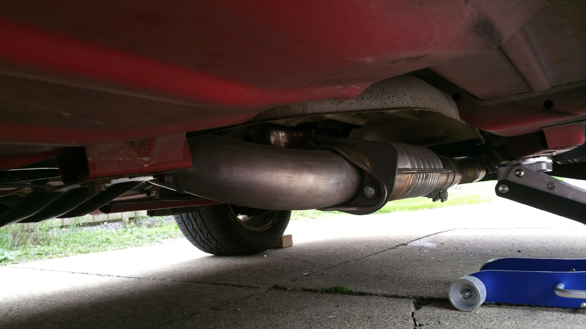

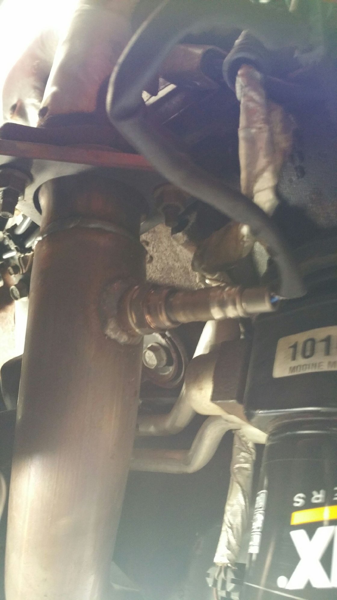

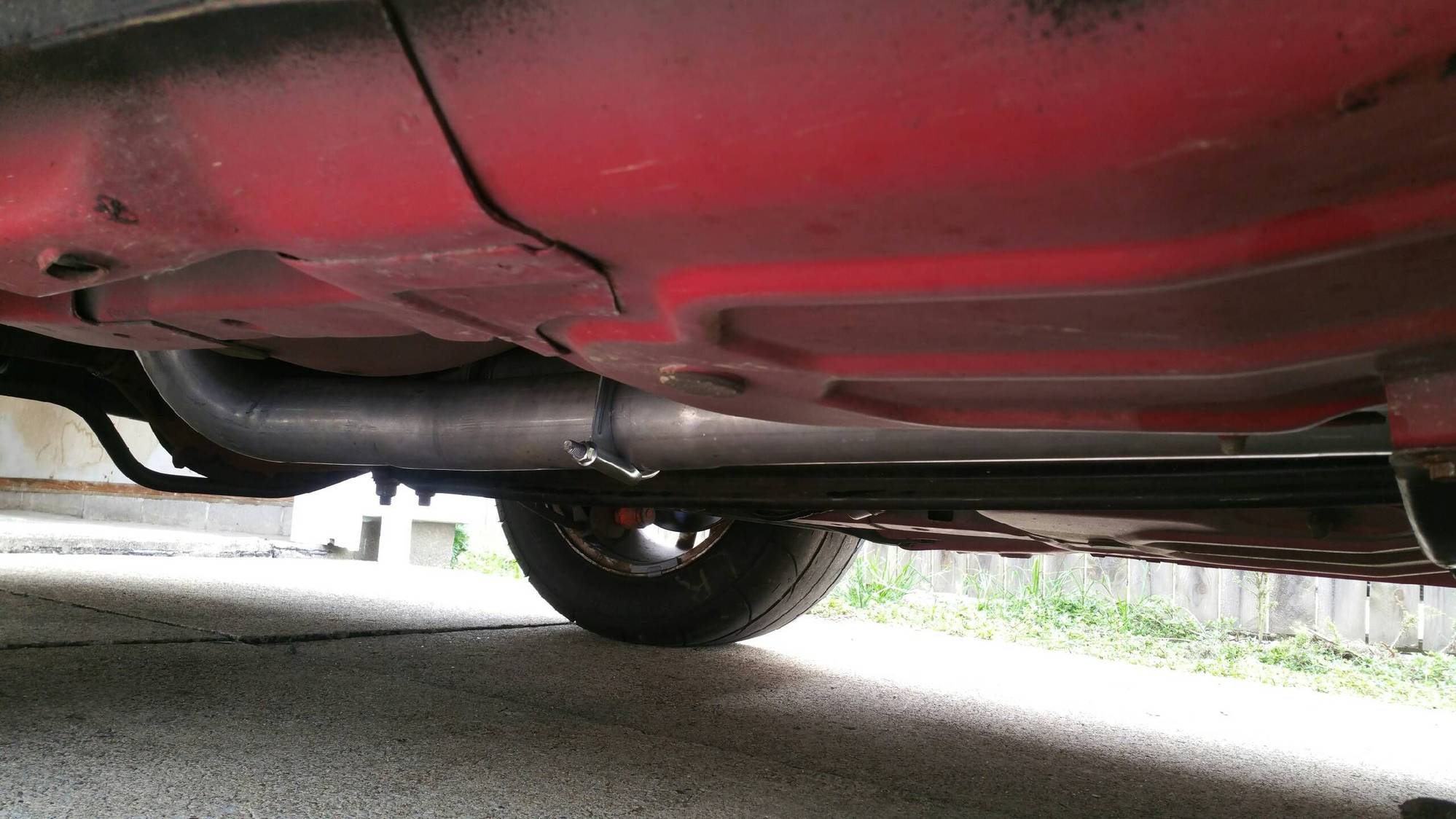

I was kinda where you are at last year. I just wanted a cheap old car to tinker, cruise, and make a couple passes down the strip.
I cant figure for the life of me why one would want to convert their OBD-II to OBD-I besides computer, wiring harness your going to have to change the timing cover as well- man good luck lol!
As far as exhaust I’ve had loud cars in the past (still have a loud Mustang) but didn’t want to go the loud/smelly route this time. I ended up doing a Magnaflow high flow catalytic converter 2.5” into 3”, 3” Flowmaster cat back while running the stock manifolds.
So now the car sounds 1 notch above stock idling, 2 notches at WOT, no smell, and it looks like it rolled off the showroom floor.

Appreciate the pics and ideas.
