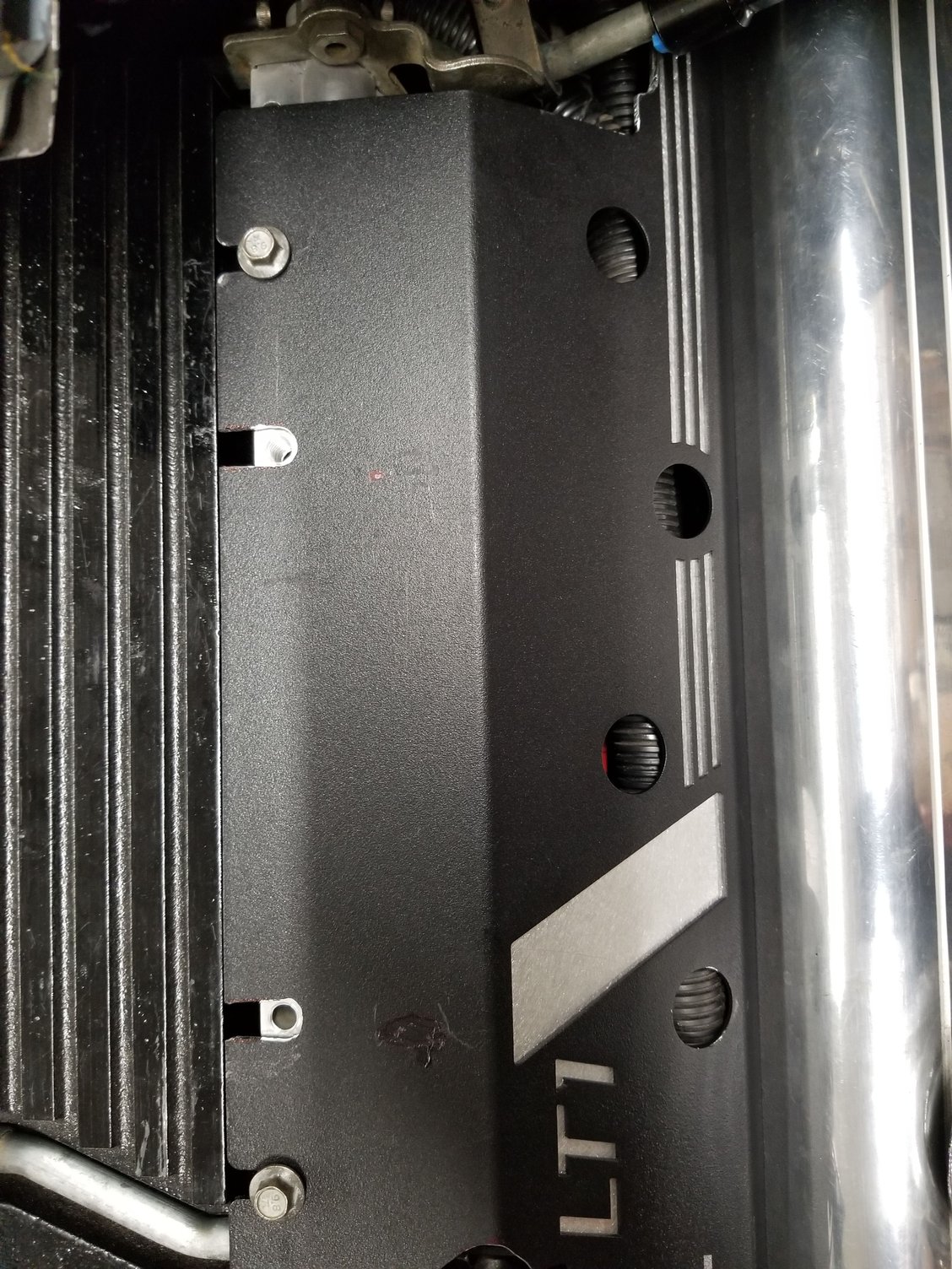

I was unable to use the Nitrous Outlet plate with the Torq Head 'intake style' coil bracket. And their valve cover coil brackets would not work for my set up either. So I picked up an ICT billet coil bracket and did some modifying. You'll need to flip the end pieces of the coil bracket (opposite of the directions) so the mounting tabs point inward. Then drill some new holes in the ICT bracket right between the existing holes. Next drill and tap some holes in the fuel rail. I used the 2 forward existing holes that are already in the fuel rail then added some new ones for the rear of the bracket to mount.
Heres what I ended up with. Now theres a perfect gap between the coil mounts, down the center of the intake to run the nitrous lines to the plate.
