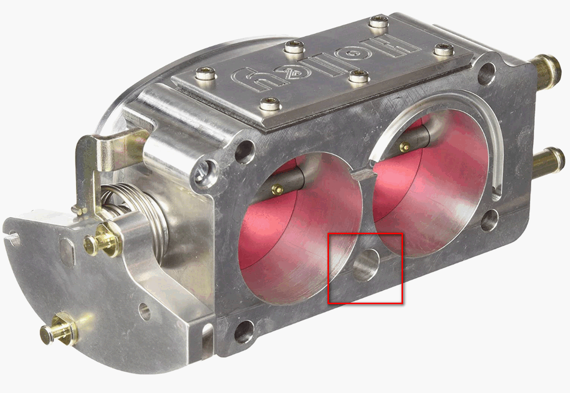

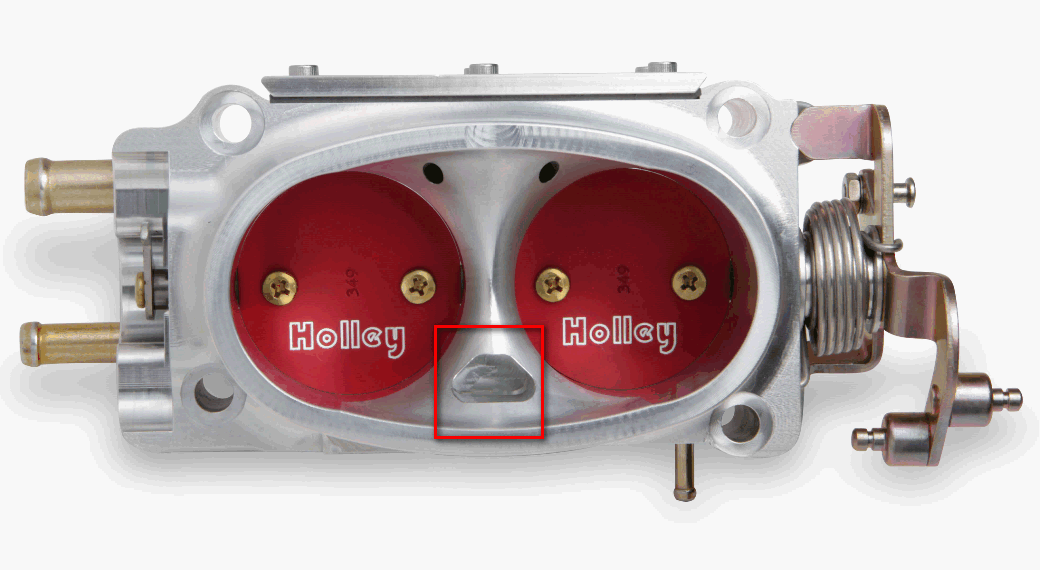

I told you wrong the scientificalness of drilling a hole in the TB. It is called the "drill mod." Some aftermarket TB's do not have a passage drilled through the TB. This passage is there for the IAC to draw filtered air, regulate it via IAC and then feed metered air into the plenum.
Here is where the hole should be:
If I were you I'd take the TB off to see if a there is a passage in this location. I have read the passage is either 1/8" or 5/32's. I thought I read it was also 11/64's which is what I drilled mine out to and it works fine. I'd suggest you do 1/8" first and see how it reacts. If there's already a passage, don't mess with it and pay more attention to your TPS. You need to elongate the mount holes in order to be able to adjust it. With the blades closed it should be in the .7v range with blades closed and 5v WOT.

Yes I have those passage holes on the throttle body, it looks exactly like tht

But is there a passage that goes all the way through? If it's not a direct passage, shine a light through it through one end and see if you can see it on the other side?
K... pretty sure this is some bullshit. I believe the hole to be drilled is actually a bleed hole and not a direct passage into the IAC. Been too long since I did this I've pretty much forgotten how a frickin' TB works. Dang it!

And yes there is a passage threw it, I took it off and sprayed some seafoam threw the hole and it came out the other hole in the back
