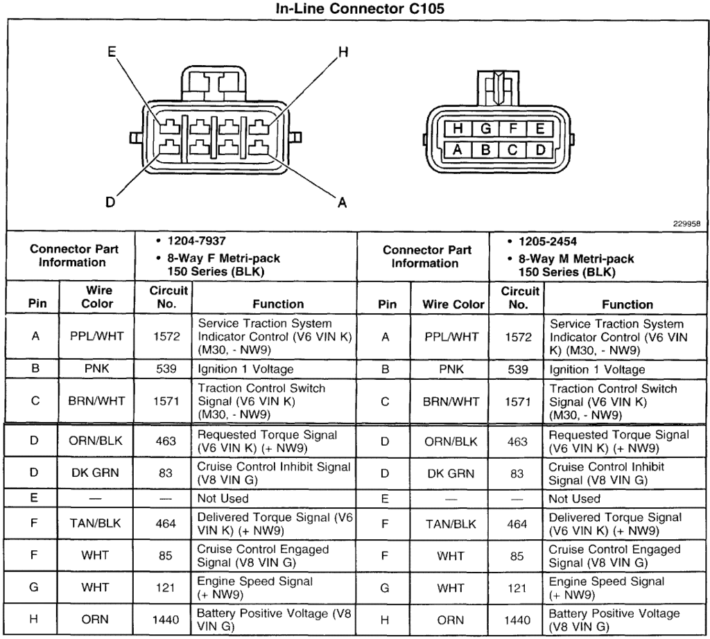

Car is a 1996 SS, auto and I'm doing a 24x swap using the stock harness repinned.
Finally finishing up this repin but it's been a few months since I started vs finishing. I am looking at my harness, specifically the C105 connector. I have only one wire on this thing now, the pink wire. Everything else has been removed from it (and the harness itself). I am powering my coils off the c100. Is this correct? I looked over the pin outs and I feel like I'm missing something, maybe had a brain fart a few months back but maybe not. The car came with no traction control. Can someone double check my work please? Thanks.

The tan wire should be how you get the serial data off the OBD port under the dash.

I believe 96-97 doesn't use this anyway being obd2 iirc.
