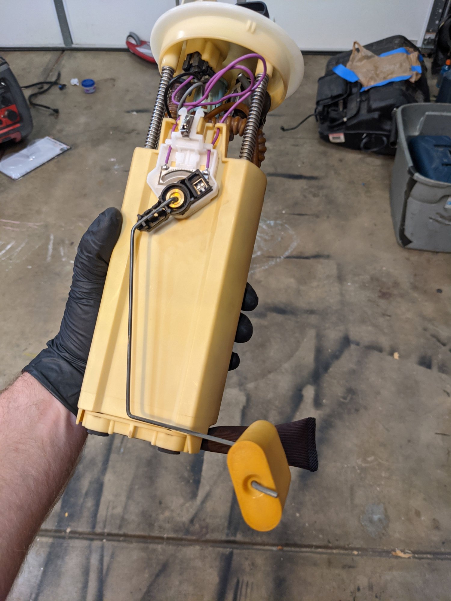

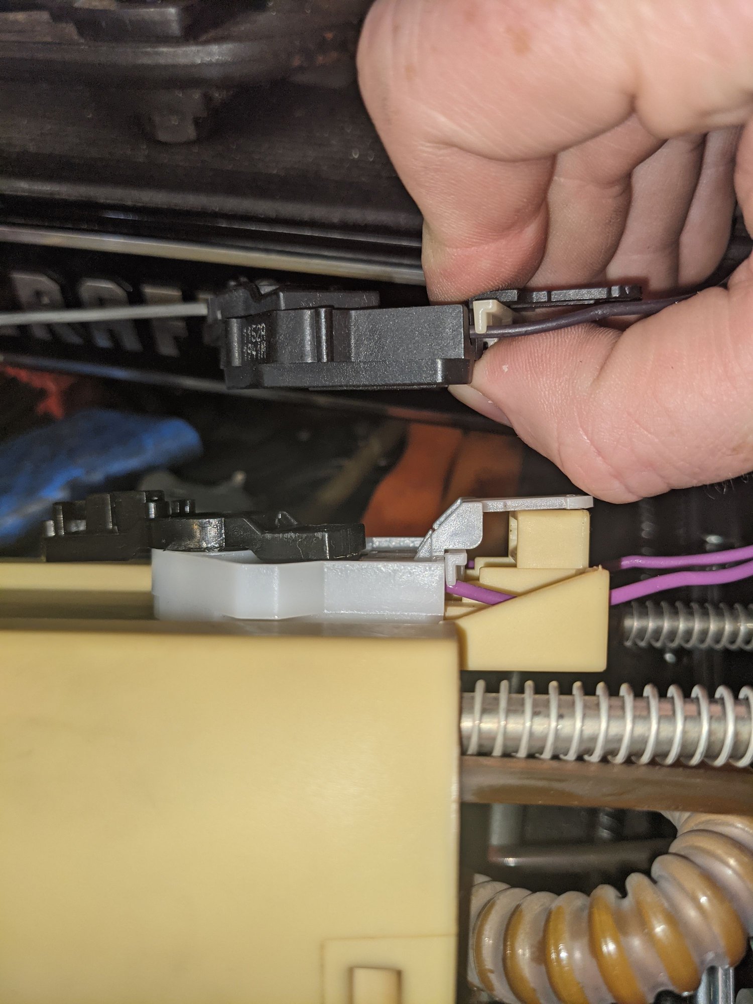

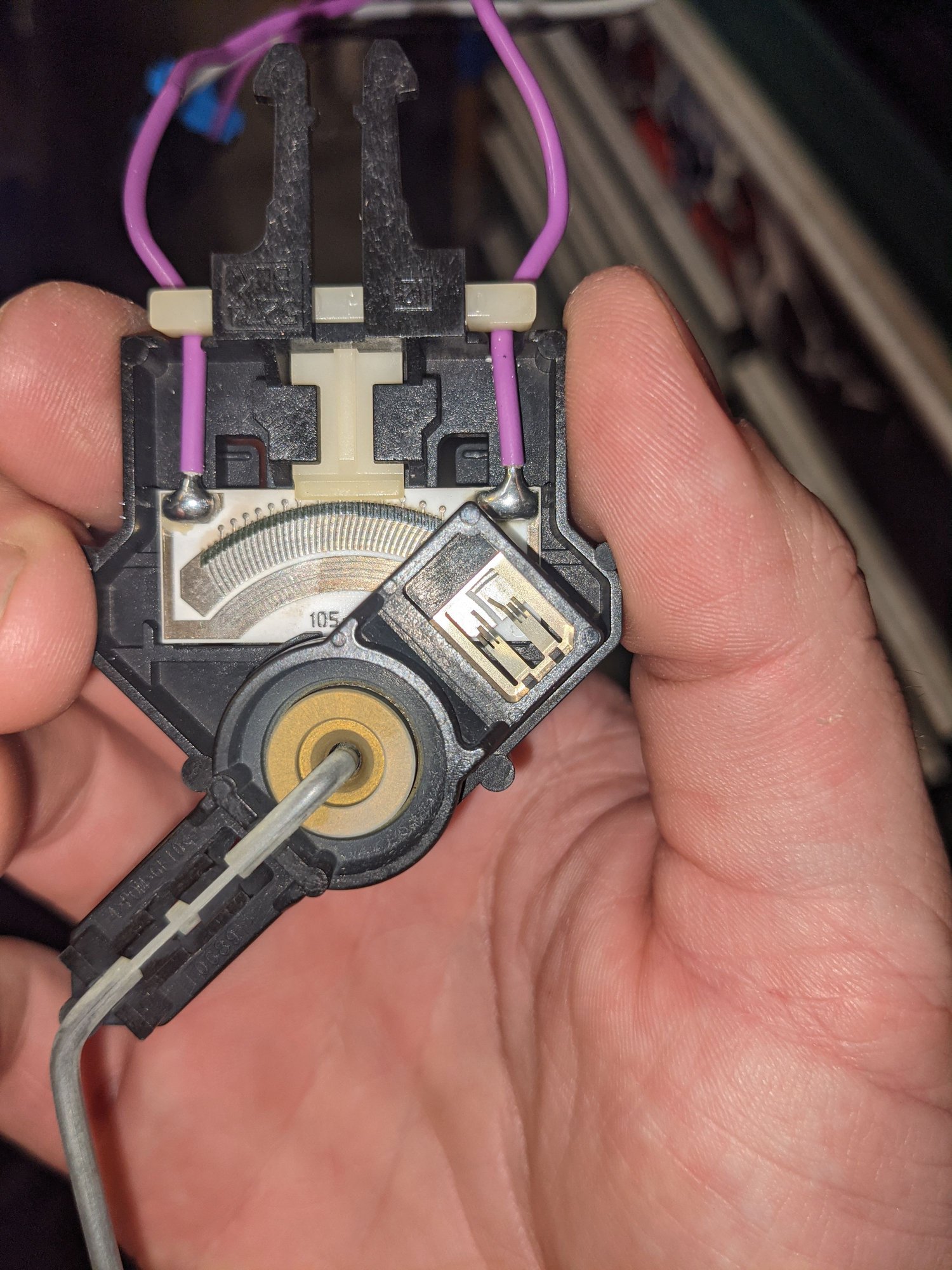

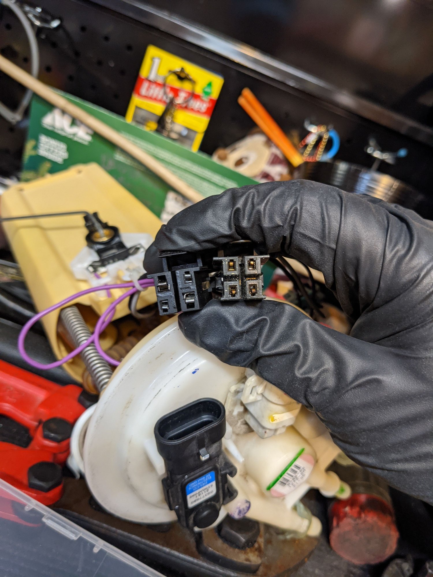

Got my Herko sender today and it's a little off.
So I moved the circuit board over, but messed up the fingers in the process.
Hoping to swap the Herko arm with fingers over to fix that. Also remembered I had an LM4 regulator on the shelf, so gutted that to reinstall and have the bucket function as it should. Intent is to reinstall fuel tank and pin the axle back in tomorrow or Saturday.

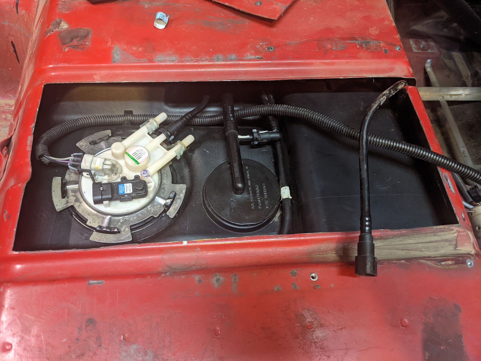

Changed my mind and decided to zip tie the Herko piece into place. The Herko connector wasn't compatible with the bucket so I pinned the circuit board over to the stock connector.
This was after I'd trimmed some stuff off the Herko connector.
All buttoned up and ready to go.
Gave the tank another wipe down. I was told to keep the can in place and the filling/venting would work out just fine so I did. The hose will be routed up by the filler neck and I'll put a vent cap on the end.
Gonna have to expand the trap door area, get a couple gallons in there, and fire it off and check fuel pressure before calling it good. The axle can go back in though, it anything's wrong only the bucket will come back out.

Strange. Like I said I didn't need to mess with the board but I did use two small bolts/screws to hold it in place.
It should fire right up though, mine did!

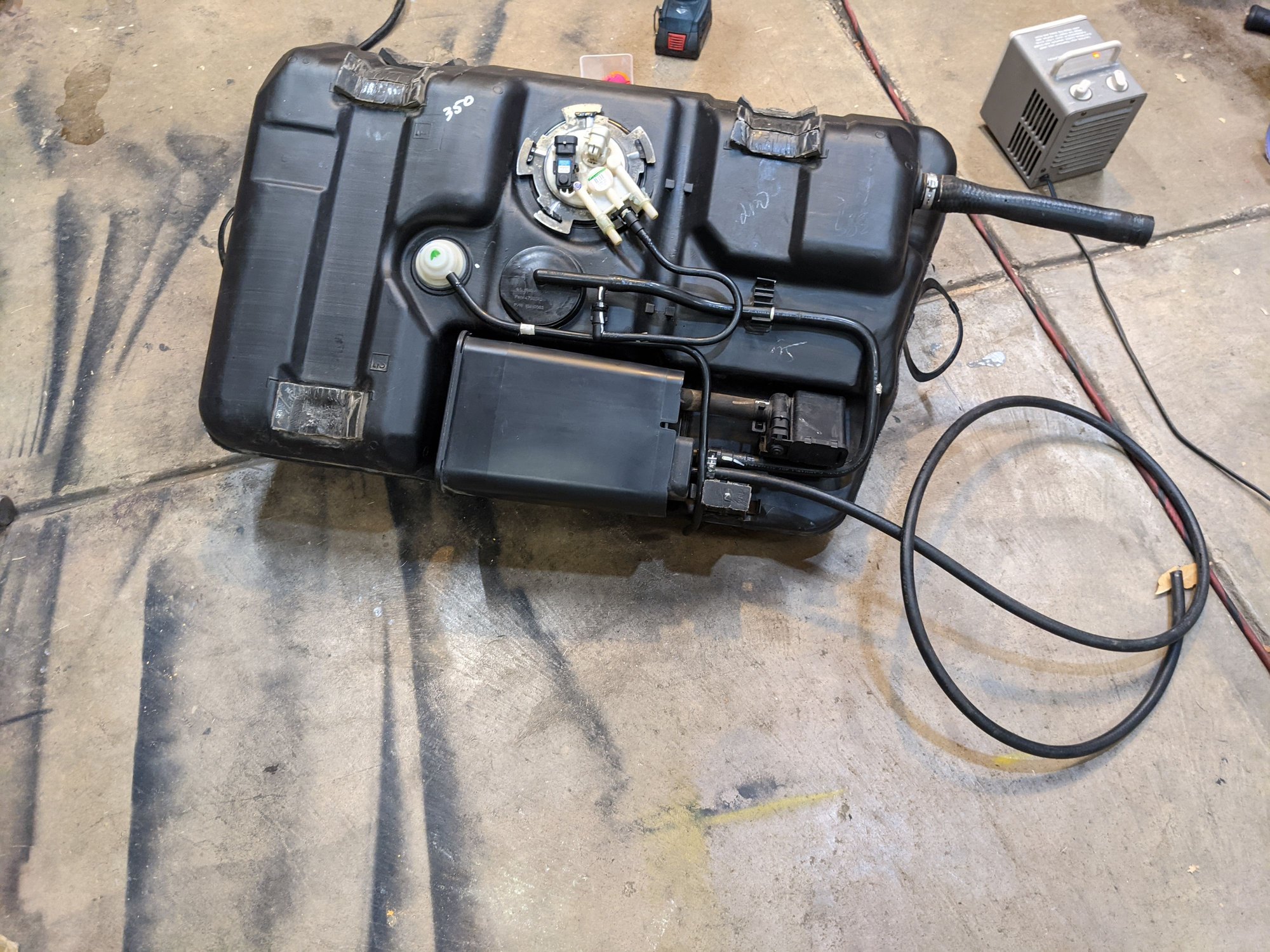

For anyone looking to plastic tank swap an LT, save yourself the asspain and start with a V6 tank! Not only do the lines not reach my V8 tank, but feed and return are both 3/8"!
This is after cranking on the hard line to gain the length needed for the stock plastic lines to play ball. Problem with the feed is that it puts the fuel filter in a vulnerable location. I'm no stranger to off roading this thing so I need all that hardware tucked up nice and high.

I'm pretty sure the V6 and V8 tanks are the same. The pump and sender are different, IIRC though. For me the plastic tank went in just fine.
Just keep in mind the 98 tank is metal and different than the 93-97 tank. The 99-02 tank is plastic.
All the plastic tanks have a metal filler neck connected by gas proof hose and clamps. Makes the tank way easier to get in and out than the 93-97 tank with the metal filler neck you have to twist and bend 5,000 times to get out, lol.

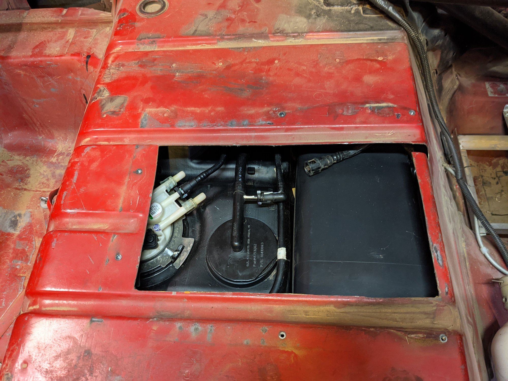

I did it with the LT tank which had its pump up front, then had to hack out even more for the LS tank which puts it out back. I'm debating how to reinforce this in the future, that's a lot of metal I took out.
