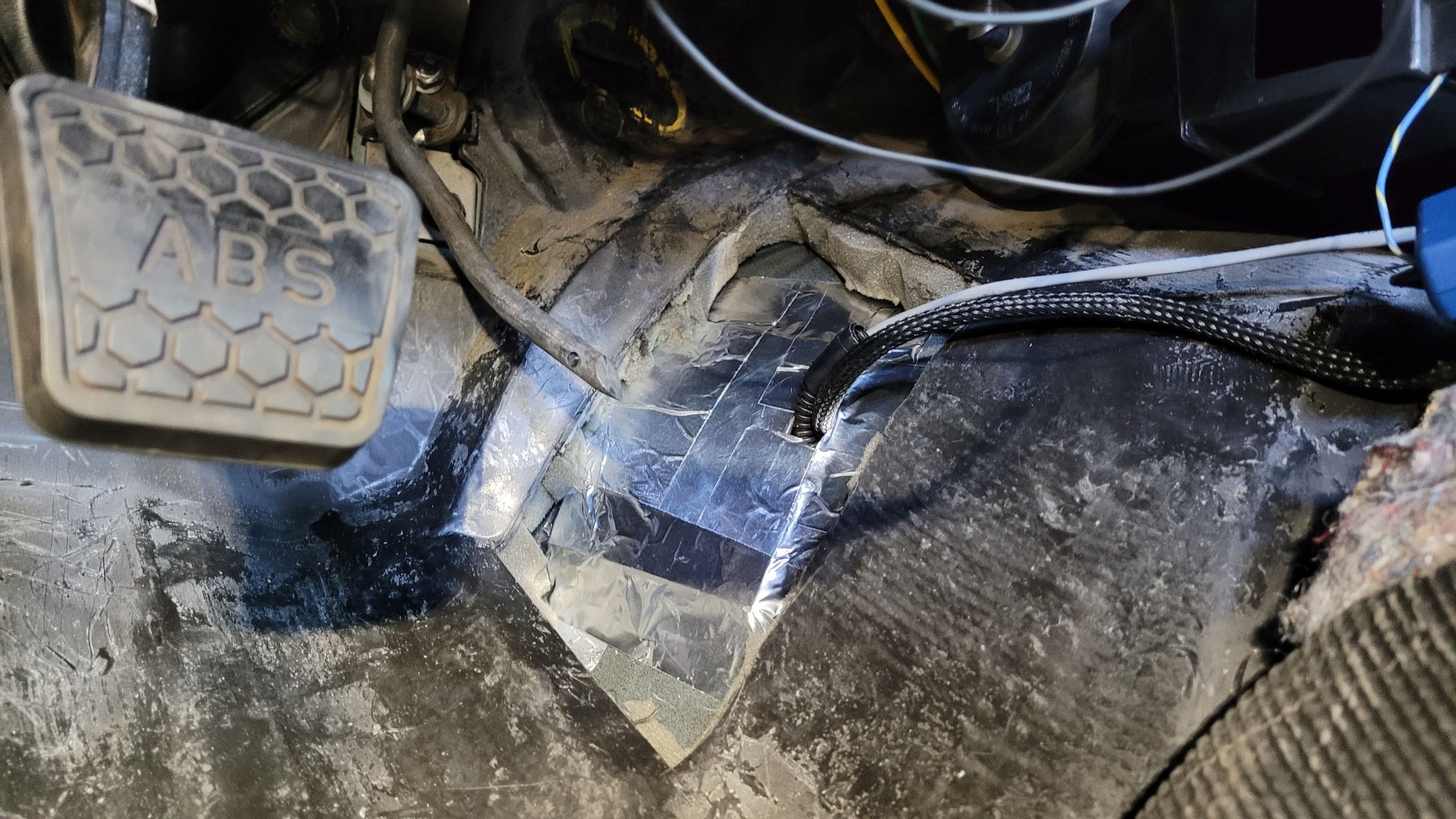

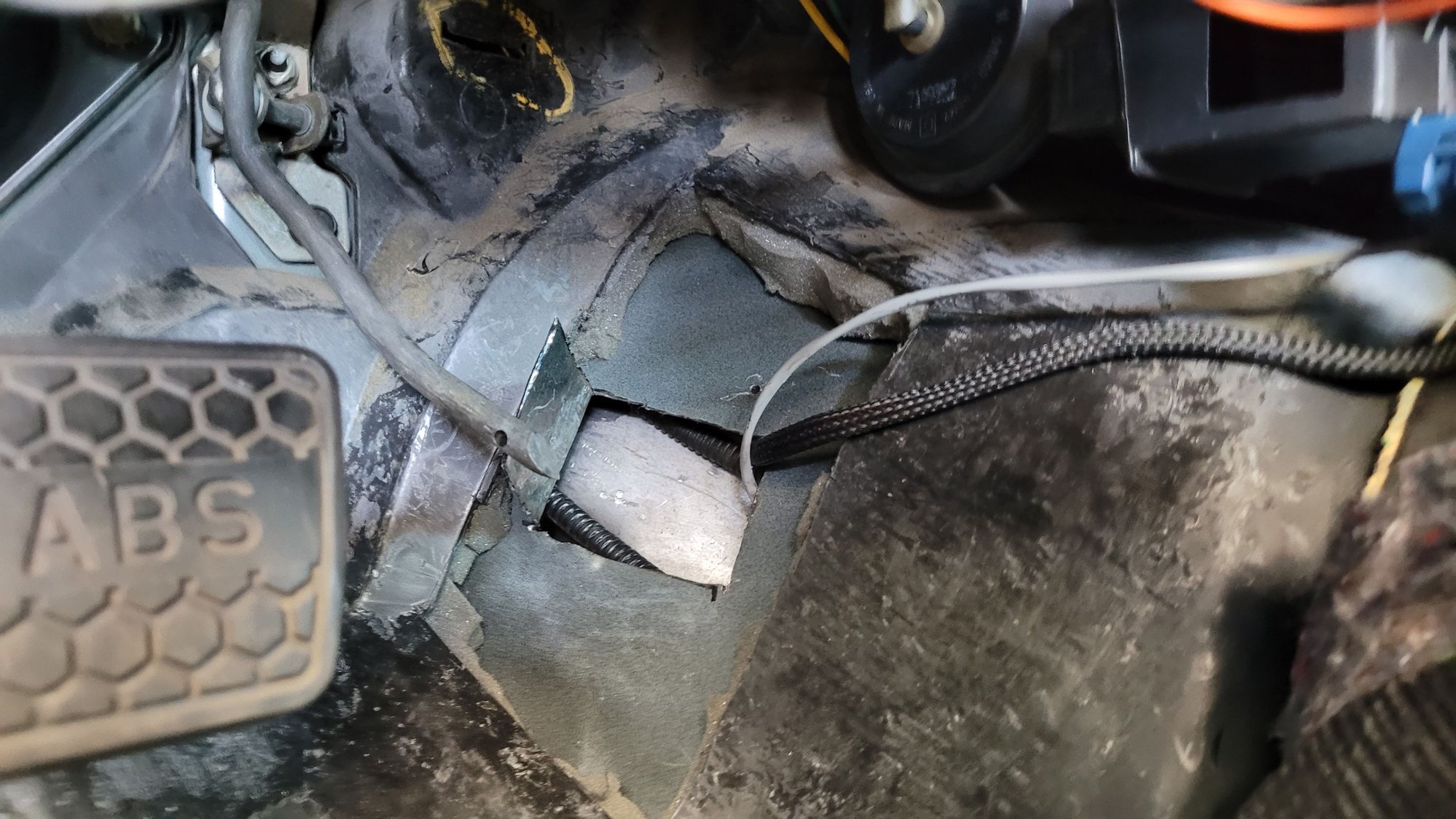

AND! I've added a dual purpose to the bolt access flap. I used to have the wideband and exhaust cutout wires routed under the rubber shifter boot into the center console. While convenient, that boot pinched the wires to the point I wasn't comfortable with it so now the wires are routed through the access flap. I'll post a picture of the finished product later.

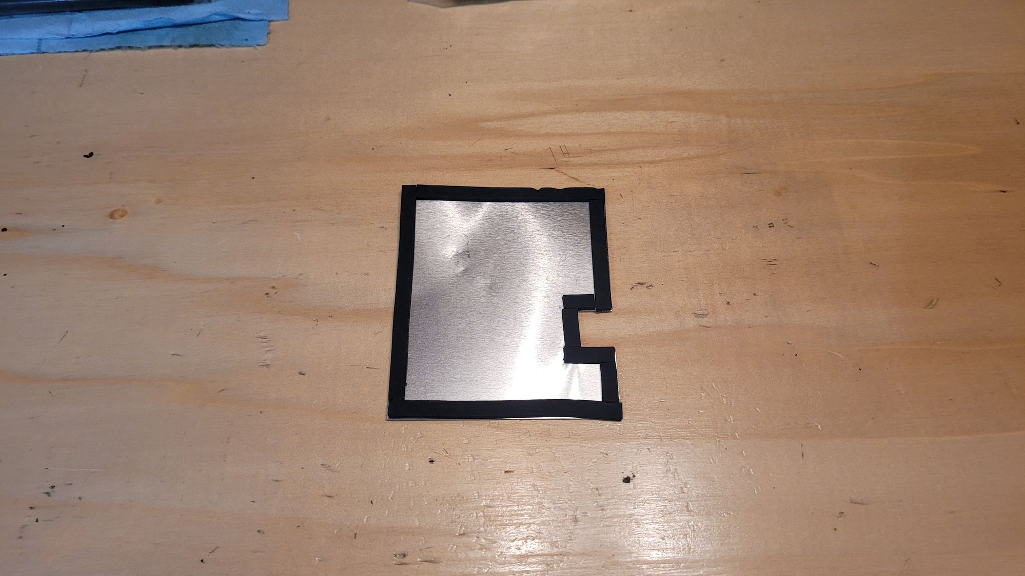

Good show. The hard shifting into reverse could have been due to the clutch dragging on the flywheel even with the pedal depressed. I'd put some paint on that cutout to keep it from rusting.

Thanks for heads up about the rust. Here's how the patch turned out.
EDIT: holy crap it took me 30 minutes to figure out how to put the gas pedal back on. For anyone else that finds this, take the whole assembly off and attach the gas pedal with the assembly out of the car then put the whole thing back in.
