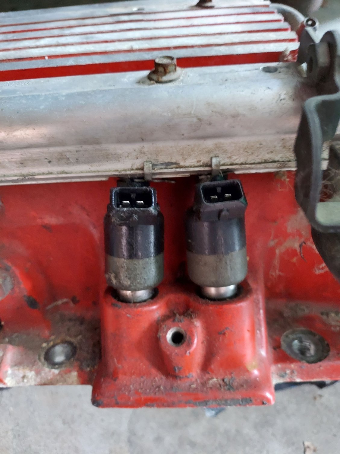

I have a walboro 255 fuel pump, and can easily and often replace the fuel filter. So now this is my next question are these injectors 30# svo? And if so will they suffice.
30# svo?
30# svo?
You need 30-35% more injector for E85 than you would need for the same setup on gas.
30# svo?
Those look like the stock LT1 24# injectors to me

From: Cuyahoga falls ohio
They say H-30 on the front of them.

Pull one of them and look at the shoulder opposite the connector. Should be a batch number, i.e. A 0273, then the part number. If that 8-digit number is 17095004, they're 24#. If something else, look it up. One side of the inlet neck at the connector will have the Rochester RP logo, other side may say something like W 53 or H 30, but that's not the flow rate at 43.5psi...
