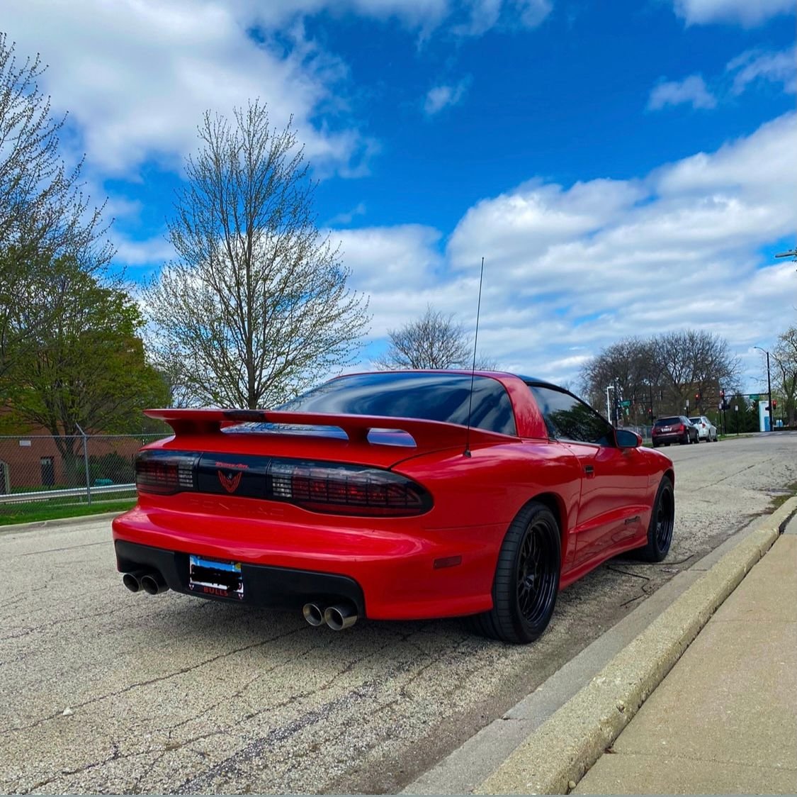

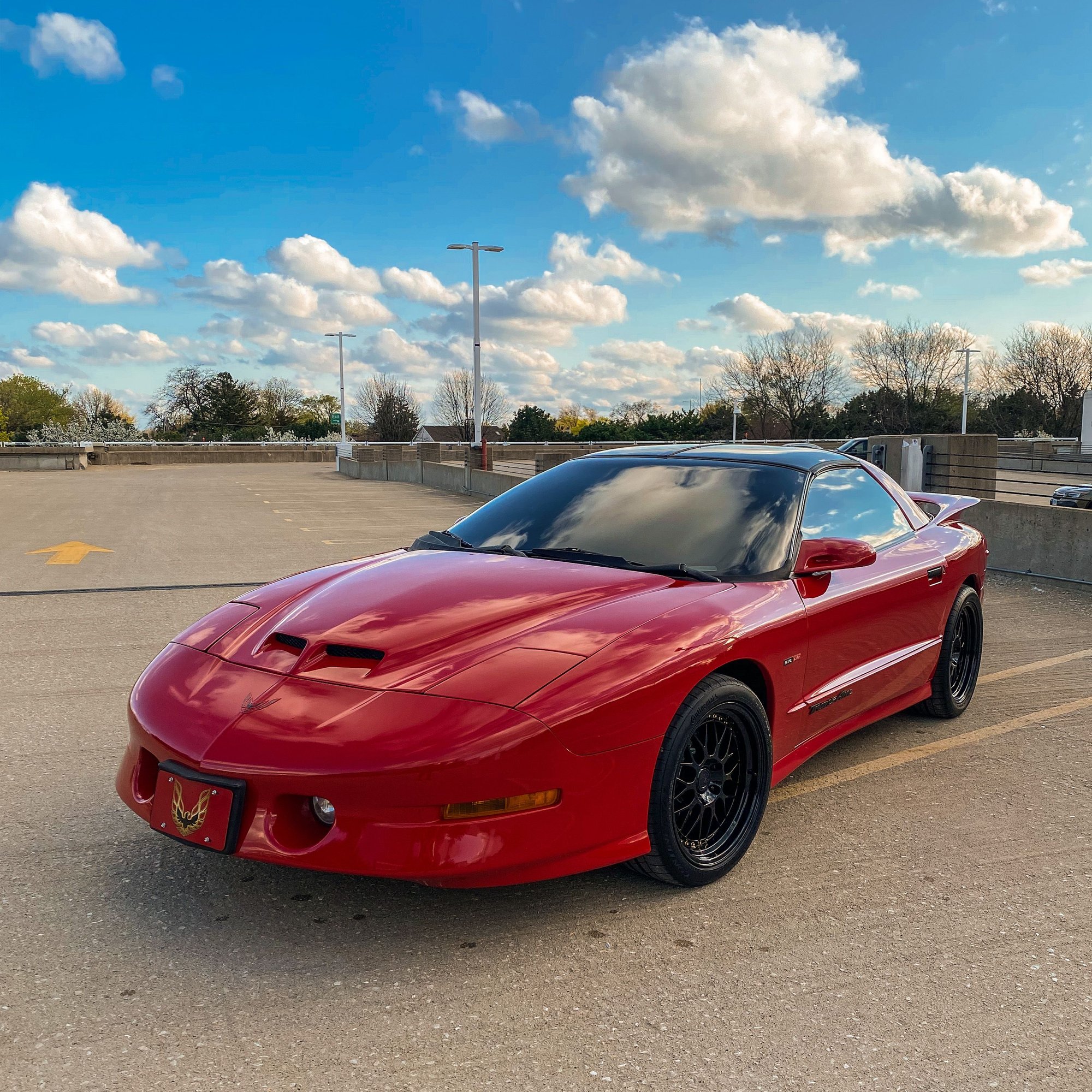

I really want to make this car a bit faster but most importantly I want it to sound more aggressive. I just don’t know who to go to in my area that knows these cars.
94 Firebird transam V8, 64k miles. Stock aside from Magnaflow CBE, Strano’s rear and front sway bars and a petris optispark.

Beautiful car! I too feel your pain on the lack of tuning options available for the LT1. That's why I'm seriously considering a 24X conversion. Superior driveability, tuneability, and power. Coil on plug is the real deal.
