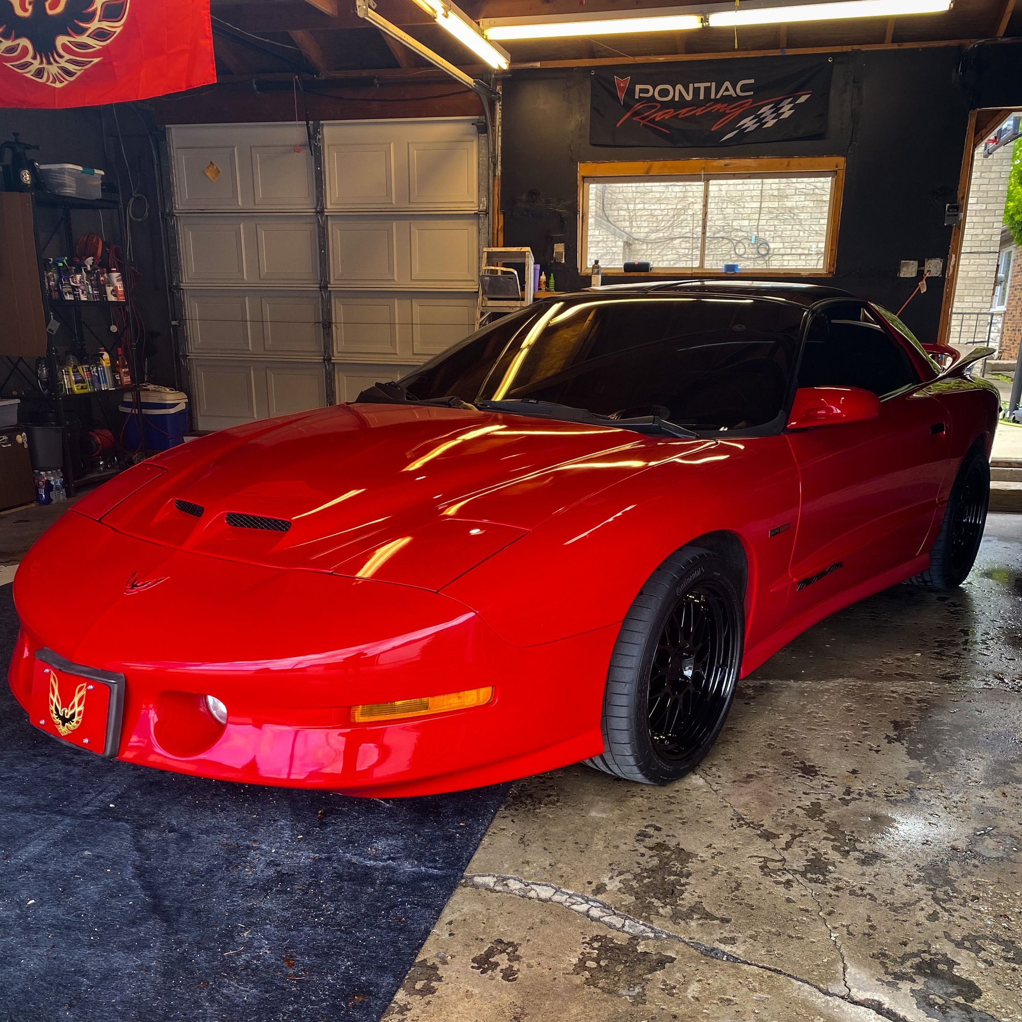

Hey y’all ! I’m not very versed on all this but I’m learning. I’ve read a ton threads but still a bit confused.
I have a 94 Firebird with stranos sway bars, 18x9.5 wheels on 275/35r18 and 295/35r18s and a magnaflow Catback exhaust. I will be purchasing some koni orange shocks with Strano springs very soon (hope I don’t scrape).
Next I will get some Pacesetter coated longtube headers, what else do I need when doing that ? Do I need to pair that with an off-road y pipe or something else ? Or longtube headers with the magnaflow catback I already have is all I need ?
I will do a cam next year. Want this beast to be a bit louder. Basically what are my options ?
