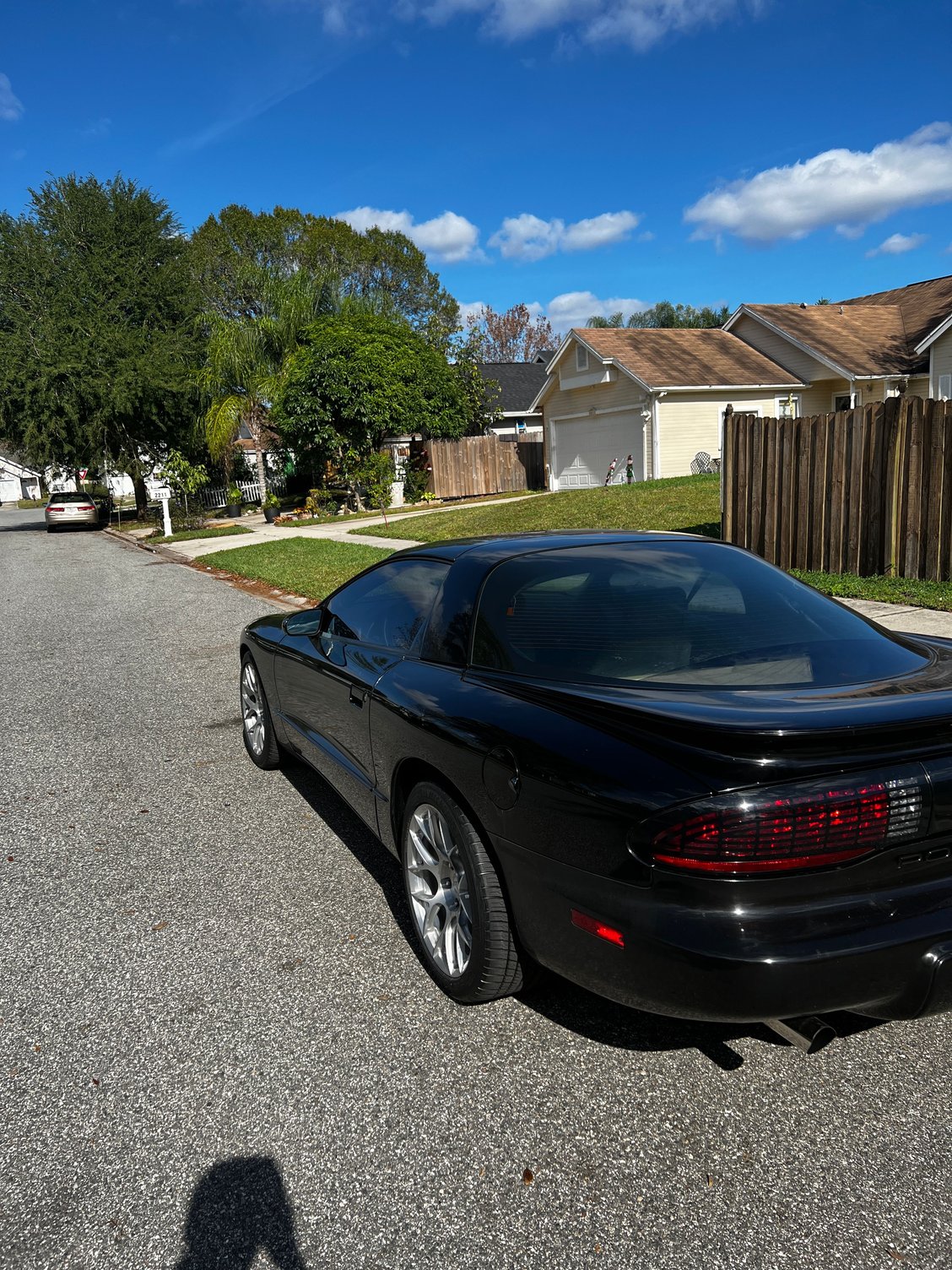

figured I'd give you guys an update since I've made some progress.

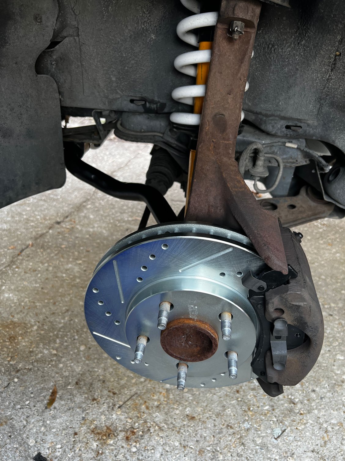

-My Dad's friend gave us a set of slotted and drilled front rotors, new stock clutch, slave cylinder, and throw out bearing. Legitimately it was a miracle that he had lying around from his old T-56.
- Installed Strano Swaybars front and rear and holy smokes... what a massive difference when running them with Strano springs and Koni shocks!
- BC Forged wheels are on with Michelin pilot all season, I also graphene coated the wheel face with Adam's polishes advanced coating.
(used a scale at home and wheels are 19.8lbs each!)
- Now running drilled and slotted rotors all around (nothing fancy but a nice refresh after 28 years)

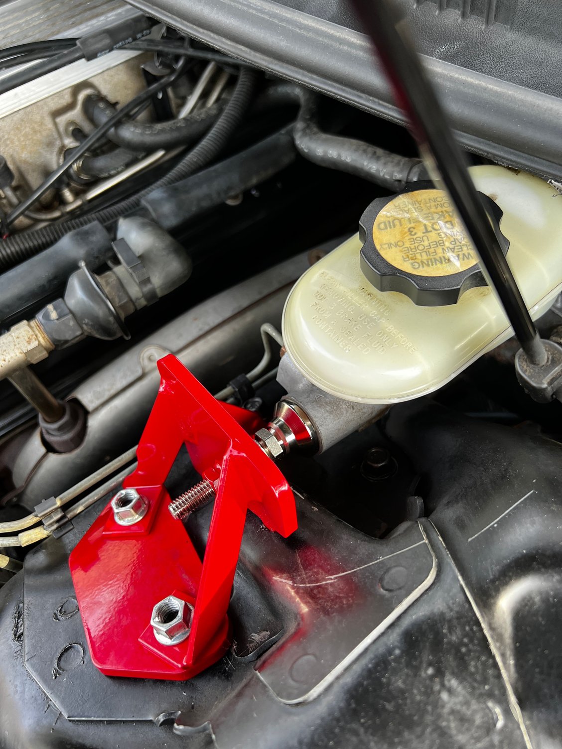

- Strano Master Cylinder Brace installed, I chose to grind down the spacer a bit to get it more level. Also replaced the shock mount bolts to be longer for an easier install of the master cylinder brace. The new bolts are not pictured, picked them up from ace hardware with a set of lock nuts as well, went with grade 8.
