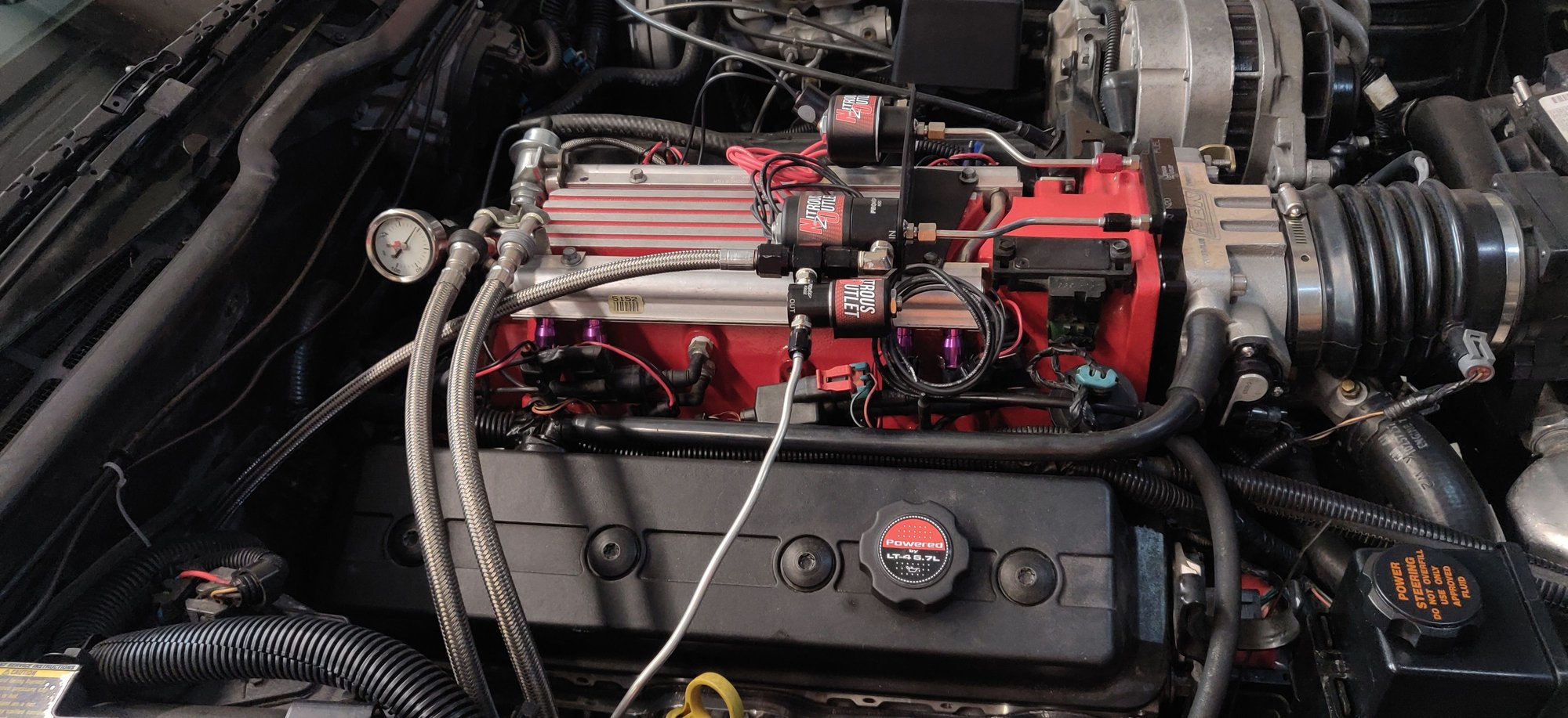

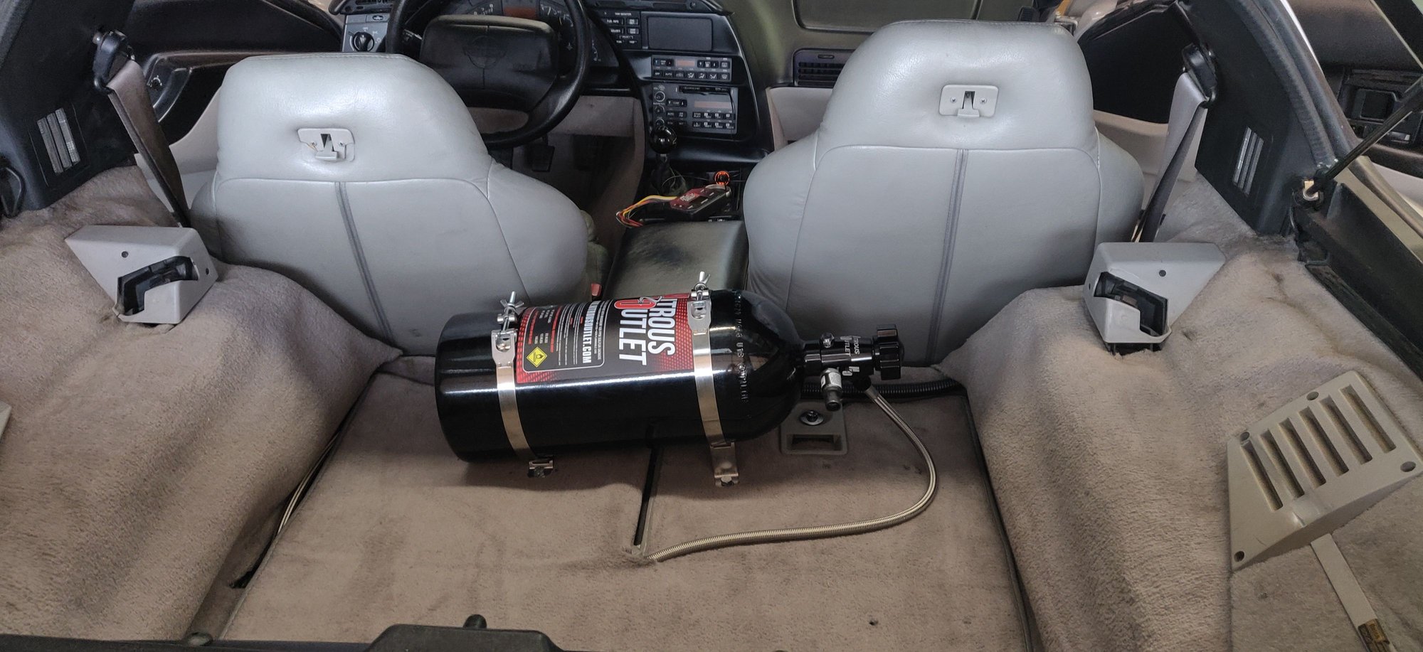

So the engine is done and broken in and just finished up installing the nitrous kit and working on wiring. The question is what can she handle?
Here are the engine specs
11.5:1 CR
383 stroker with 6 inch rod Mahle Pistons
Scat crank
Scat ibeam rods 7/16 bolts
AFR 195 comp heads
Running 100 octane using Torco
Running nitrous outlet wet kit
