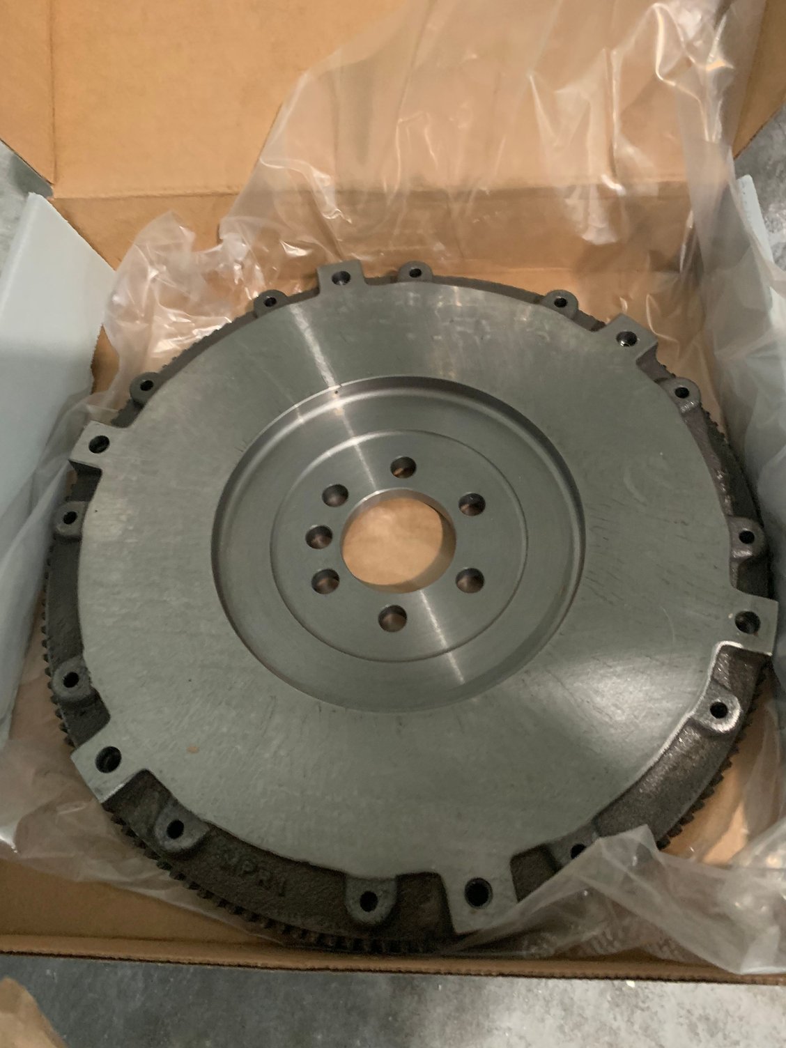

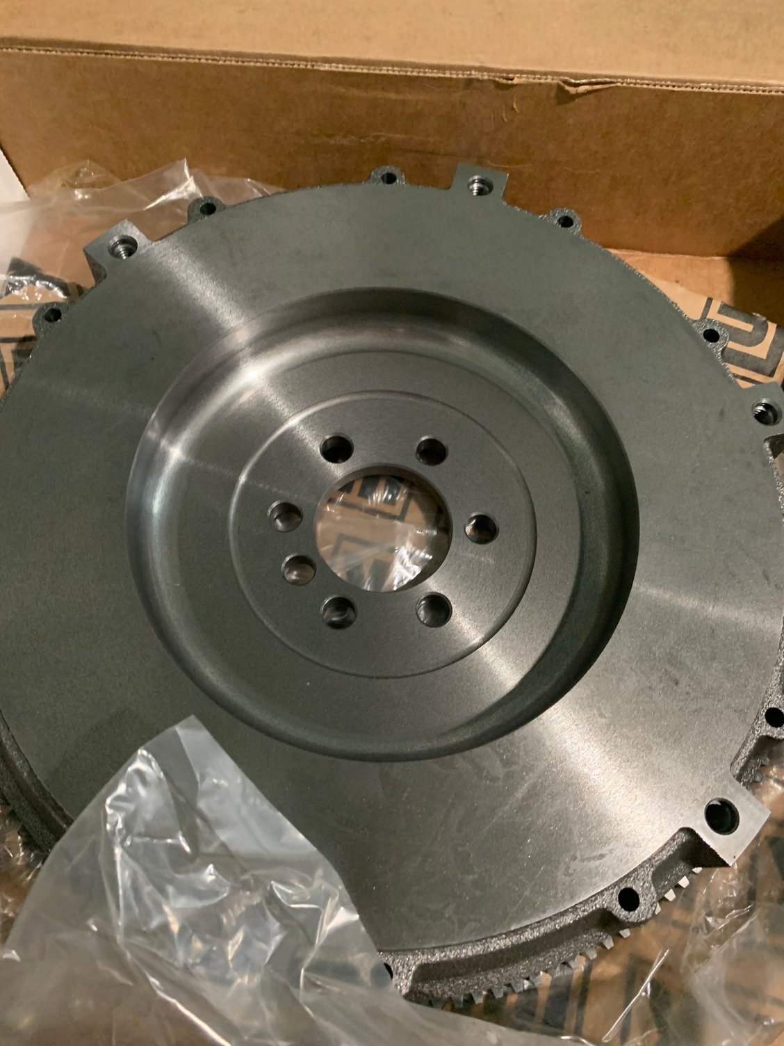

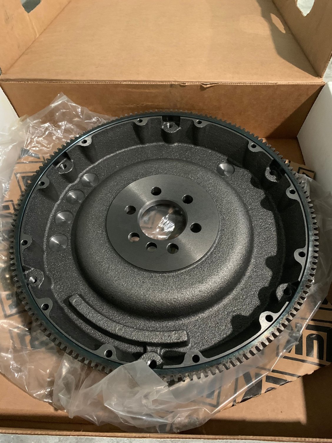

Ok I made a small mistake and didnt realize Lt1 came with a 153 tooth flywheel. So i ordered both. Now the question I have is the Lt1 flywheel is dished much deeper than the SBC flywheel. Like an inch or more. The engine side is the same but the clutch side sticks out more. Is this cause of the T56? I am going to be using a T10. My thought was to go with the LT1 specific but i was thinking there was a difference on the engine side which there is not. Does anybody know?

89-96 Corvette and 93-97 F-Body used a pull style clutch, T10 a push style, so the T56 style clutch pulls the clutch fingers away from the flywheel, whose surface would need to be further from the crank than it would be on a T10 push style. Make sense? In your case, you'd want to treat the back end of your LT1 as if it were a traditional 1-piece rear main SBC. Clutch/ flywheel/ trans all go together. Whatever clutch and flywheel combo would go behind a 1-piece RMS SBC with your T10 is what you need.
EDIT: be mindful of the flywheel balance setup. LT1s are internal balance front (harmonic damper, not balancer) and external rear (needs weight on flywheel or flexplate). make sure you get a SBC flywheel with the same weight tab you see on the deep LT1 plate in your pics.

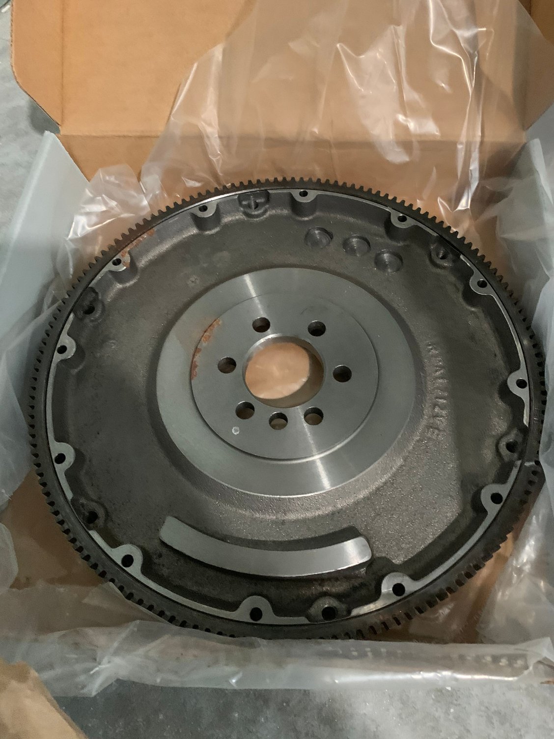

Ok --- I have the Gen I 1 pc rms flywheel on hand (in pics) the weight looks the same as the Gen II, so am I good to go in that respect?
The clutch is for a 63 vette. My logic was to use same clutch as what the trans came out of (because of spline count - it is a coarse spline trans) I was not aware of push/pull clutches. Will it work?

Your logic is sound if the input shaft works in the LT1 crank. You might try test fitting the trans and engine together without the clutch and flywheel just to see where you are on input shaft depth in the crank. A pilot bushing for a trans in the 2-piece RMS era probably won't be a fit but if you measure the ID of the crank and OD of the input shaft you might find one made for older trans/ newer SBC applications. If the input shaft doesn't bottom out or hang in space behind the crank you're most of the way there.
