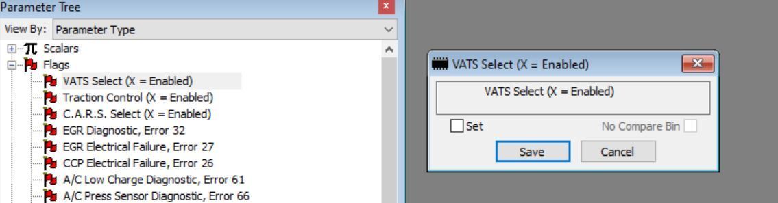

I’m finally getting back to this issue after taking a break from it. My car is my daily and somehow managed to put off problems while still driving it and luckily haven’t lost a job due to the car but does Anyone have any knowledge on disabling VATS on a 94 Z28 using tuner pro RT? I already have a moates aldl cable and know how to use it. Just do not know how to use tuner pro rt to disable vats. I keep getting intermittent starting.

It will be found in the Flags section. You will need to unselect the box. The question is what are you going to use to Flash it after you made this change?

You will need to get flash hack to pull the .bin file from you current ecu. You will also need a .xdf file to translate the ecu information into information you can read. After you have made the changes to your "tune." Save it in tunerpro, then load the new tune to your ecu with flash hack. gearhead efi has all the files you will need.
