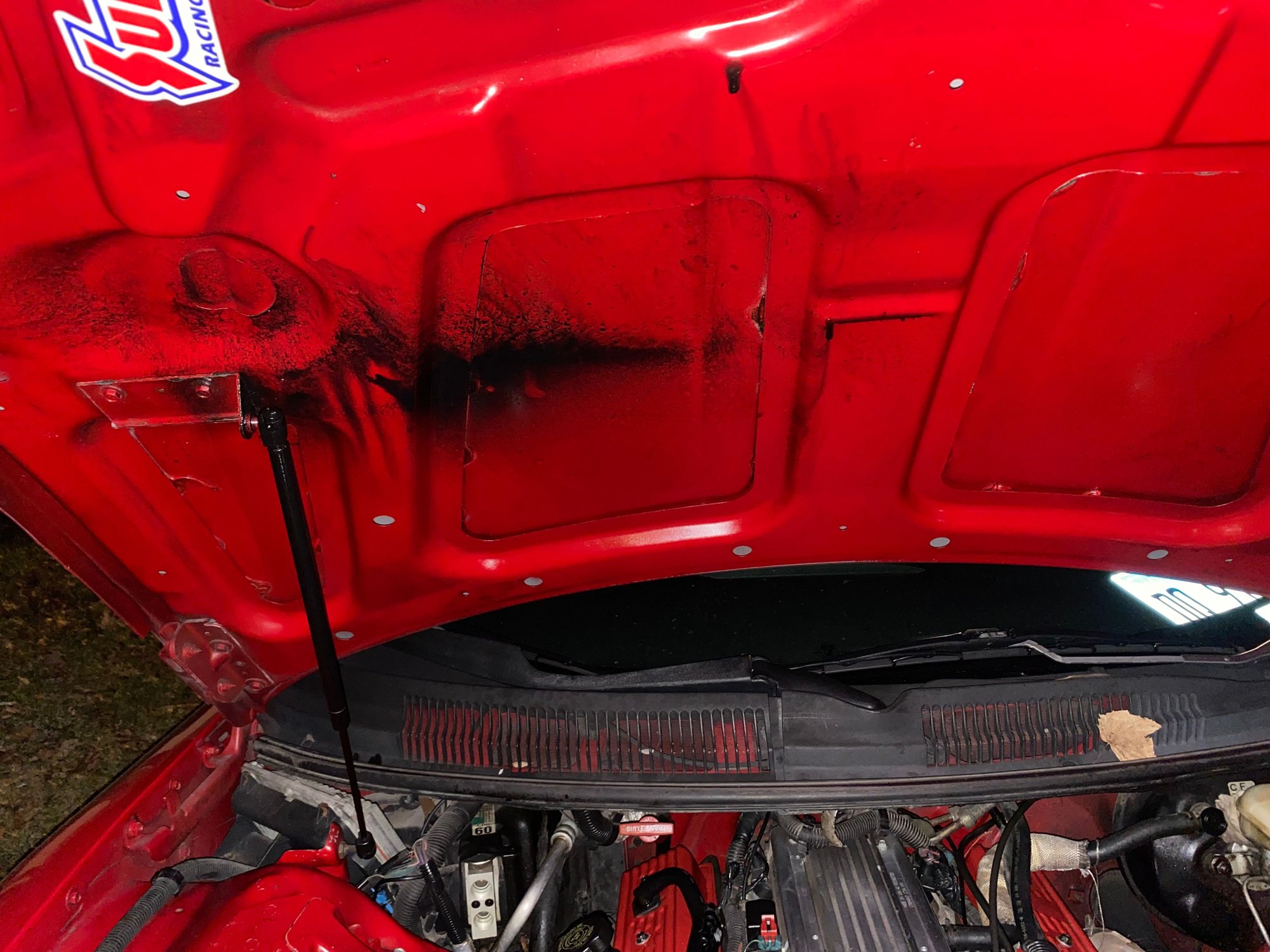

Hi guys, I’ve been trying to find out why my car kind of “explodes” oil under the hood when I step on it. It usually only happens at high RPM’s. I changed the main seal gaskets, and valve cover gaskets too see if that would solved the problem but it keeps doing the same thing… any ideas on what it could be? Thanks.!

I 2nd the dye check. Clean it all up real nice. Add the dye, take it for a quick hard drive. You'll find the sources and more guaranteed.
You didn't mention where you suspect the leak is. Is the black on the hood oil spray? The dispstick is a common source and will spray everywhere underneath from the engine back. The front timing seals are notorious fo leaks ( WP, crank, opti, and CPS). Power steering is also a leak monster and will go everywhere from wind. Leaks suck.

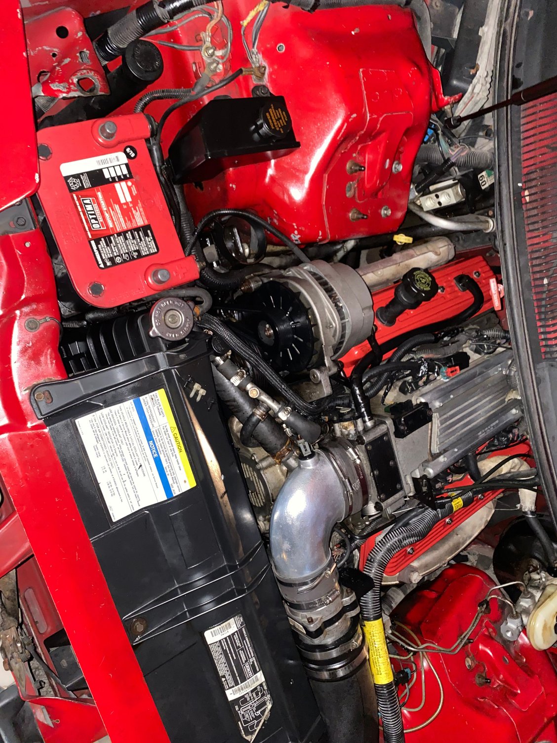

It’s leaking between the alternator and the TB, usually the alternator is oily when that happens as you can see in the picture… it’s kind of weird but that’s where I think the leak is.. also I tried to smell the oil and it doesn’t really have a strong smell like the engine oil or transmission oil does.. plus it feels thicker and looks darker since I just changed the engine oil. Also the power steering container is cover in that oil.. basically most of the front left part of the engine bay gets all soak in oil. Idk if that makes sense 😅 thanks for your help.!

Whatever it is, it is being carried by the accy belt or causing the belt to deteriorate. That is probably why it is in the location it is and why so black.
