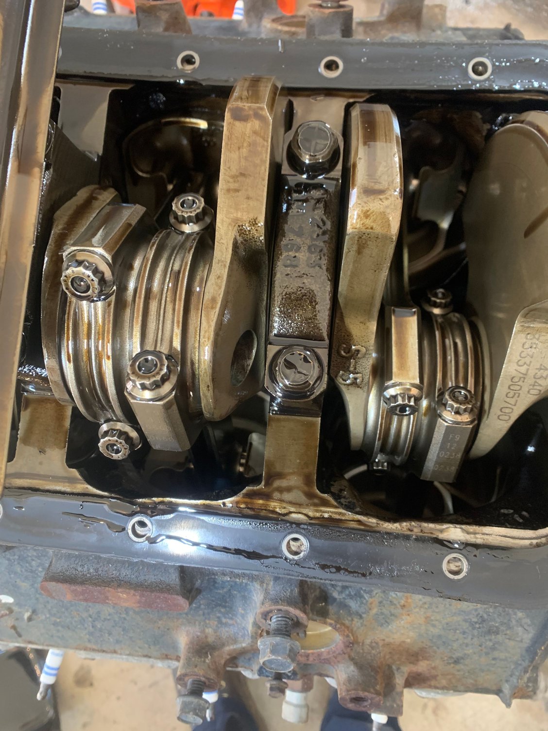

Picked up this motor off a guy that didn’t kno much about it. From what I found it’s a 383 lt1. All I kno about it. Trying to find out some info on it. I’ll post pics with part #

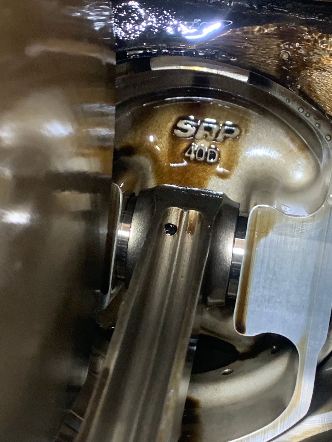

Eagle 3.750 crank and H- beam rods. You should be able to measure the length as is, 5.7" or 6". Pull a spark plug and look at the piston to see if a flat top or dished. Take it a part and inspect for sure. Could have ported heads and cam also.

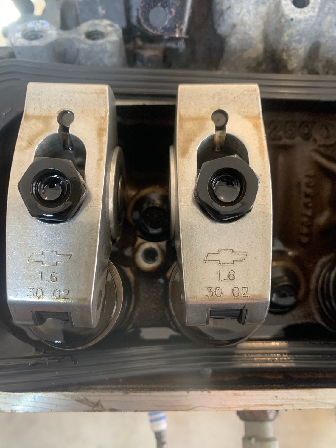

He has GMPP rockers. These came with the LT4 Hot Cam kit.....so a Hot Cam is VERY likely.

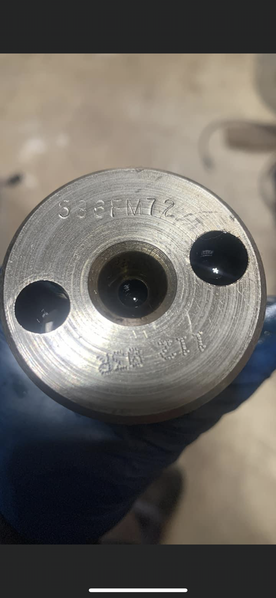

This is all I can find for numbers on the cam
