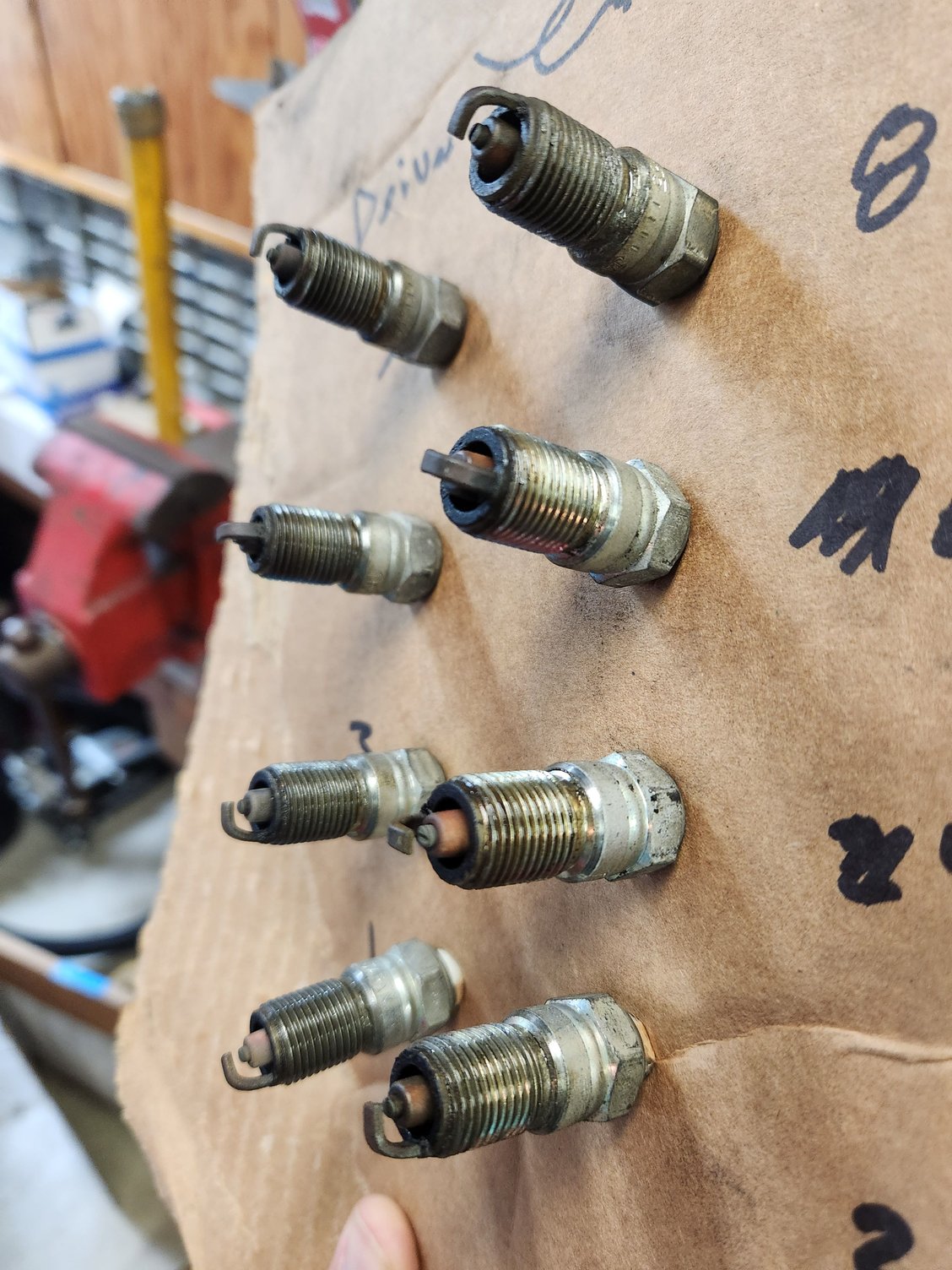

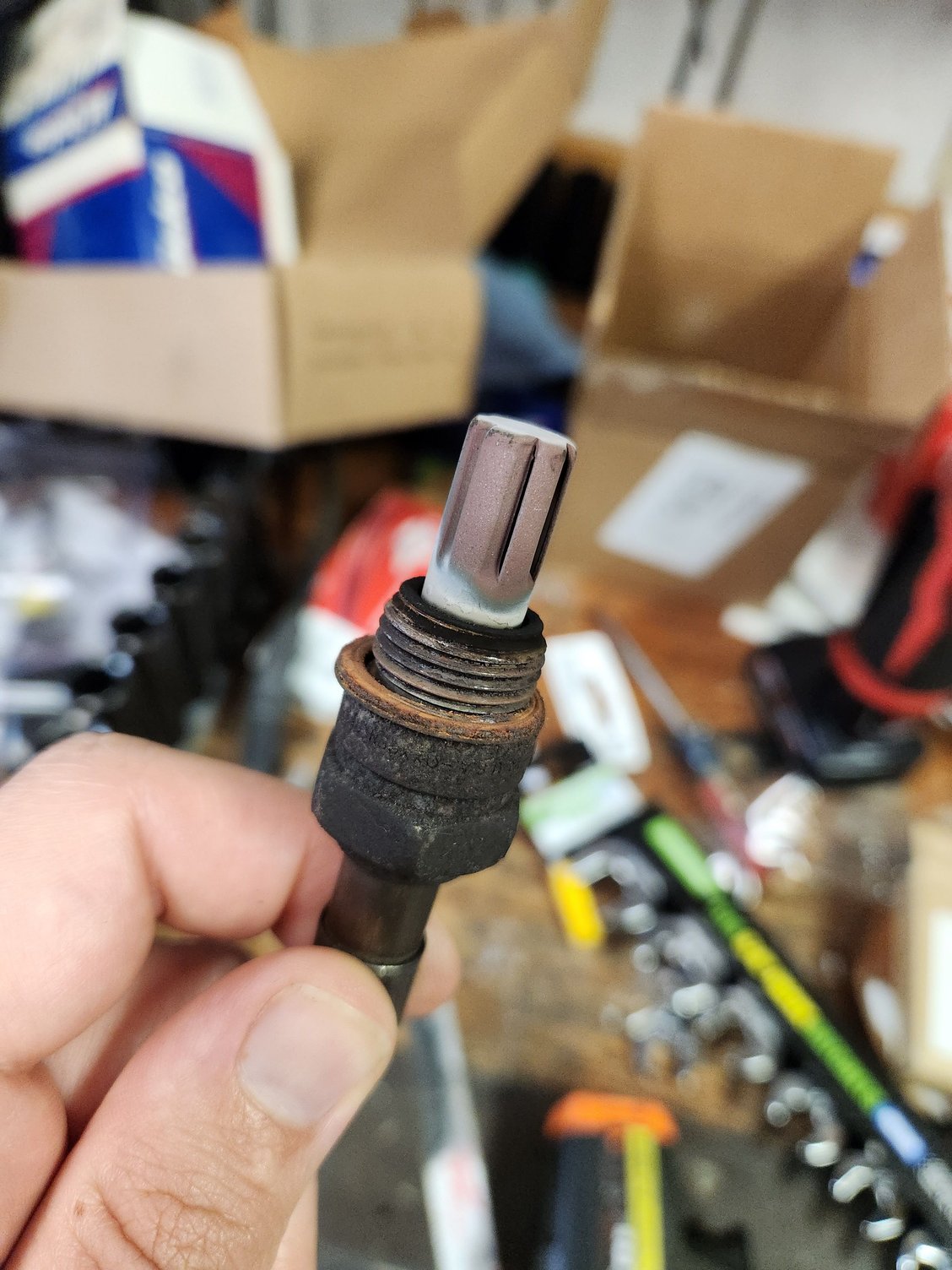

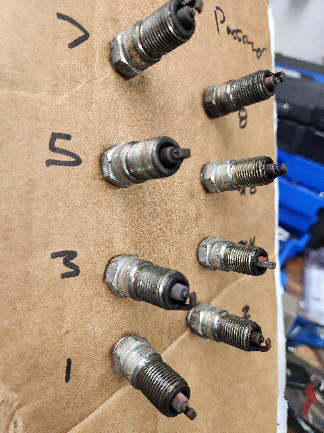

I just finished replacing both 02 sensors and all 8 spark plugs. I put on NGK TR55 v-powers (those are what it had too), I gapped them to the factory 0.050. That was a learning experience. Mine didnt look pretty. The 02's had odd coloration as well. The passenger 02 had a brownish coloration. Much more so than the last picture above (that was the drivers side).
All the plugs smelled like gas, but that was maybe because I havn't been running it much. Just a short drive testing EGR and letting it run in the garage a few minutes to check sensors the last few times.

My 93 uses single wire 02's. What I put on were AC Delco AFS21.

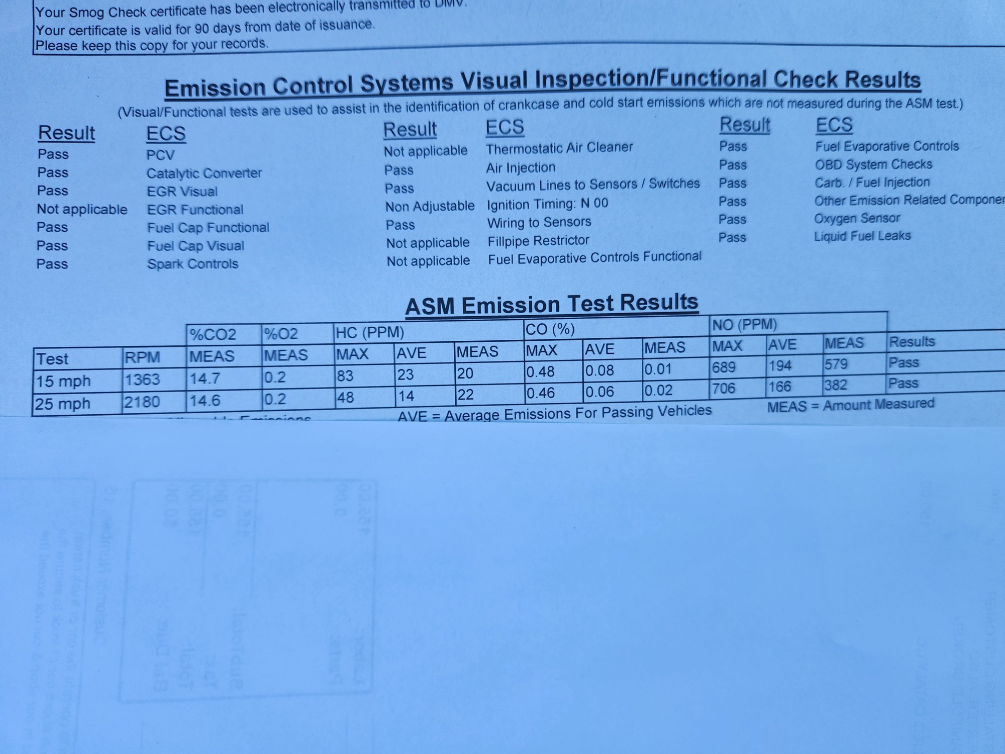

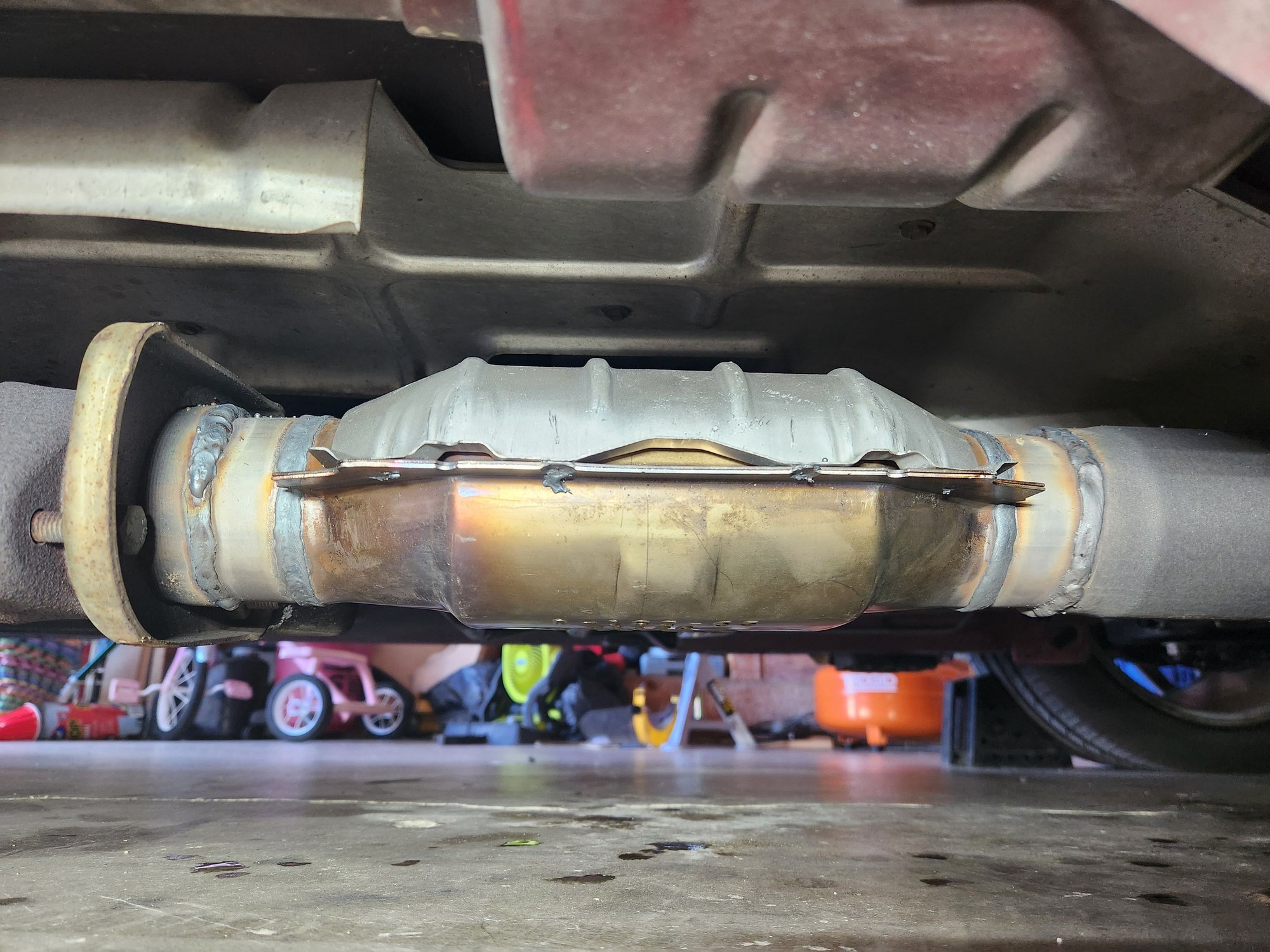

Update. As mentioned in the last post I replaced the spark plugs and 02's and fuel filter. After that I sat on it awhile debating pulling the intake to clean it. I went to an exhaust shop to check for leaks and they found nothing major but noticed a missing bolt or stud, not sure on the passenger manifold to block. They told me it was not one they could easily do themselves so we passed on that. But at least I know. They told me I should really do the cat. They quoted me a Walker 81128 (D-182-65) for about 500. I already knew of this one as I think I posted earlier. I got it off Amazon and had it installed today and the damn thing passed!

CATS typically save the day
regarding the missing, or broken, exhaust manifold bolt. That is the "source" of your initial fail. Your car will continue to have 02 since more air on that bank so PCM will command more fuel....which in turn will kill the CAT
You need to fix that.

Bump for fun. I had to smog it again and remembered this thread. Passed without issue. Nox 15mph was 588 and Nox 25mph was 370. More or less identical to last time. If anyone is in a similar situation as me and your cat is suspect, just replace it..
