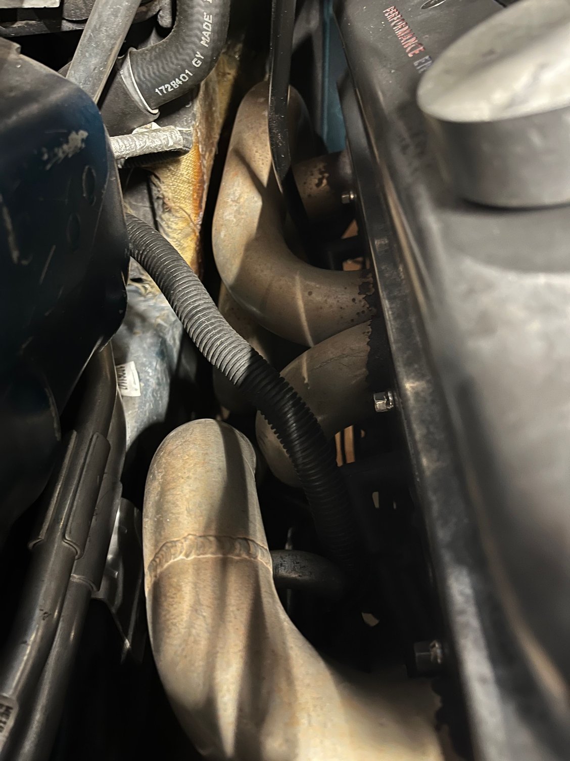

Where are we routing our passengers side wiring harness? Mine it hitting the passengers side headers. 94 camaro z28

I think I know which one you’re talking about. What I did was disconnect everything it was tied to. I think it’s an O2 sensor, knock sensor, maybe the PCM ground? Then route it between primaries 3 and 5. I still have A/C and there is a line off the compressor I ziptie mine to.

Good choice. I went where the dipstick ran in that same spot and tied it to the dipstick itself. The wheel speed/abs I left alone. Didn’t feel it was important enough to move around.
I did the same, however after several years it did finally crispy the wire. IDGAF because I haven't ran ABS since 2000.
