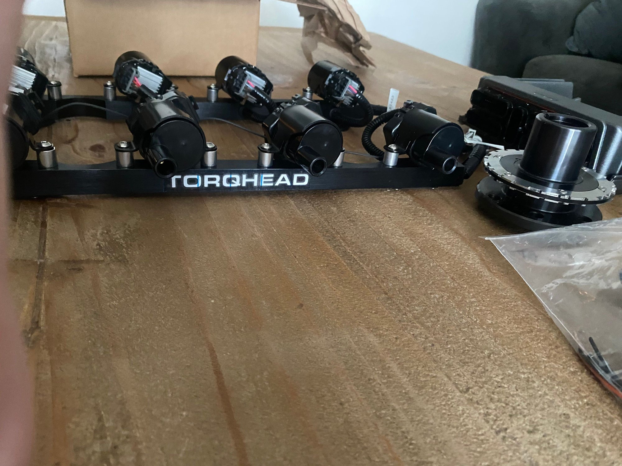

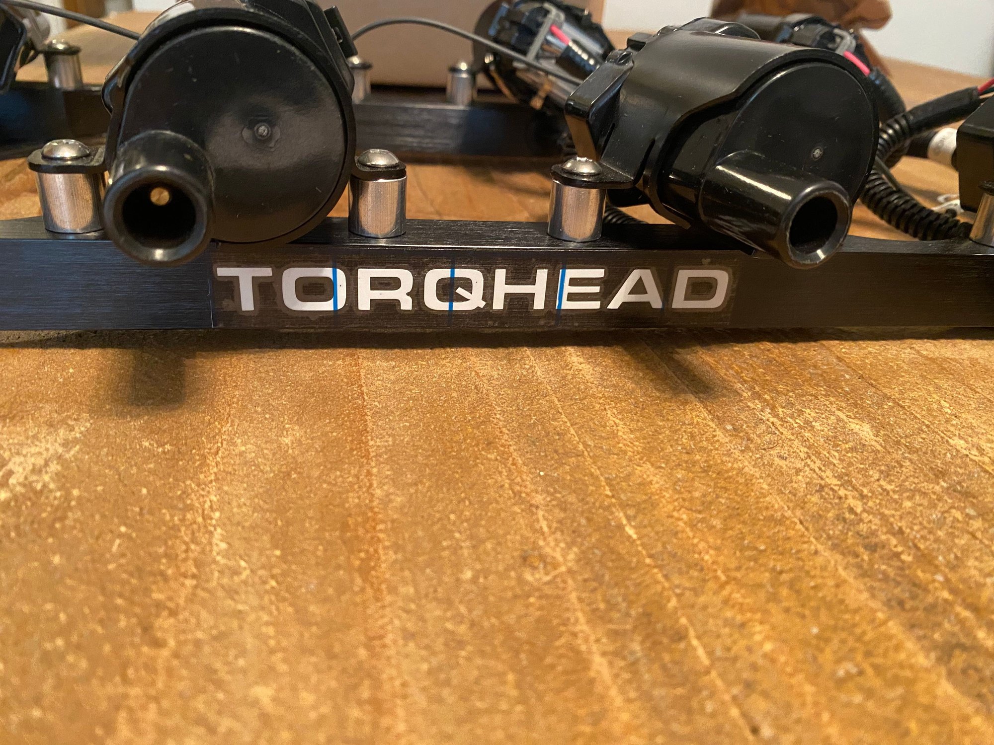

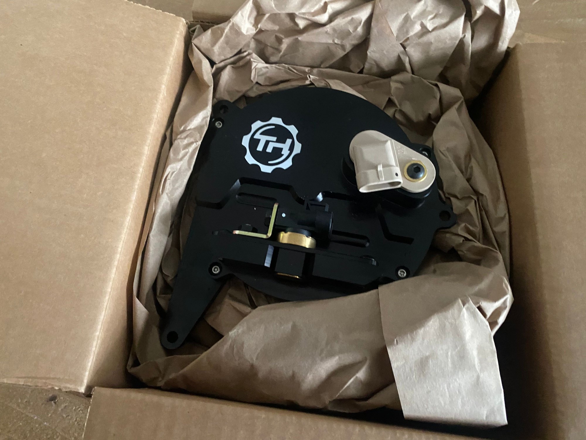

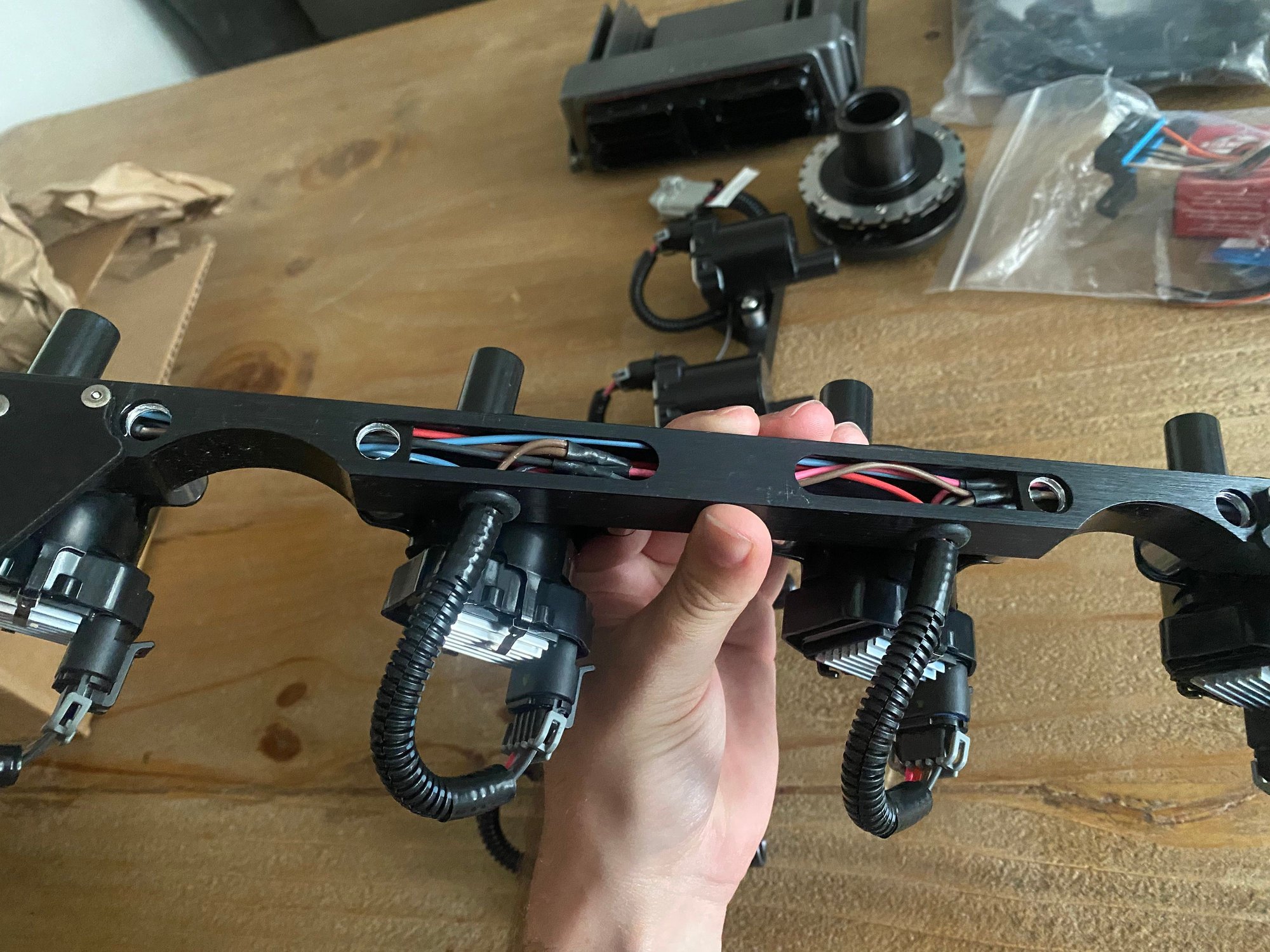

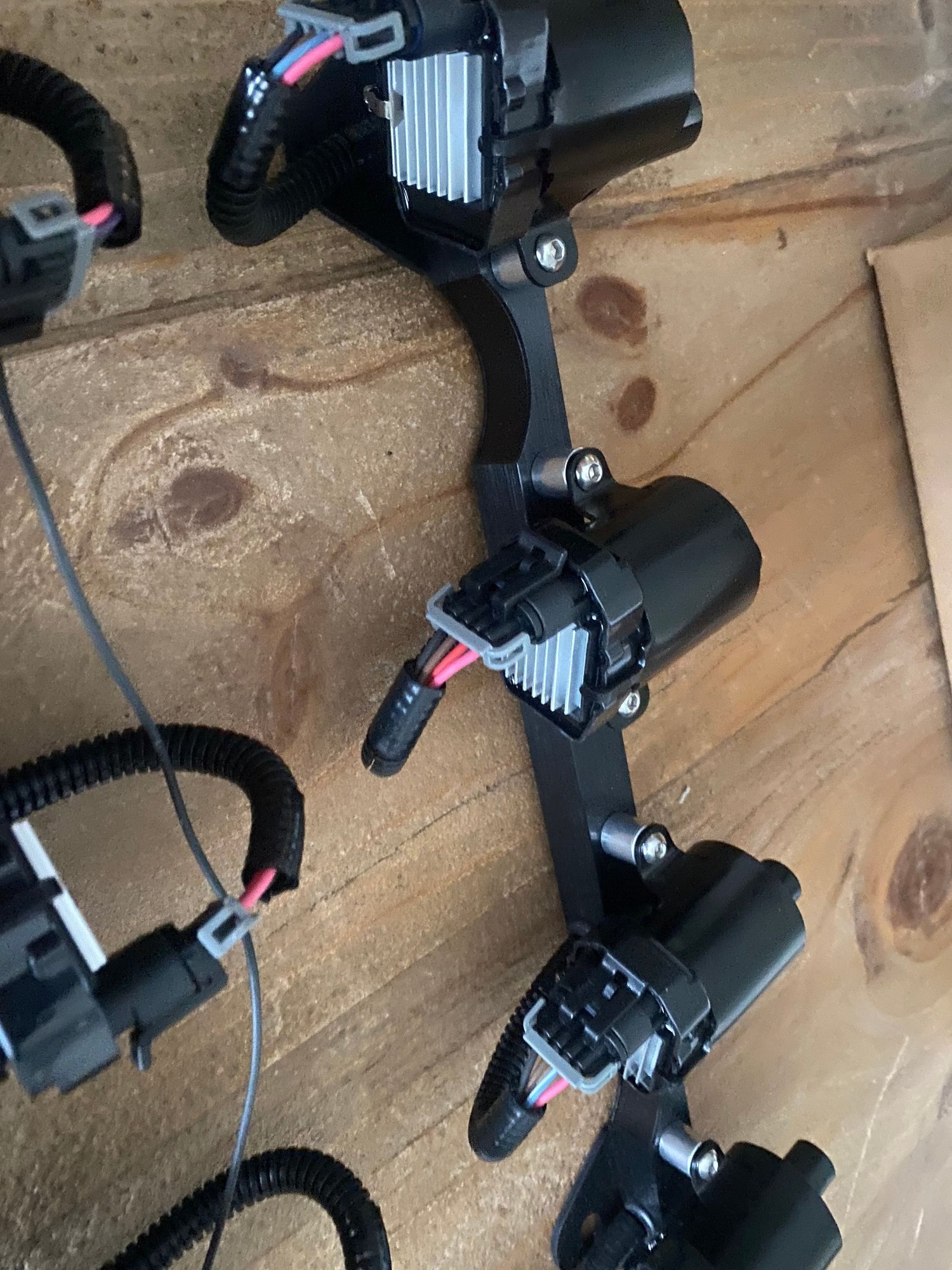

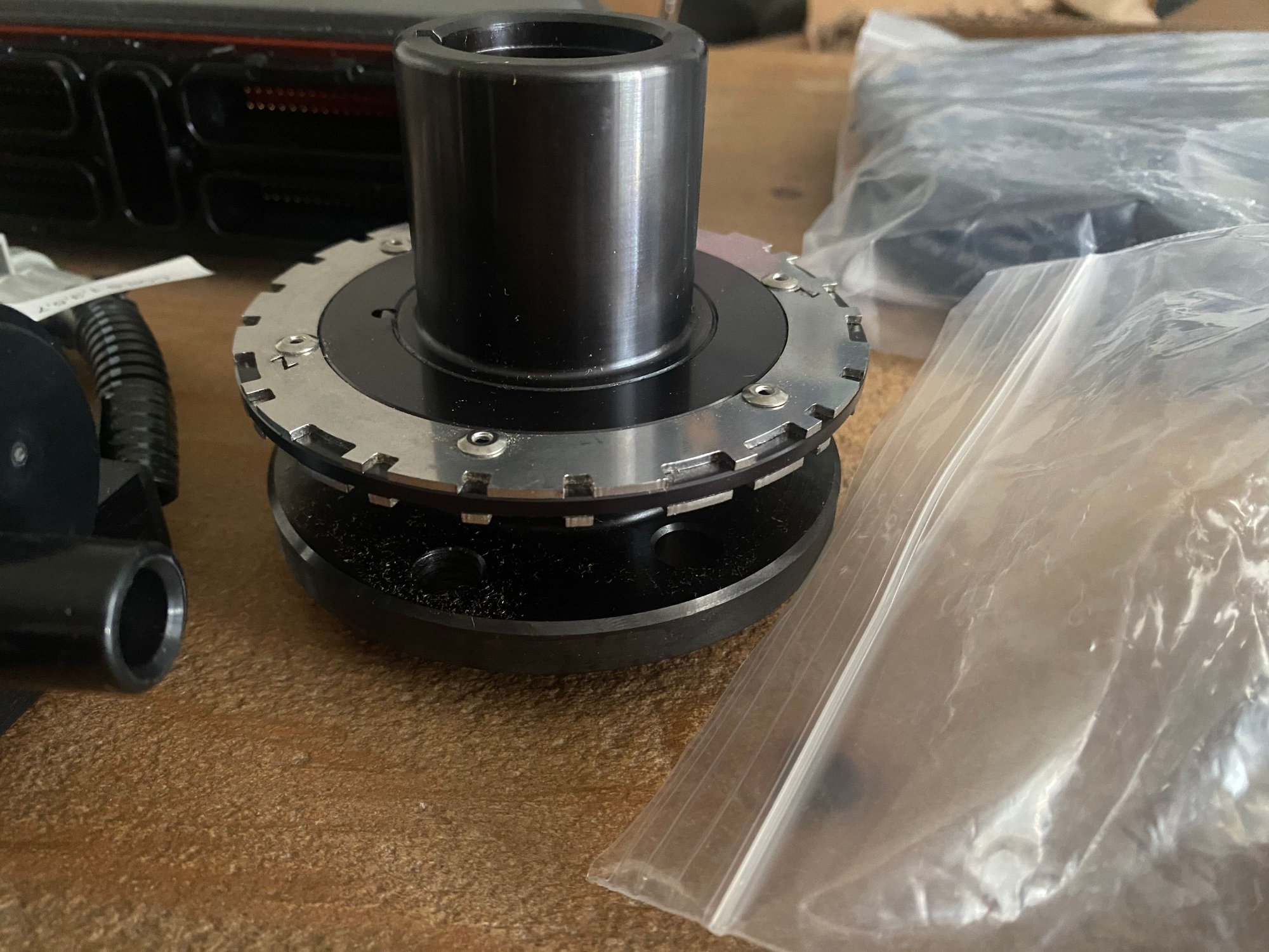

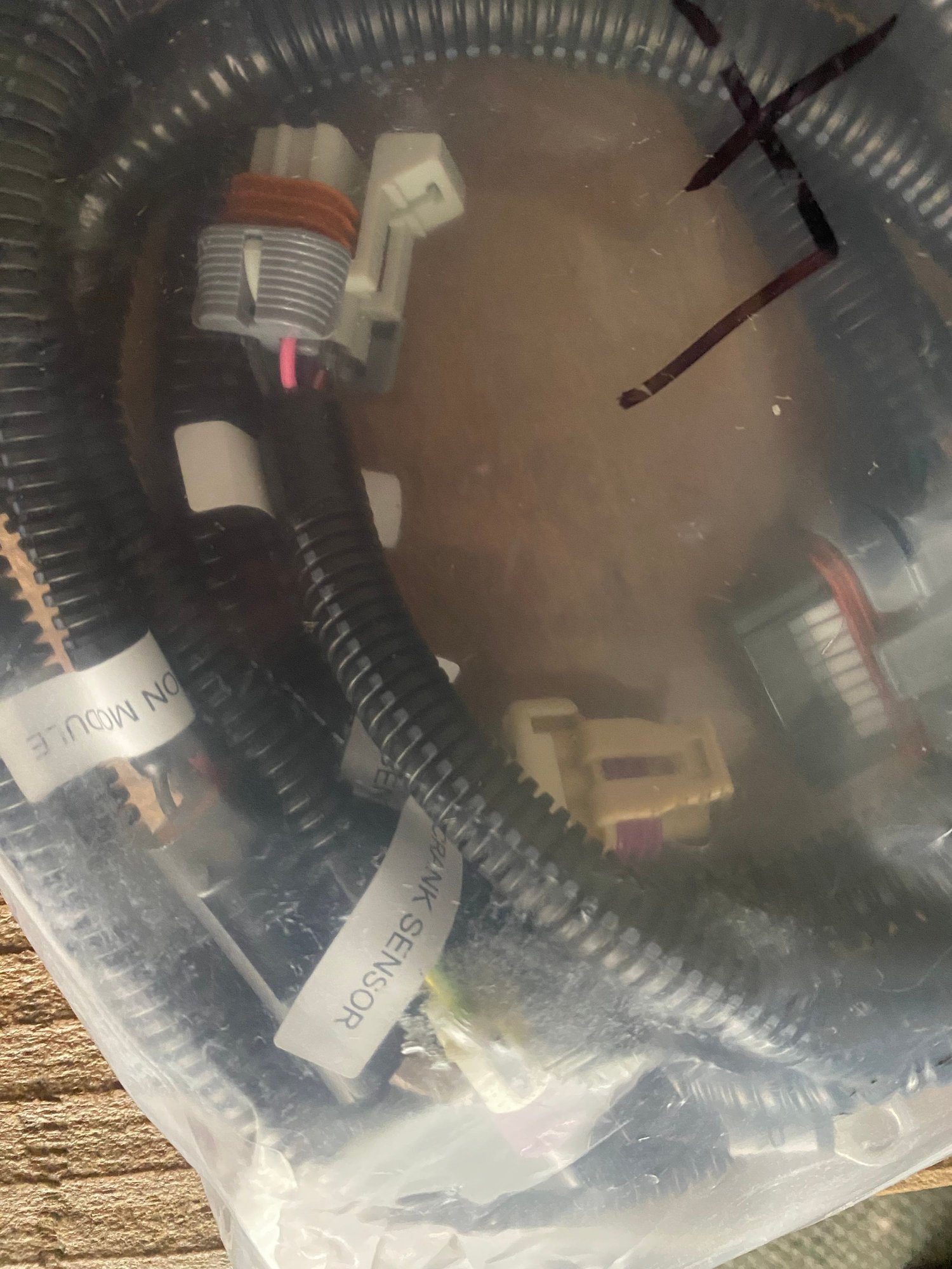

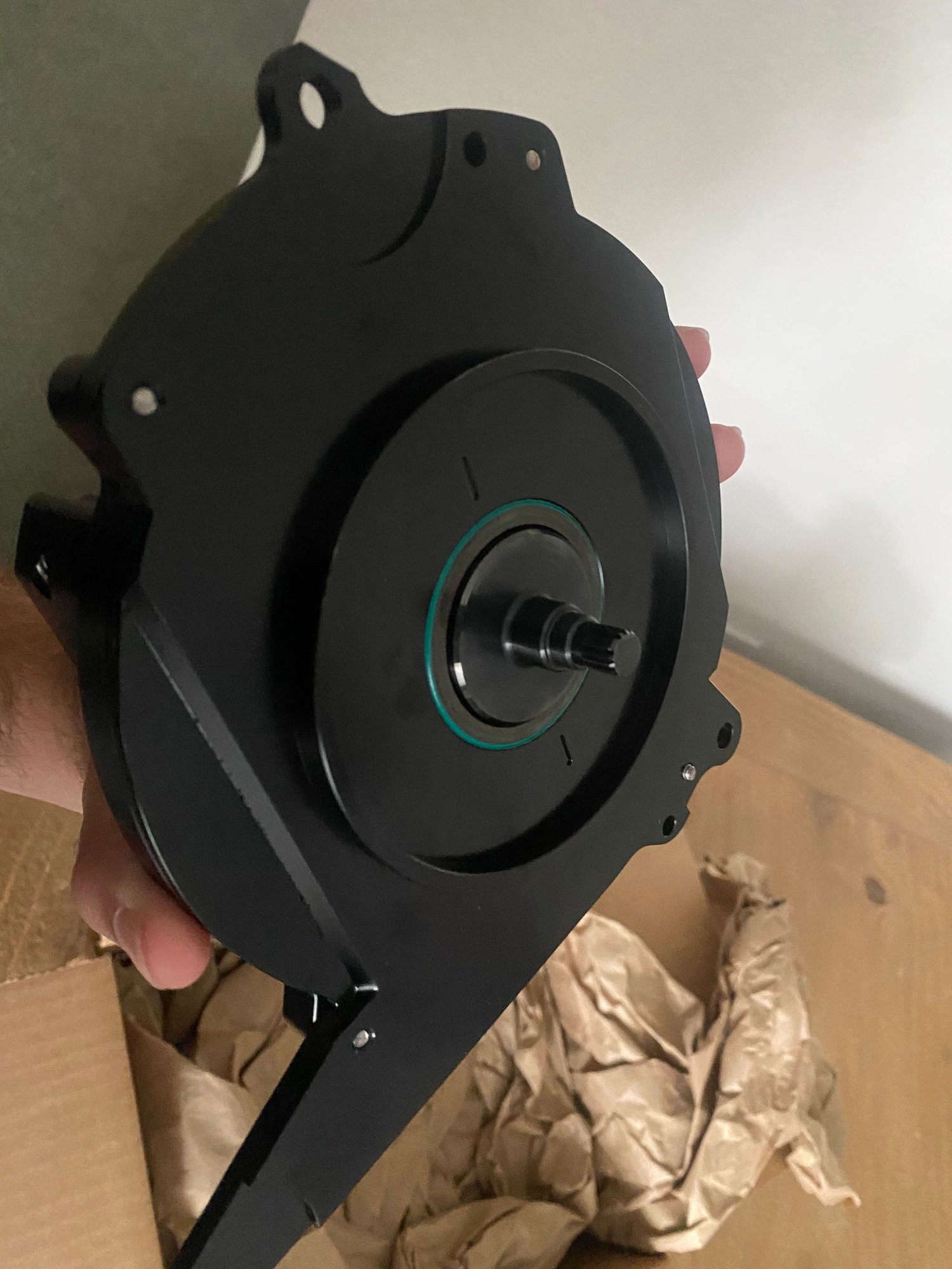

I am extremely happy to have gotten this Torqhead kit after so long, having repeated opti spark issues, but now ill have better tunability ect. The over all feel of all the metal and components is high quality and nothing feels flimsy at all. Having gone through the instructions on their website prior to having received them with the package it all came in, its very precise and easy to understand and im so so impressed with how it all works. Nothing feels like cheep thin soda can metal, its sturdy and the parts / build quality is just crazy.

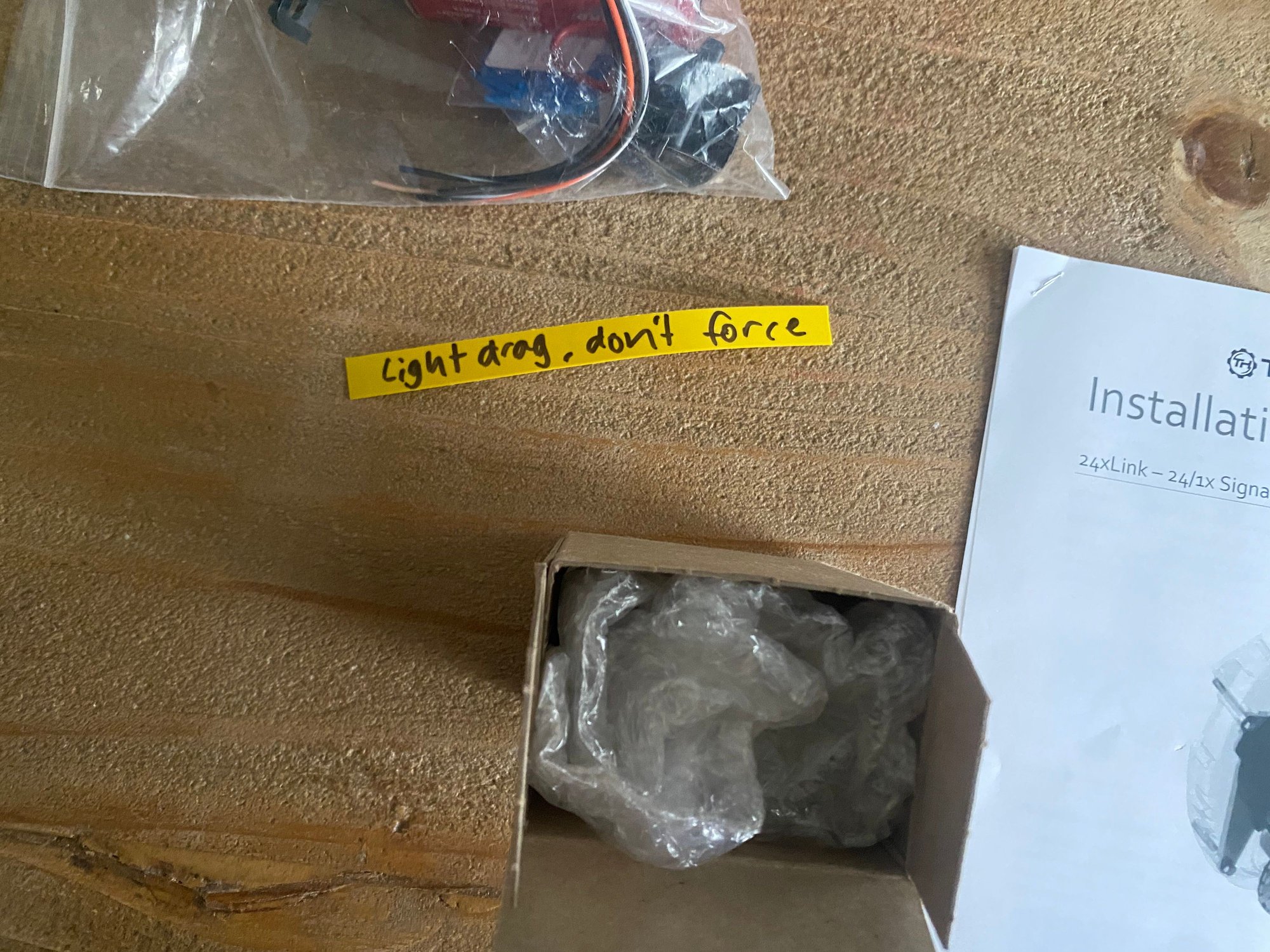

It is all ready to go, and everything is nice and labeled. I really appreciated the feeler gauge saying "light drag dont force" to ensure the sensor was the perfect distance away. Came with all the shims you would need for this kit.
Im excited to install this onto my 1994 firebird, and I will gladly update you all on how it "performs" afterward.

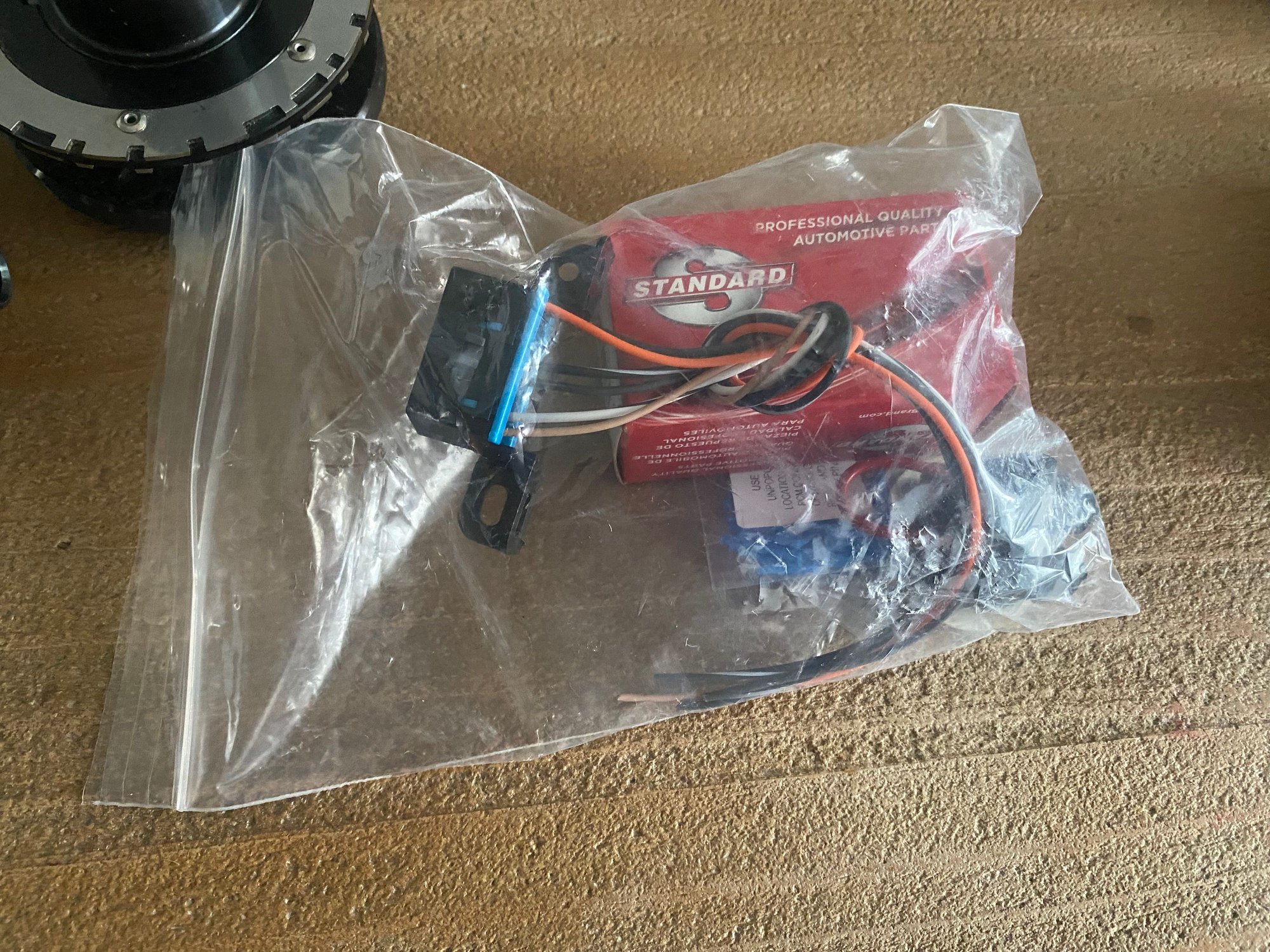

The only thing that I’m not entirely sure about is the wiring for the obd1 to obd2 port. Is that just splicing the wires where the factory obd1 port is at ?
Yea unfortunately that crank hub is incredibly difficult, if it wasn’t for that I’d be doing it myself. I got a custom tune with Torqhead for my car with a factory engine besides some bolt ons. Im having a shop install it for me.

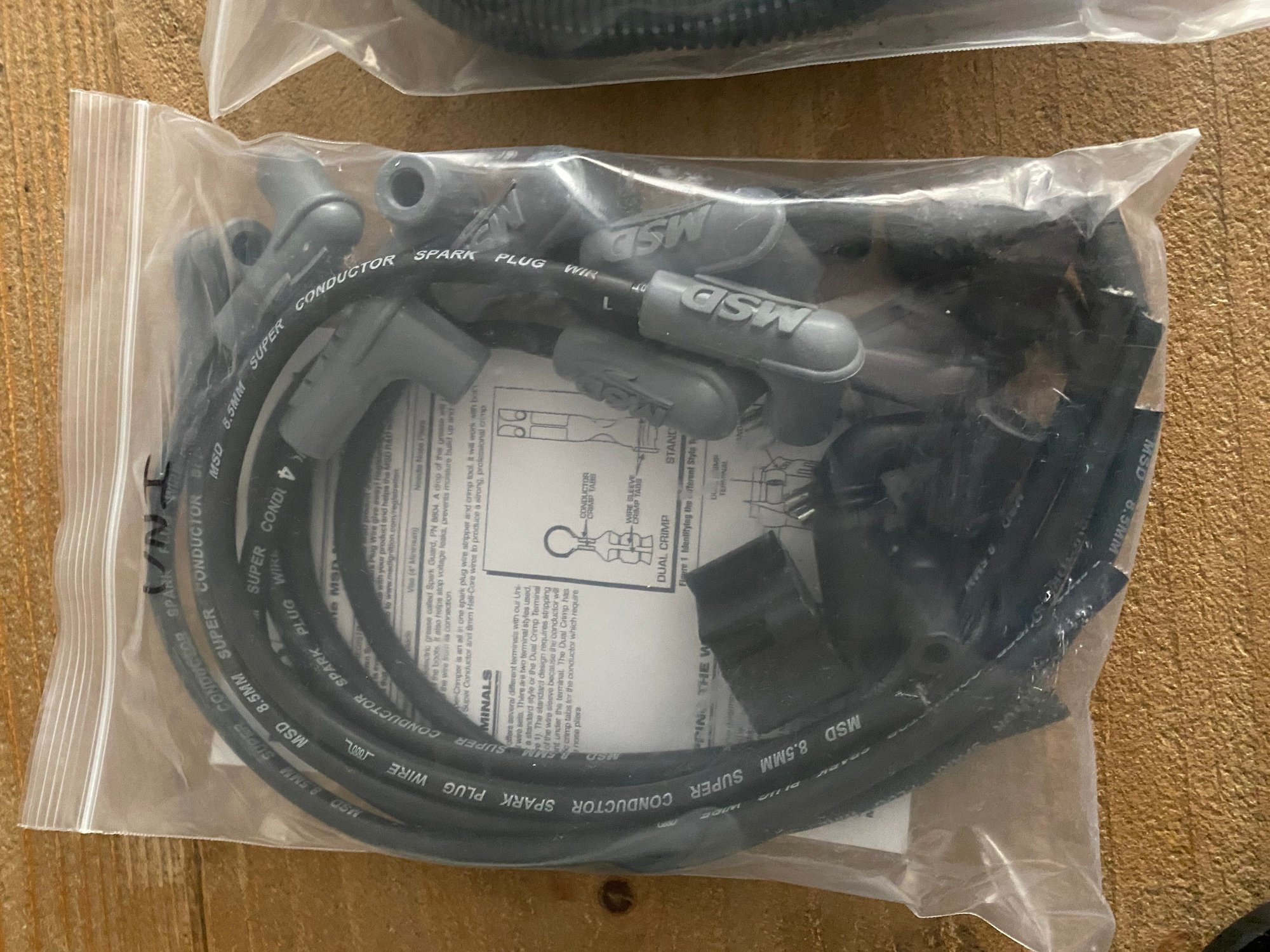

Finally Its perfect. ive had to deal with a misfire ever since I got this Torqhead kit installed. Everything with the kit itself has been perfect; my issues were a result of the shop messing up making the plug wires along with an annoying coincidence that occurred. kit installed. it has taken me about a month to diagnose, double check and get new parts to get my engine run flawlessly. Cutting to the chase, I had a constant misfire, a bad one. Barely got home and the engine was getting really hot. Had to top off the coolant, bleed the system and replaced all the plug wires. That solved the overheating and now the terrible awful misfired turned into a light intermittent misfire as if one cylinder was still an issue, but it wasn't as bad. I got a code p0354, telling me there was an issue with cylinder 4 was getting a misfire, or it was the one in the fourth firing order. Anyway I was pointed in the wrong direction and really because the firing order between the ls1 and the lt1 is different, the real culprit was coil on cylinder seven. I swapped the coils and the same code appeared and the intermittent misfire occurred, only happening when the engine was warmed up or I got down the road. Well later I had discovered my 4an braided steel nitrous line had cut through the sheathing of the wires that went to the coil on cylinder seven and was causing what Believe is called a short to ground as two wires were exposed and this metal line was touching both of their exposed copper wire. A good.... week or two later and a few hundred miles later and not one misfire. So problem solved !!! Only other issue I had was low voltage knock sensor so I replaced it with a Delphi knock sensor (2002 chevy express van knock sensor for the 5.7 vortec) and that solved that.

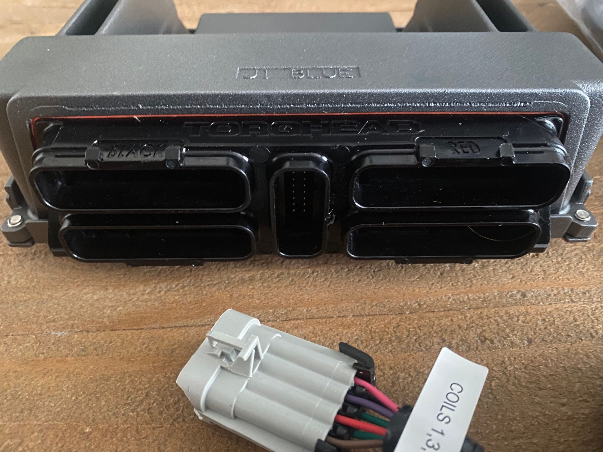

Is that a p01/0411 ecu with custom connector?

The computer is a gen3 ls1 pcm. The 411 ecu. It does appear to be modified. That middle plug portion that is new is where the cam and crank signal plugs into.
