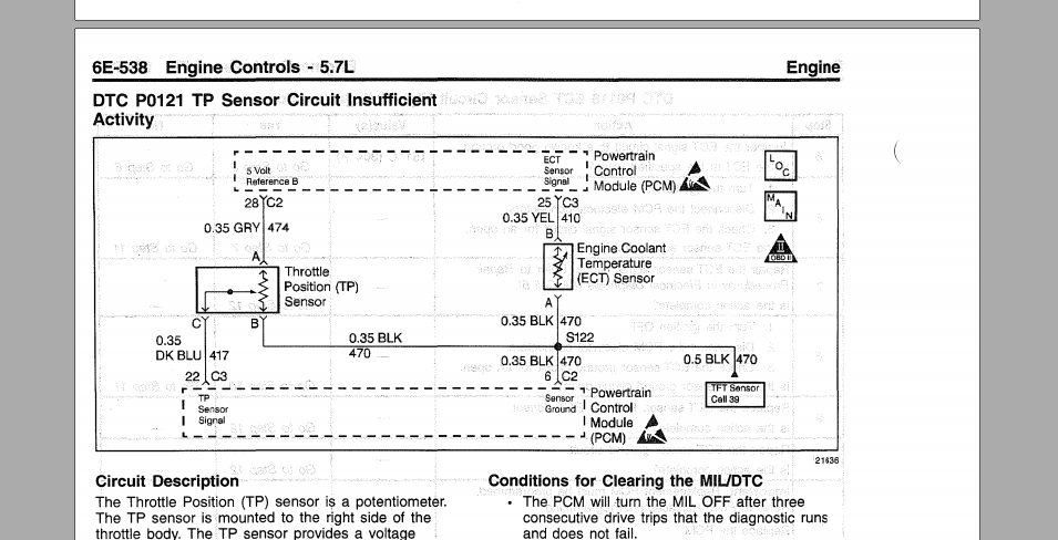

The first code has gave me hell, TP sensor has been replaced to a new one but when reading the voltage with a voltmeter the signal is almost at 5v and decreases at WOT instead of being in a low voltage and increasing at WOT.

Did the '97 LT1 engine harness and PCM come with the engine? Sounds like something is screwed with the wiring or you have the wrong TPS sensor. Pull the connector off the TPS sensor and check the voltages with the key on position. Below is from a '96 service manual.
