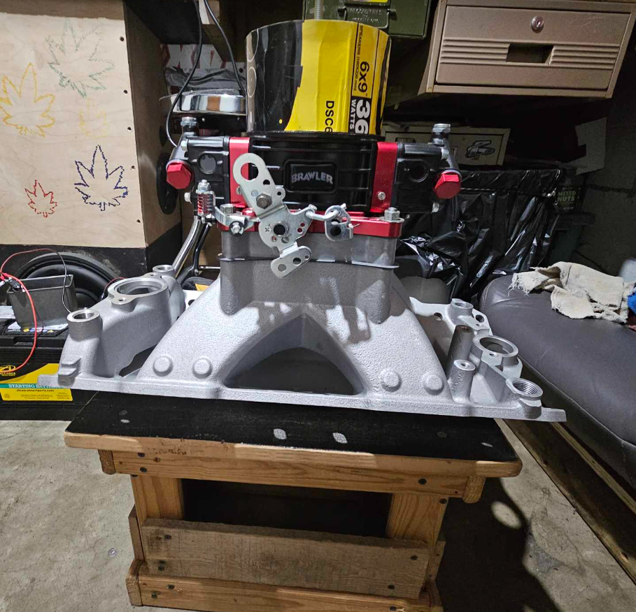

I need help picking a camshaft for my application. I currently have a fresh bottom end stock 95 lt1 with flattops pistons and aluminum heads.(heads are drilled for gen 1 sbc intake) I plan on running my high rise open plenum intake along with my brawler 750 and long tube headers, with my new t56 magnum. Rear end is stock right now but will upgrade to 4.11 or 4.56 gears after I get the car running. Want to be able to cruise a little bit and do burnouts aswell as be weekend warrior at the local drag spot. Dont care about lopy idle as much as i care about performance although its nice. Any advice is really appreaciated thank you much

Message Lloyd about what you want and he could do a custom grind though his 224/230-112lsa cam might be a middle ground or you can do the step up and go 226/232-110 lsa. On the website he states that its best for most people with a stock bottom en, good power and a very usable power band, even works with stock gears and factory converter for Fbody.
Definitely want to follow your build and see how it comes along, carb swaps are so cool on these cars.
