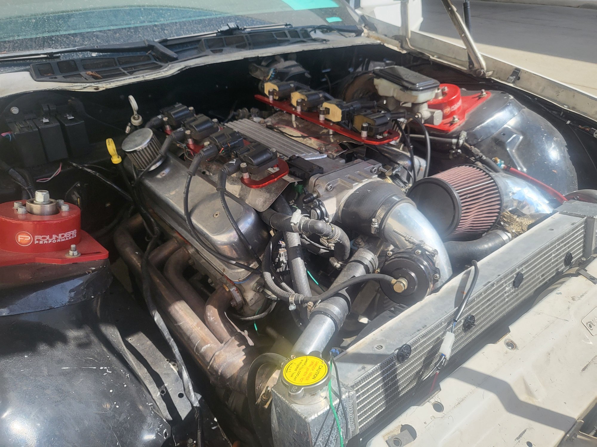

My 94 lt1 has the low mount alternator set up and I want to add an ac compressor to it so I can add ac. What belt and belt layout do I need for this to work?
the one on the passenger side. Currently my belt is from the drive straight to the alt and that's it. Do I need a tensioner? Do I need more pulleys? I'm really stuck on this

What low mount alternator bracket do you have? What I did is get the alternator relocation bracket from PCM of NC: https://www.pcmofnc.com/product/lt1-...et-hardware-3/
And then I flipped it around and put it on the driver's side. i then took my factory accessory bracket and cut it down to just fit the factory compressor and tensioner. I also drilled a hole in the alternator relocation bracket and used an idler (with a spacer).
Other than doing that, March Performance and CVF Racing make LT1 serpentine kits.

I have the same one. I'll try that and see if it works thanks.
