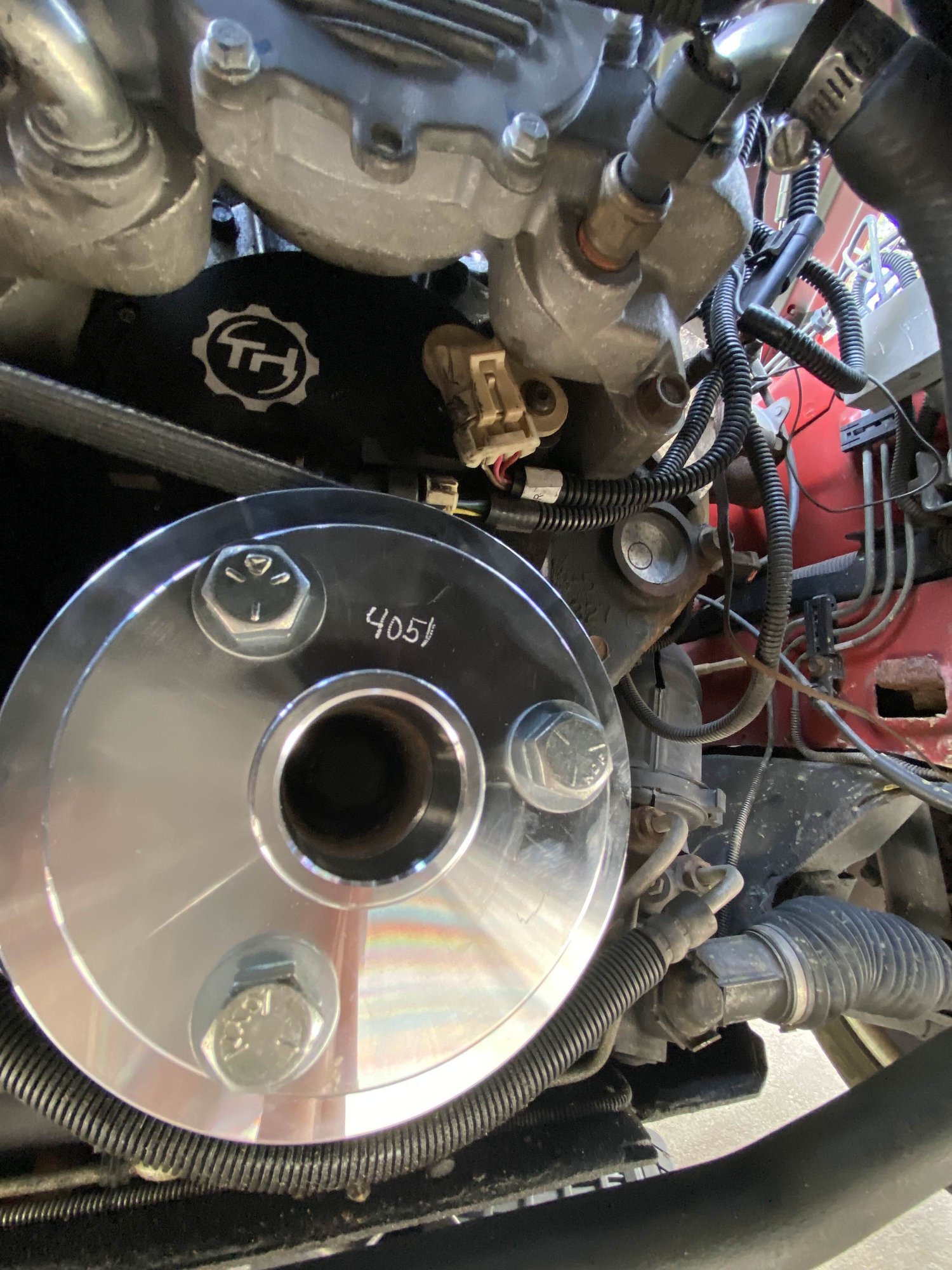

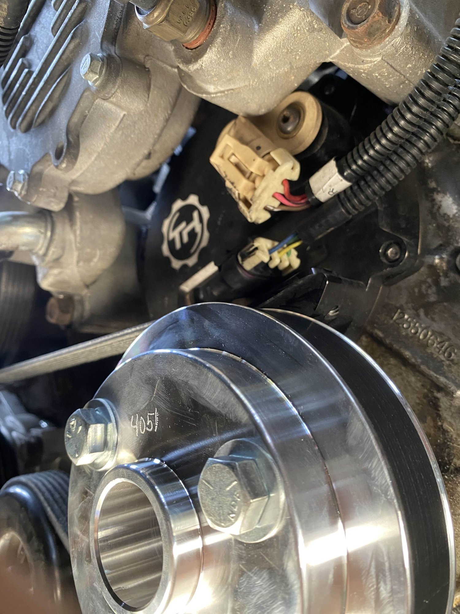

I got the pulley in and it is great. Looks good and I get get to the sensors alot easier. Shiny and Chrome. Too hot today so ill do the overdrive pulley for the alternator tomorrow. I have a torqhead 24x kit and it clears the hub perfectly and doesnt get in the way to cause sensing or reading issues. I did realize the 3 holes arent in a perfect triangle and there is a specific way you have to align the pulley. Also I did need a new belt. 6 rib, 59.45 inch. Part number : 5060595.

You do know you are also supposed to bolt on the stock damper as well, right?

.... I know what else im going to do tomorrow. Explains why the bolts were so long. Thanks LOL.

Without the stock damper also being bolted back on, you can experience what I did too many years ago as a kid. The timing gear bolts in the cam all sheered off and sent timing gear teeth and shrapnel through the engine.
Doh!

I never knew it would be that important damn ! Thanks for letting me know. I got it put on and it was aligned with all the bolts first try. Got the Alternator overdrive on as well. Definitely will say the engine is idling smoother and is more responsive. who knows how much im really getting from it. But its cool C:

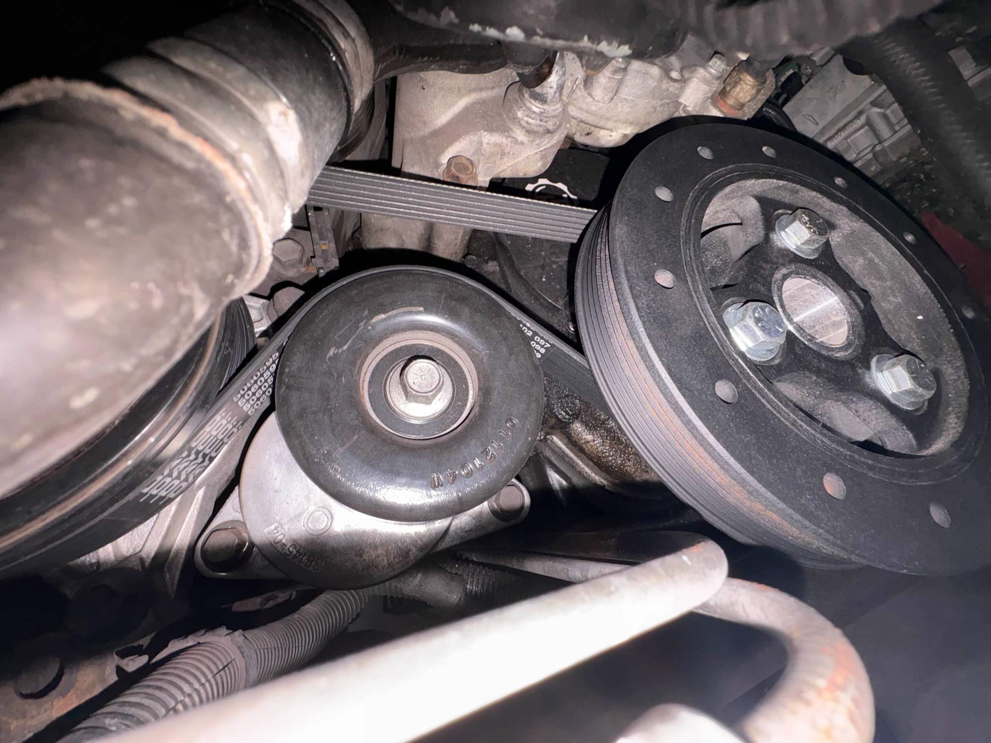

Where exactly does your tensioner sit? I ended up using a shorter belt with that underdrive pulley on my own car.

Ill get a pic of the position of the tensioner tomorrow ! I wonder why or how an ac delete would have a different pulley. Also I will note after driving the car for a bit I notice that when the high speed fans kick in and im stopped at a light without my head lights on, Ive got to give it some gas to get up to around 900 rpms to get the volts back up. Even with the alternator pulley swapped.

Here you go, hope this helps.

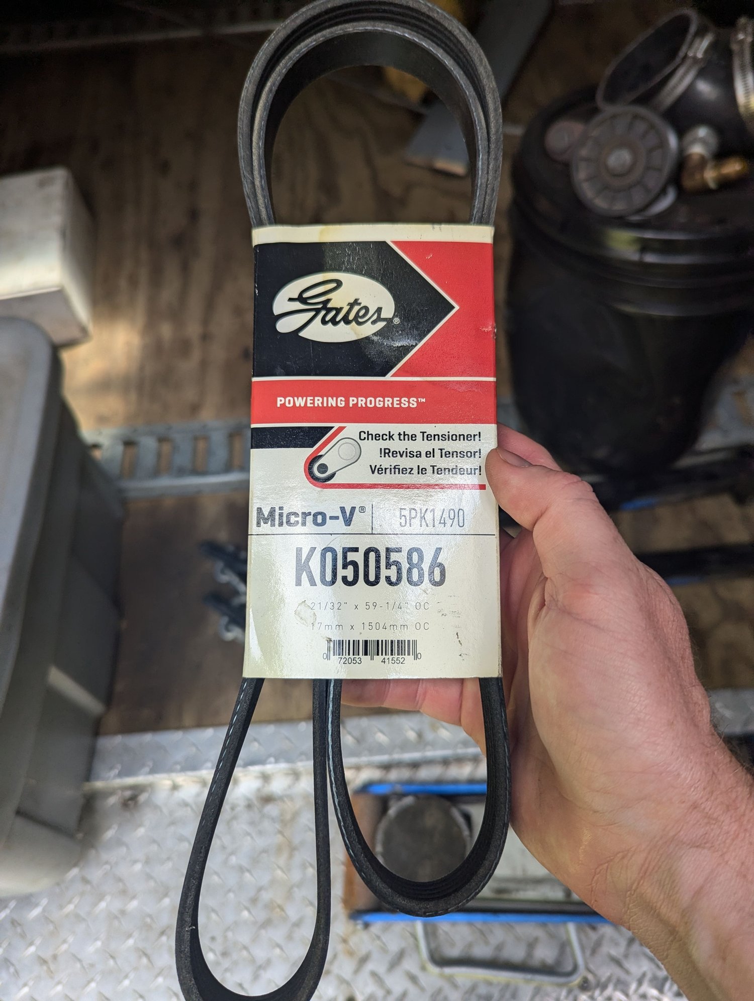

590 means either mm or more likely 59.0". A 595 would be 59.5". I want to say if it were mm there'd be 4 digits. I too run an underdrive pulley and the stock belt was too long, I'd lose PS momentarily when I would bump an apex curb. I run a 5 rib belt, I forget the length, but it put my tensioner where it was happy. I want to say it's 59 5/8"?
