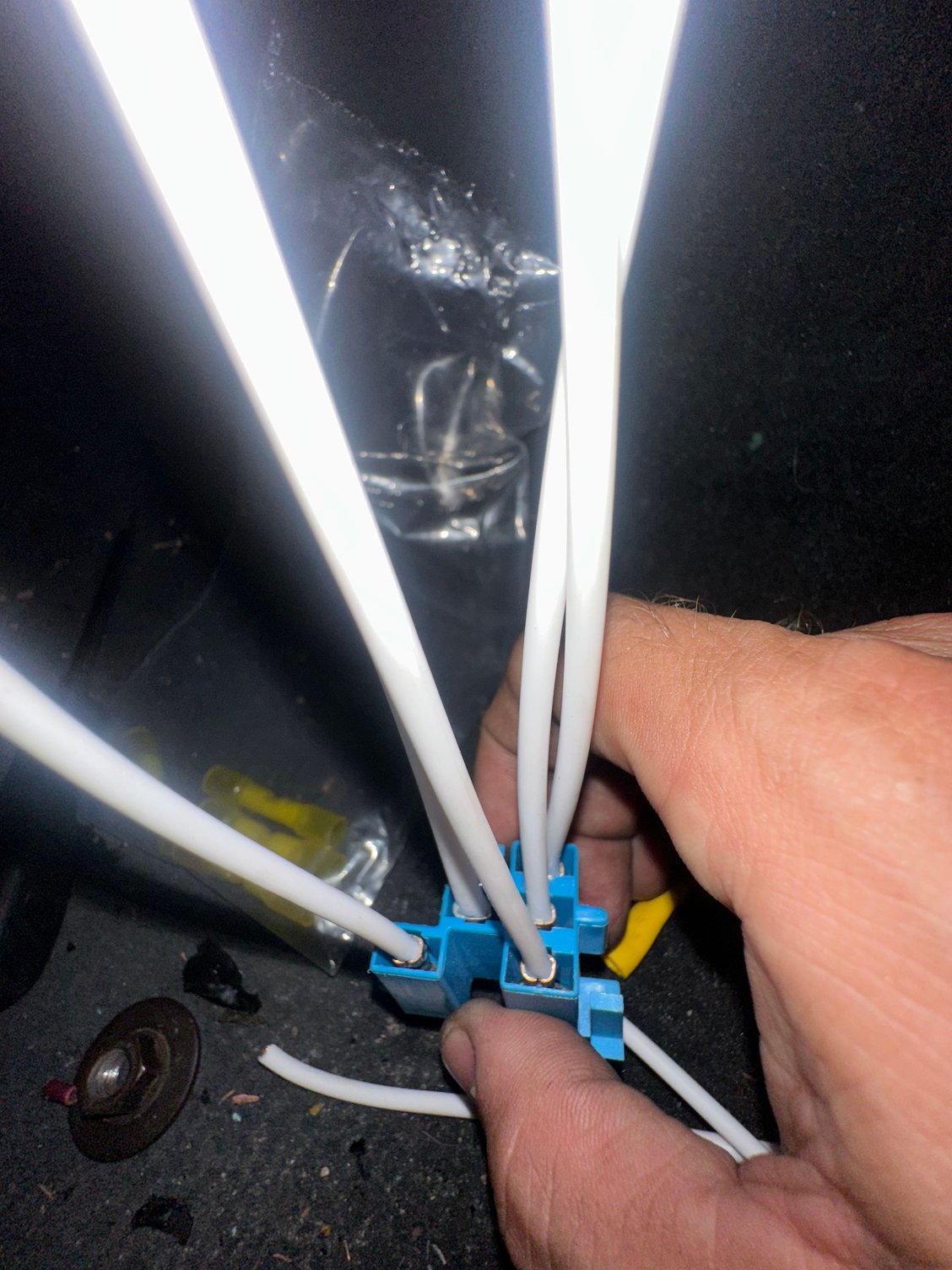

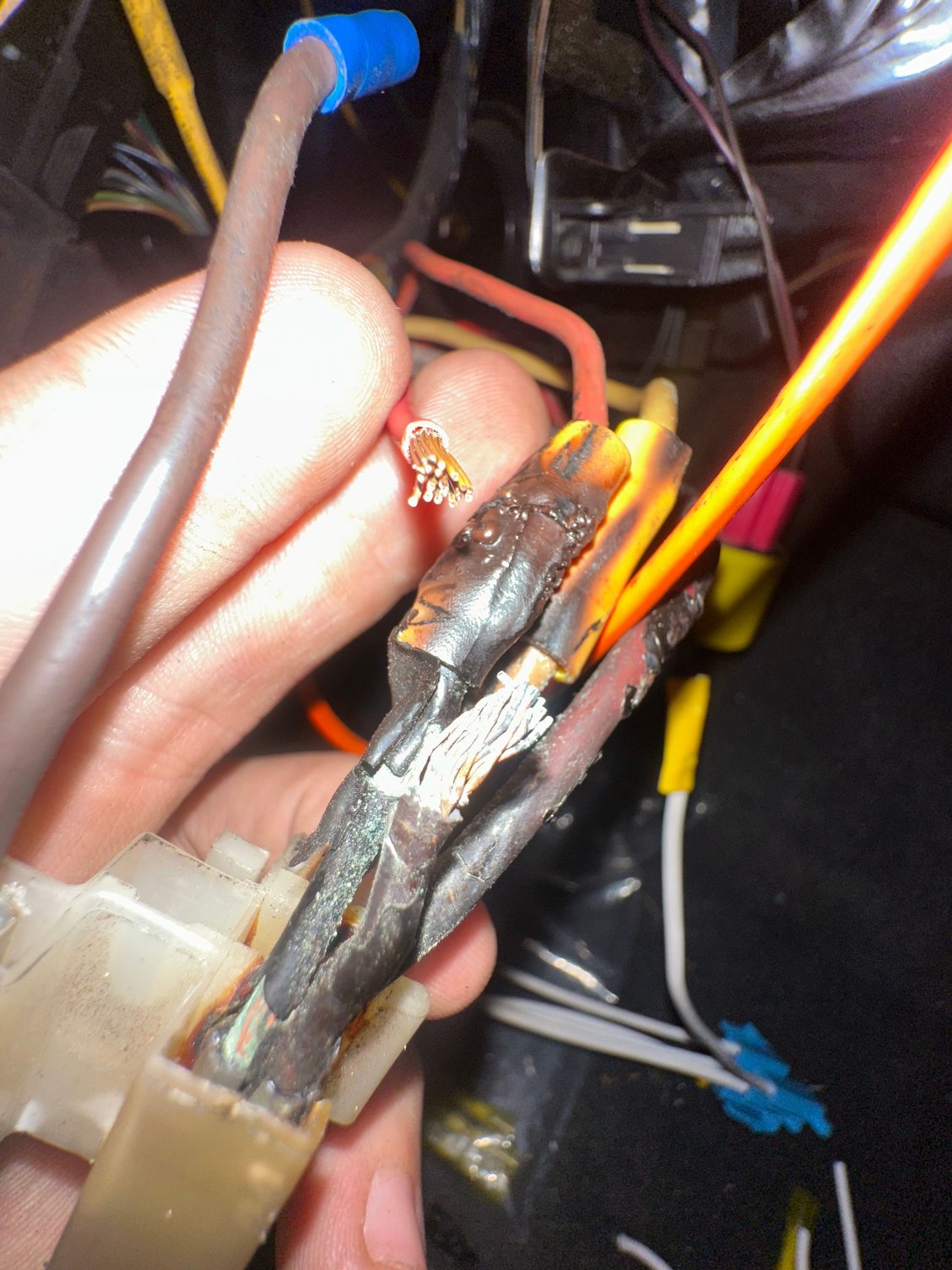

Wiring up a new ignition switch but notice 2 wires in the old connector going into the same pin. On top of that the old switch is missing a wire.
2 wires are going into the same lead
Meanwhile the new one and every single new on I could find have 1 wire going into that same lead.
Meanwhile the new one and every single new one I could find have 1 wire going into that same lead. GM genuine PT289

Ran into this problem 2 years ago when I did mine. Bought several new ones and all were the same 1 wire version. I don't remember exactly what I did, but I ended up using it with no problems. Thinking back I must've either spliced or traced the wires and found it went nowhere. Sorry not much help I know

Thank you. It was helpful. The middle lead that is used for nothing had 10 AWG wiring. Ended up swapping that one into the same pin as the 2 wire one and spliced and connected the 2 12AWG wires into the new 10AWG wire.
