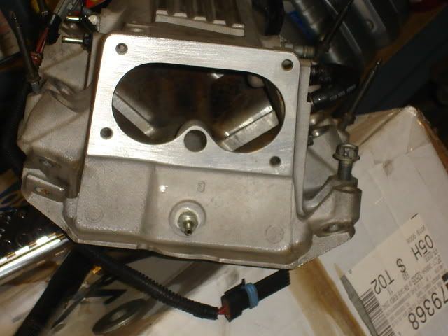

Hey everyone this is my first post on ls1tech, I am planning on porting my gen 2 lt1 intake and I was wondering why some people cut out the center of the intake near the throttle body. Can someone please tell me if it is worth cutting out and if there is anything I should consider about porting my intake?

people do that if they are running the mono-blade throttle body, if you are running a stock-style TB it is unecessary to do
