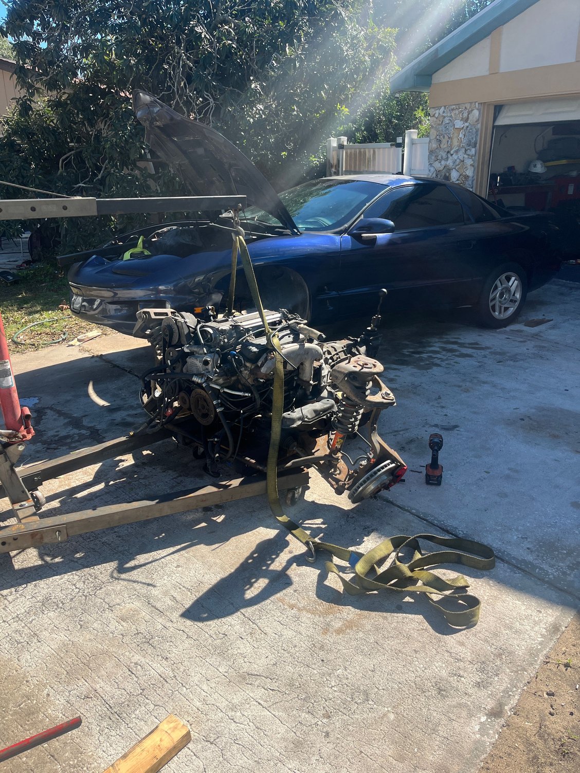

So most people do the opposite of what I did and ls swap everything but I have a 2002 firebird that was originally a 5 speed v6. I swapped in a lt1 and t56 from a 95 Camaro and got everything working and running but I was wondering if the 98-02 t56 crossmember is what I need to mount the lt1 t56 to the body. Obviously I have the 95 t56 crossmember but it’s not lining up correctly as most of you know the mounting points are different between to 93-97 and the 98-02. This is literally the last thing I need to get the car drivable.
