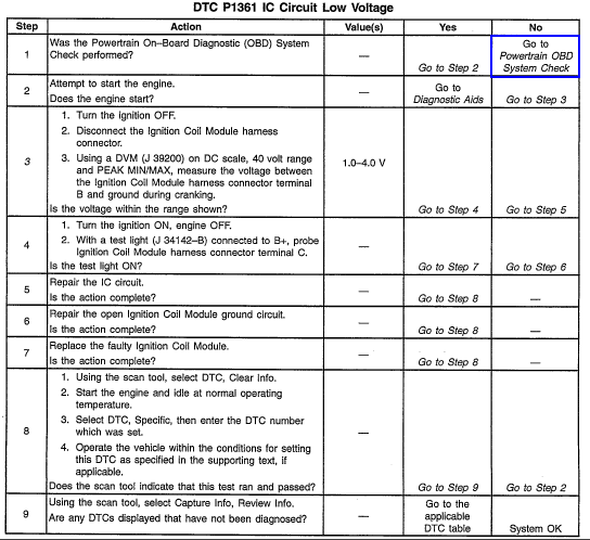

Heres the flow chart for diagnosing the P1361 code......hope it helps.

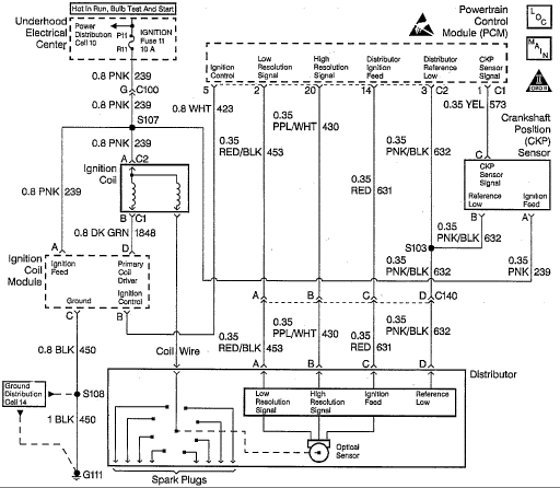

oh, and heres the schematic........
