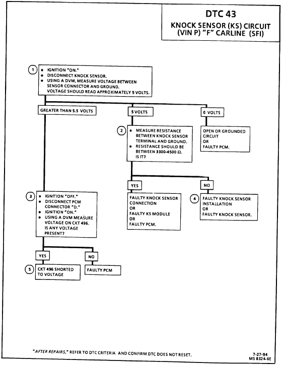

What is trouble code 43 the readout says electronic spark control or sensor, is that the opti?

43- Knock Sensor (KS) circuit

Code 43 will trip if the computer recongizes that the knock sensor circuit is open or is grounded.
Attached is the diag flow chart

thanks alot guys, after my header install, i have no power at all car has trouble going over 2,000 rpms, checked all the plugs and wires and none are arcing or burnt so I figured probably opti go get it scanned and got this code, see what happens when I dig into it. really appreciate the info.
