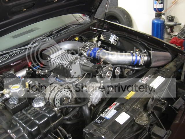

No it's not intercooled that would be pretty much impossible with the room we are working with under the hood. Don't know how much boost yet either as I can't get on it but these blowers are safely capable of 10-12 lbs on a 350.

If you mean before the blower yes you could but you would need some kind of "cool can" out in front of it to "ice" the air down below ambient temps otherwise it would be useless and I'm not sure even that would benefit much. On a centrifugal you are cooling the air after it goes thru the blower and is heated up. It's much easier on those because it's not mounted on top of the intake.

I'd like to see some numbers on this. When you flatten the ductwork like that it seriously kills the airflow. I'm thinking it might be bad enough to totally negate the advantages of the roots-style setup. Did you do any flow testing on the duct outside the car?

I'm not gonna argue with you but I will say if the motor is making boost then there is no restriction, can't make boost unless the air can get in the intake. Also, talk to I think it was Alvin at pcmforless, he had an eaton m112 on his with one of these "flattened" intakes and made somewhere around 400 at the rear wheels. Also, I believe MPE has a kit for LT1 Impalas and I've seen pics of their first ones and they also have a "flattened" intake and it doesn't seem to affect anything. Will it flow enough to make HUGE HP numbers? Maybe, maybe not. Will it flow enough for a good street engine? I'm purty sure. It might not be quite as efficient as far as flow goes but it has more volume inside it than the 3.5" tubing in front of the TB. By the way, I'm no engineer by any stretch. Started to do the college thing once but you know how that goes...........

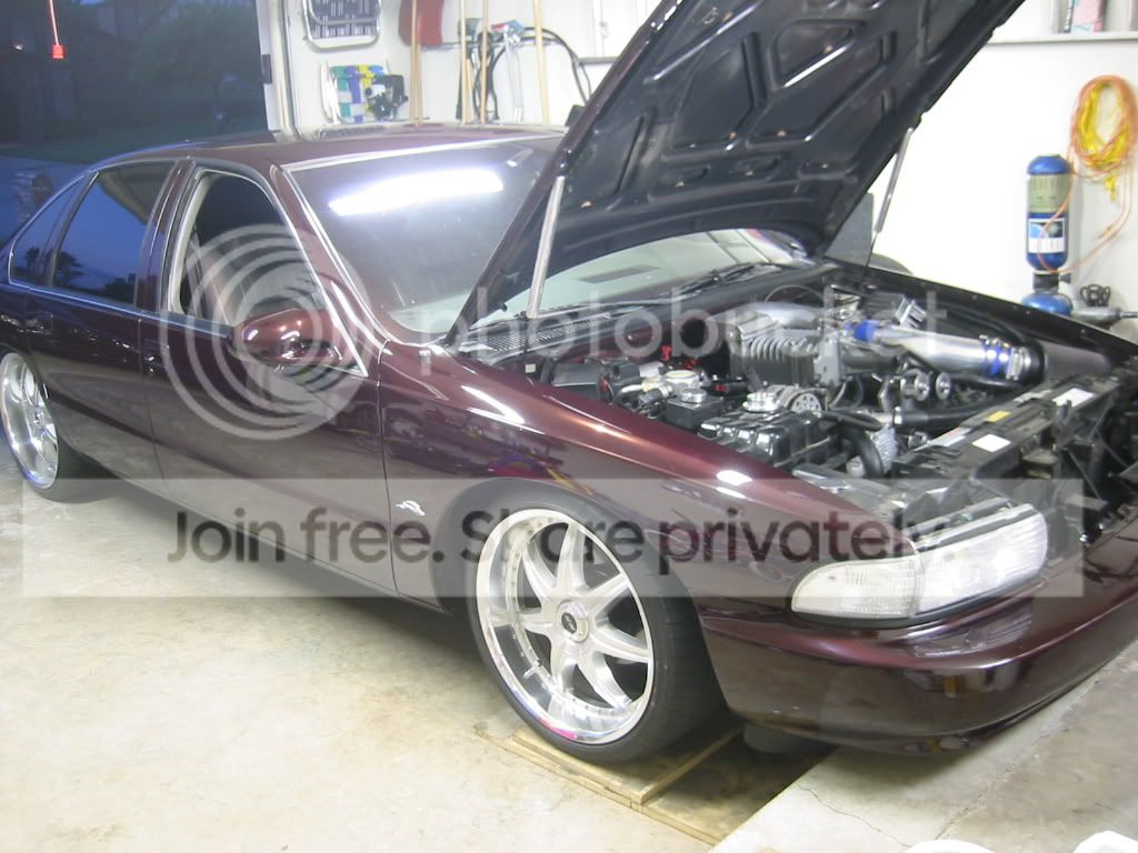

ANd YEs MPE is the maker of the kit to install an M112 onto an Impala. Wont work for you F-body guys due to cowl clearances and so far. IIRC MPE is in dealings with magnacharger to produce a more readily off the shelf kit to be used on hot rods and stuff. Not sure if that's true or not, but the kit Keith makes is nice and of top quality..

If you want to pick up some free power, you'll need to add 2-3 thin dividers inside the duct spaced about 1 to 1.5 inches apart. This will clean up the airflow a ton and will get you up around the same level as Buffman's.
You don't need to be an engineer to see some examples of why this is important. There's a reason racers like to have long intake runners. Wide flat intakes induce a lot of turbulence. The dividers would minimize that. I hope that helps. (It's gonna work--just a question of how well it COULD work.) I wish I had the fab skills to do something like this.
