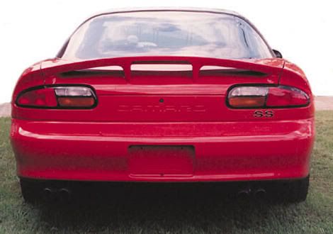

those two verticle bars in the middle and the light. The lt1 version doesn't have those. I've never done a side by side but, I think the total overall shape and curvature its identicle, just doesn't have the two bars. I didn't realize how different the light in the middle was till I just looked at these.. here's a pic of mine and a pic of an ls1 style.... I like the spoiler without the bars but, I kinda like that LED middle light more than mine.. hmm....
I actually put the ls1 style on my 97 SS, the difference is ridiculous. The two spoilers are not even close in height. The ls1 style has a HUGE lip on it. The lt1 style is just a z28 spoiler with a fiberglass lip slapped on it. Over all, the ls1 style , oem or not, is a waaaaaay better looking spoiler for any camaro.
