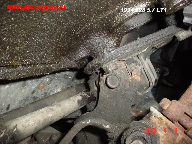

how do you get the motor mount bolt on the drivers side out? i am working on my car right now (yes i have internet in the garage) and cant figure out how this unbolts. both the 2 bolts block either one from coming out...crazy...
pic attached of whats going on.
thanks for the help

From: Bryant, AR
A. you've got a leak somewhere. lol
B. remove the bolts blocking it, stick a wrench on the bolt the use an impact with extension to get the long bolt out.

that bolt thats blocking it is being blocked by that bolt tho.
that or i misunderstood ur post.

gott jack up the motor a bit and they will unblock each other, had mine out in about 5 min

jack up the motor slightly and it will clear had to do that to mine also.

I just had mine out 2 weeks ago for my header install and thats all you have to do.... Just jack up the engine and it will clear. I used a 6 or a 9 inch extension on a 3/8 drive ratchet and got to the nut on the front and used a wrench to hold the back. If it hasn't been off before sometimes you'll have to use a breaker bar and an extension to get to it. But it shouldn't take but 5 or 10 minutes to do once you get the engine jacked up! Then once you get it loose if it don't want to come out use a screwdriver and a hammer to beat it out of the mount. Watch the threads but mine had a area where there was no threads on it just a flat area and it came to a point. Hope this helps......
Unfortunately, the photo disorients me. I recently changed out the drivers side
motor mount (and passenger side) on my 95z. There are 3 bolts that bolt the
clamshell motor mount casing to the engine.
There is also a single, very long bolt that runs front-to-back of the car. Remove
that long bolt, then remove the 3 bolts holding the engine mount casing to the
motor. You will need to use a floor jack to jack the engine up on that side a bit
to remove it all (to remove the tension). Let me go take some photos of mine
and identify the bolt areas - mine is still up on stands.

thanks for all the help everyone...jacking up the side let it clear. now we've got the headers on and tommarrow well get them tightened up and finish this whole deal off

Use a wrench on that side and a socket on the other = cakewalk. I did jack up my engine (put the jack under the m6 tranny) and that helped with clearance, but a wrench and socket will do the trick.
