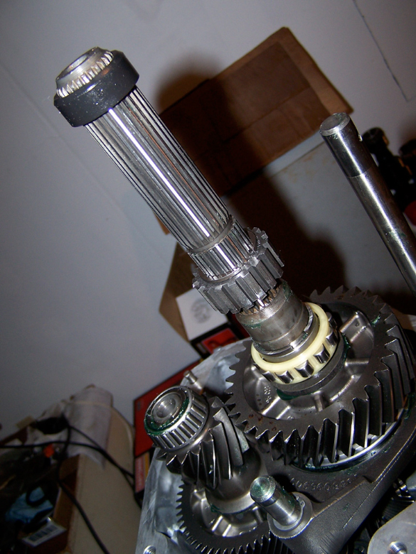

where can i buy a reverse synchro? and how hard is it to put on? its a 96 m6 and i seem to have ground the synchro to ****. the rest of the tranny is fairly rebuilt.

It's in the tail, so its possible to do in the car by just lowering it off the xmem and pulling the shifter and tailhousing.
A few snap-rings and c-clip on the fork, and it should all slide off..
