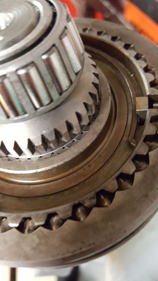

I have billet keys, is the current spring I have installed ok to use?
I think it's supposed to be green.

Looks fine. Don't forget the snap ring to keep the hub in place though.
