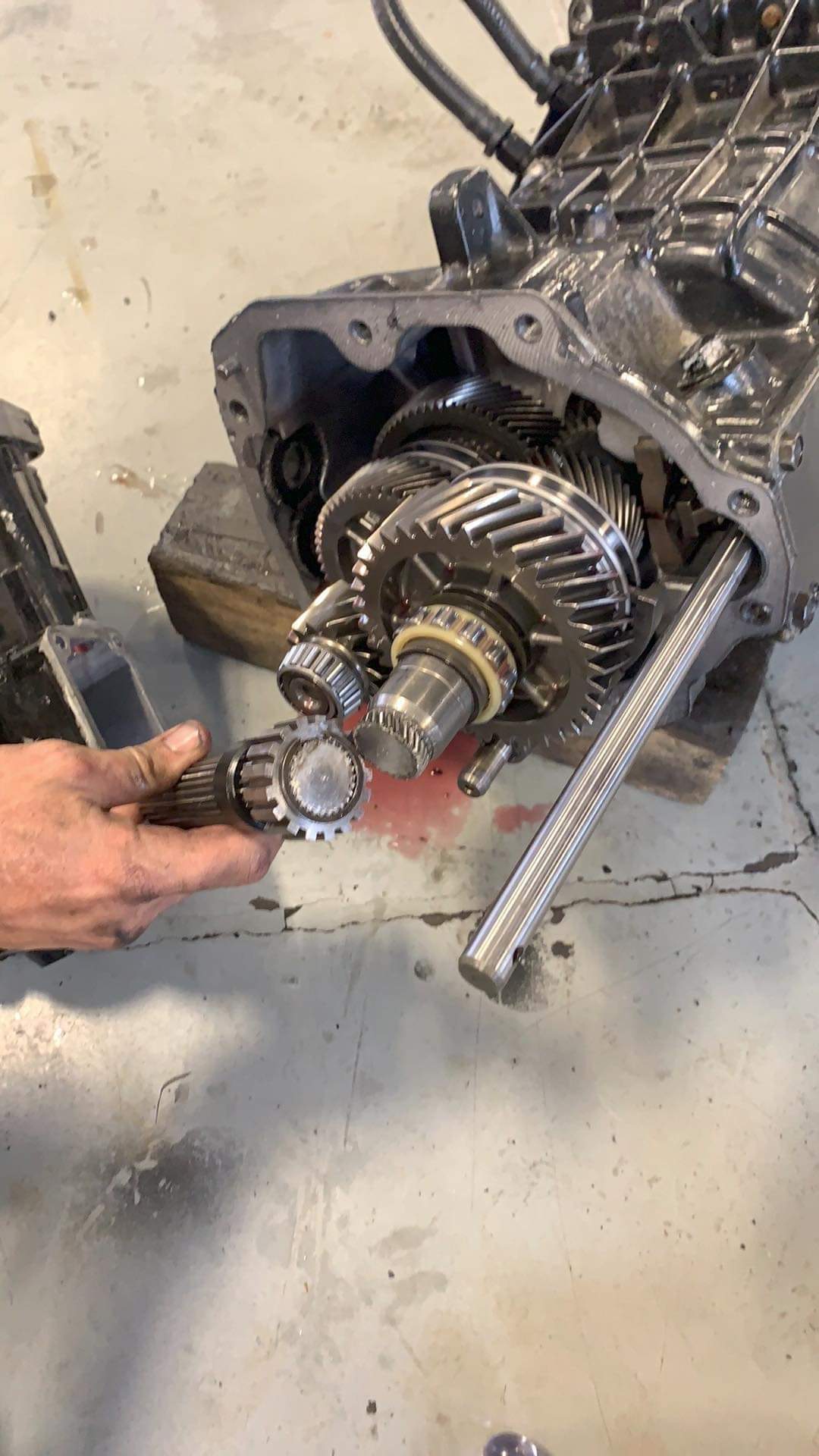

I drove his car almost every day before he was able to come home last week, since he was deployed during LSFest, to break it in. Night and day vs the RXT Twin disc he had in it. He drove and did a few "pulls" with some friends. So we decided to take it to the track to get a few passes. Low and behold, the mainshaft snapped at rear on the first launch. So that was that and trans will be heading back to Tick for a new upgraded shaft.
