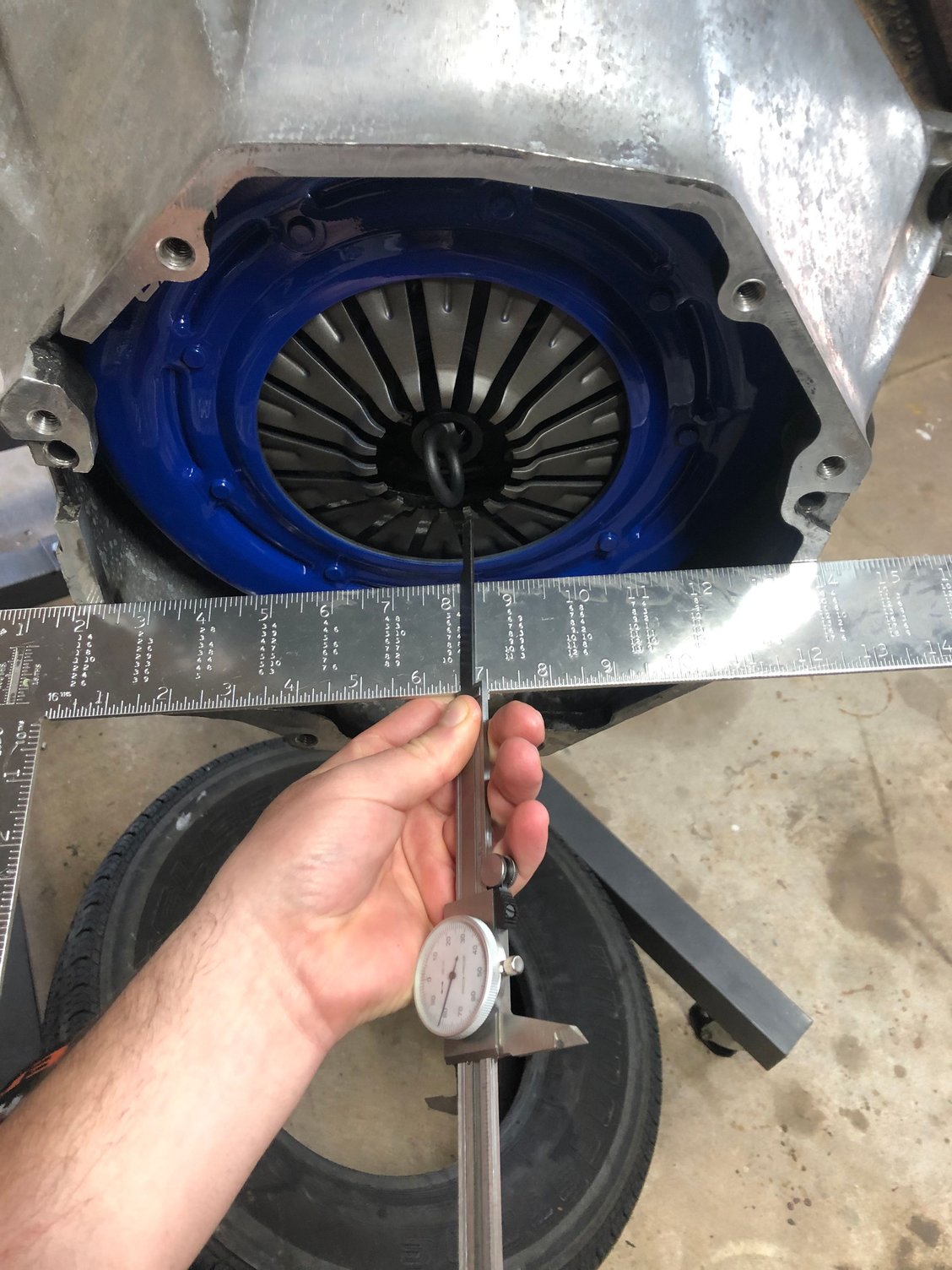

Can you show pics of exactly where you're measuring and how? Are you pressing the slave all the way in?
Old Apr 18, 2021 | 08:08 AM
phutch27's Avatar
Joined: Apr 2021
Posts: 3
Hi spider, here is how I've been measuring, thanks!

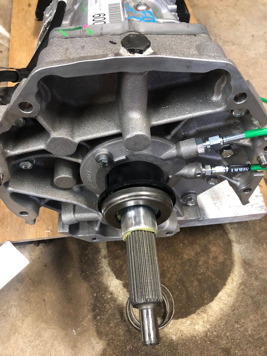

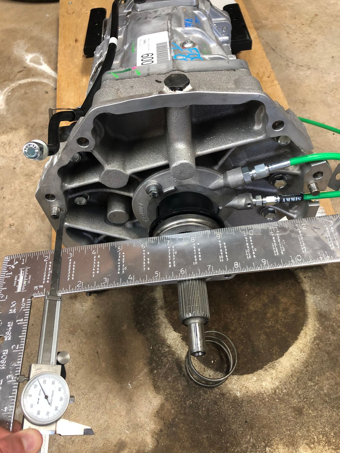

Old Apr 18, 2021 | 06:51 PM
phutch27's Avatar
Joined: Apr 2021
Posts: 3
Here is how I am measuring
