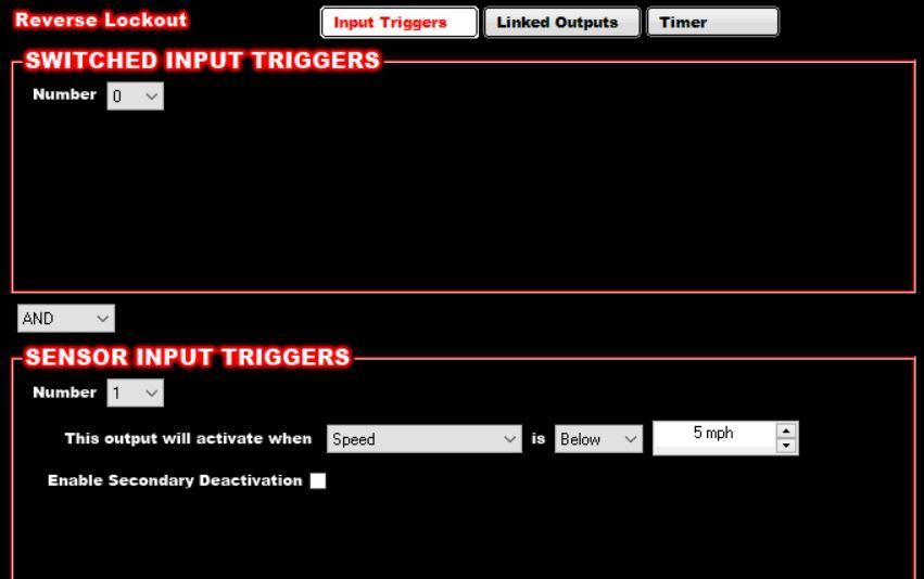

Thought I'd get some input before digging too far into this problem. T56 reverse lockout is not blocking the gate. I keep walking into reverse when shifting to 5th on the highway. Today I got in far enough that it ground teeth.
This is a Holley EFI where I provide +12V to solenoid when (mph > 5). The +12V ECM driver is tripping on/off properly in datalogs. I haven't spooned into the circuit to measure actual voltage but the datalog is probably believable.

On my TR6060 12+

Yeah, I know how to do the software. Been driving it for 5 years. More interested in insight about how the solenoid could fail with the gate open
