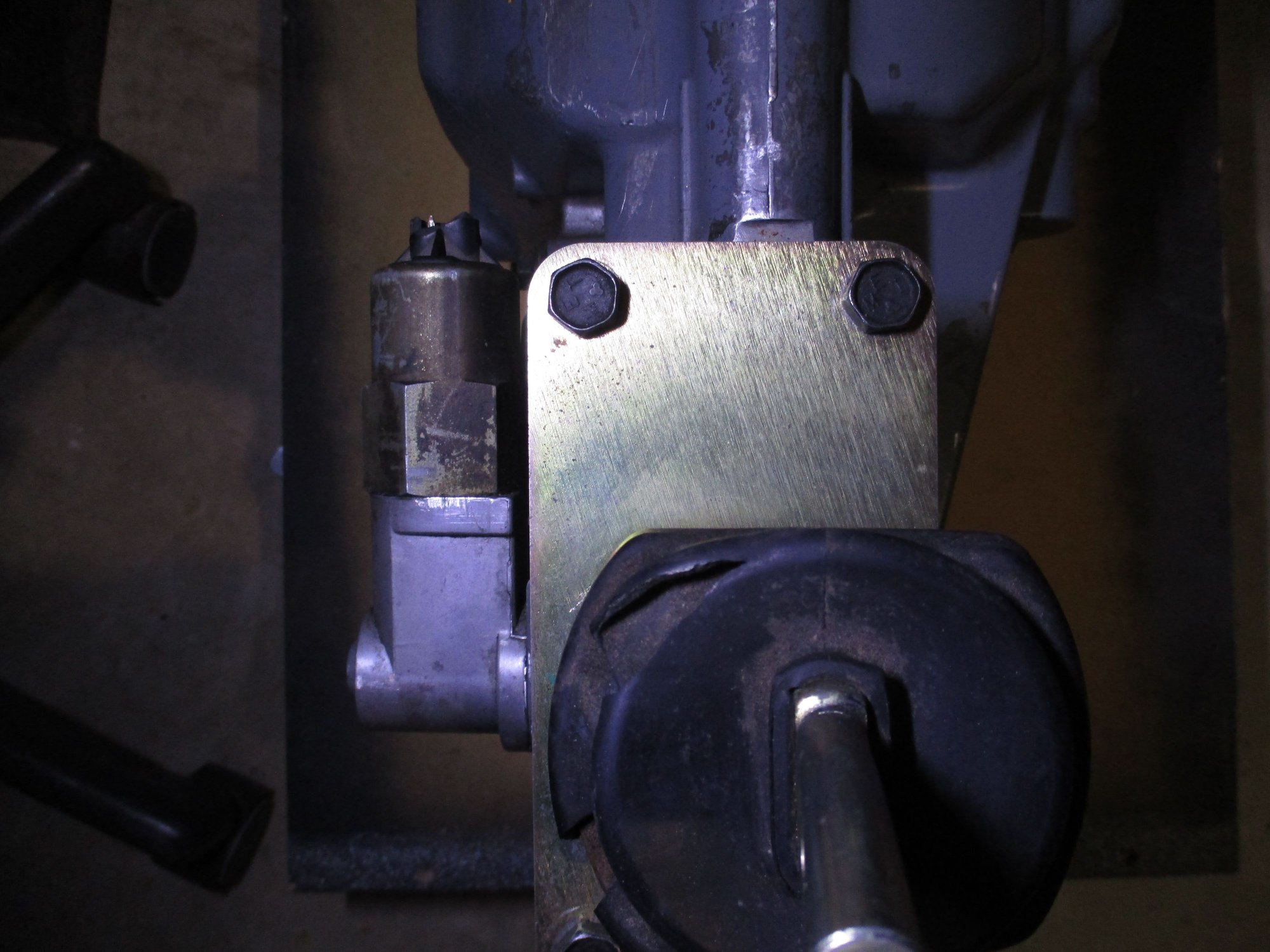

hows it going,hey sorry i dont mean to jack your thread but i figured you might know.im installing my T56 in a cammed 6.0 blazer and to make my reverse block out work,i have to ground one pin to the frame or some place and then run the other pin to my brake lights.help......do you know which side is pos and which is neg ?
it has two pins.the solenoid itself is facing the engine,so lets call it a inner pin and outter pin.which is which,does anyone know ? i need to start running my wires.
thanks in advance

Pink is voltage, Lt Grn is control circuit. If looking directly at connector, lock tab on top, Pink is on right.

i dont have a harness wire i have to make one,out of all the solenoids on the trans the rev/block out is broken,but i have a set of speaker wire connectors that went to some tweeters that fit perfect on the pins,saving me 82 dollars without tax on this,so in the picture which one is the positive lol ?
