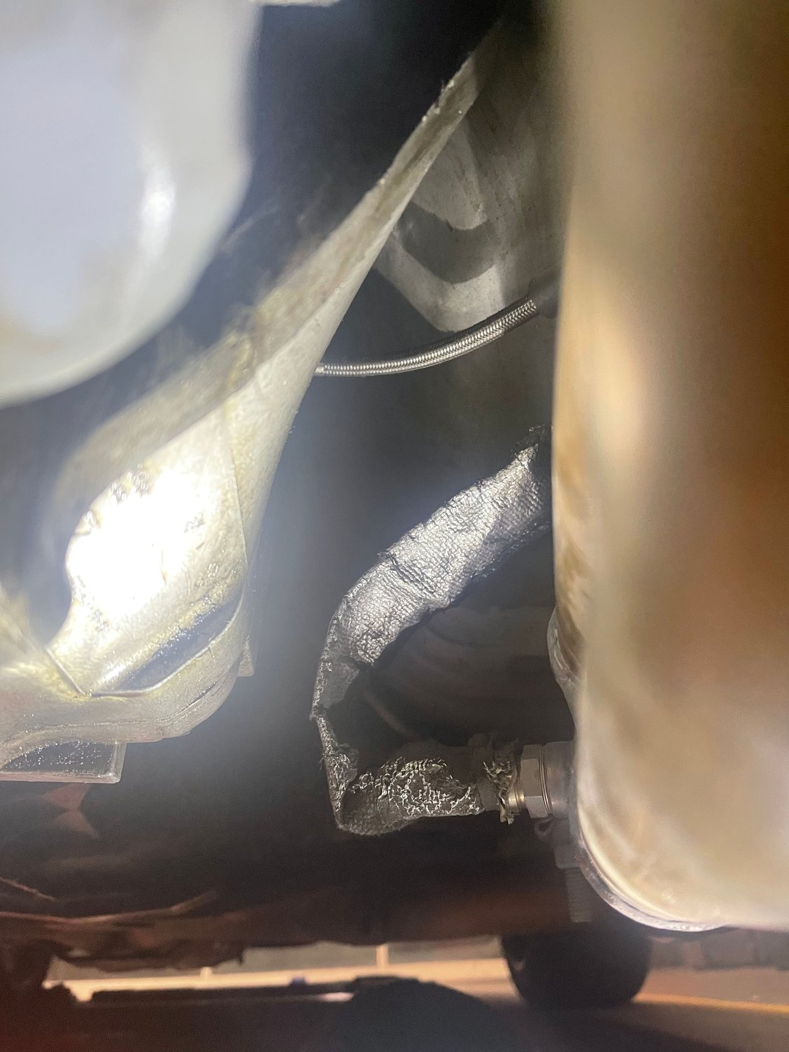

Finally was able to get my Trans Am up on a lift today and found a shield is missing on the driver side of the transmission. I need to identify the part to put a replacement on. Being extremely cautious with the car at this point. I did attach photos. The car is going up Saturday for pinion seal and axle seal replacement so i can do it at same time.
Passenger side looks okay, note the black cover
Driver side, no cover, oh lookie here!!! Gears. …..

Search for "CAMARO/FIREBIRD LS1 LH DRIVER TRANSMISSION DUST COVER" and you'll find the part. The one you have is the RH Passenger.
