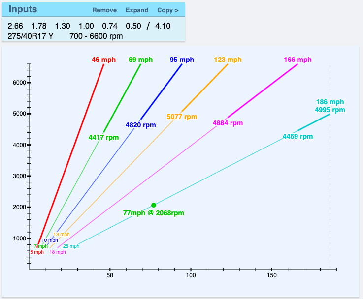

To illustrate, here's what I had before the build (graphs built using the Speed and Gearing calculator I built on my website). This gearing was actually pretty good on the road course. I topped out around 130mph at my favorite tracks, and so I was running right up near the top of 4th gear. With the extra power, I'm thinking I might be gaining more than 10mph, which would mean I might need to grab fifth. Not ideal!
Here's what I'll have when the parts I have today are all put together. In terms of top speed on the road course, this is worse. Have to shift into 5th at 123mph -- that's practically guaranteed on every lap. I'd rather not! Plus, at least before the engine build w/ headers, I had a bit of exhaust drone around 2000rpm, so 77mph (my typical highway cruising speed) @ 2068rpm might be a bit unpleasant.

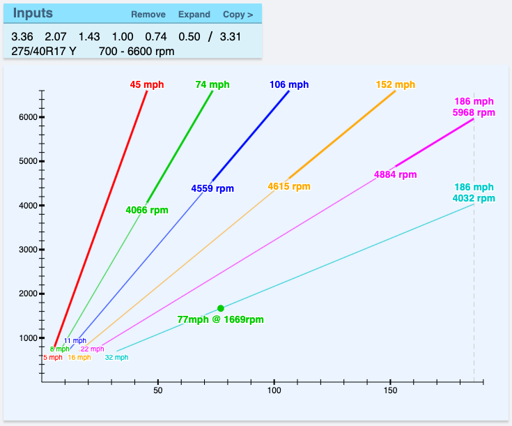

Here's what I think would be awesome. Having 4th gear go all the way out to 150+mph will be really beneficial on the road course -- no need to grab 5th on the straight! First through third gears get slightly more aggressive than stock, which should be fine paired with the extra power. And 77mph cruise RPM gets slightly lower than stock! This feels like the best possible compromise. I might play with this a bit -- I'm not totally set on the 3.31 gears. Maybe go back to 3.42? Those seem to be the only ratio options in this ballpark for a 12-bolt. I've seen 3.35 and 3.40 for some diffs, but not currently aware of any such ratios compatible with my 12-bolt.

3-4 is closer in the 2.66 units vs. the 2.97 units.
Run your existing set up. If you're overrevving 4th, you'll know, and can justify 3.31. That's probably the direction you'll need to go.
The 2.97 unit has wider ratio drops, but evenly spaced 1-4. 2
66 units have closer gearing, but progressively closer ratio drops.
You're enjoying the OD. Maybe 6th will be a little less useful with 3.31. But leaving gearing alone.and having taller track tires might be everything that needs.chamged.
