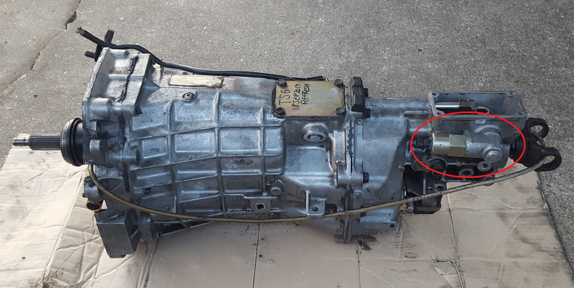

Lean into it so you can over power the Reverse Lockout Solenoid that's blocking you out since nothing is energized.
If power was to it and it was controlled properly, it would dis-engage and allow you into Reverse with no problems.
If you want to test with it off, it's the component on the back of the T56 right below the Shifter with the black plastic Connector Housing sticking out of the brass looking hex part. Unbolts with a 13mm Bolt below it in the side of the Tailhousing.
Ahh got it, this is good information - thanks!!
