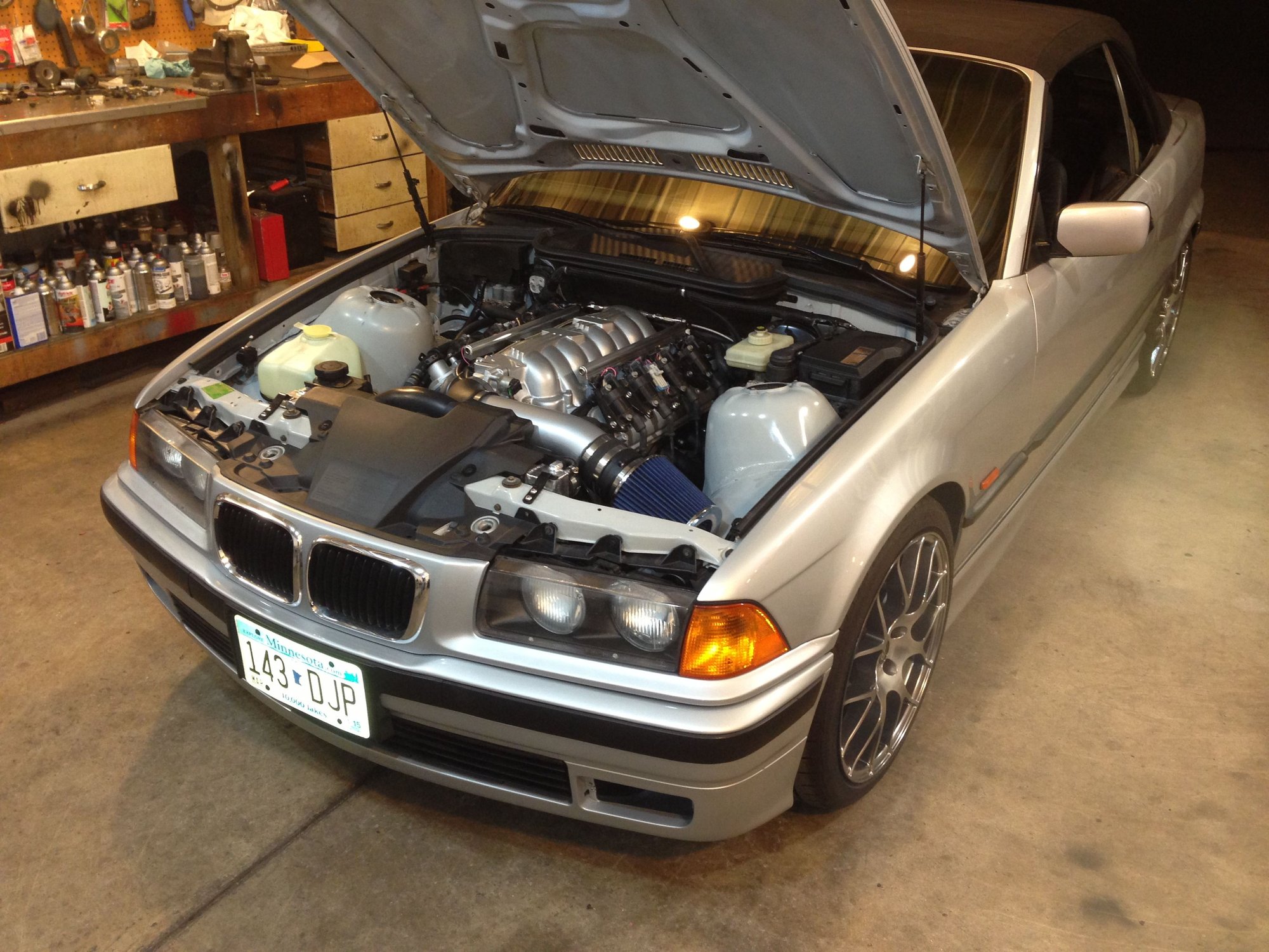

A number of years ago I LS6 swapped a 99 E36 and used a new T56 from Summit. 2002 Camaro bell housing. LS7 clutch assembly. 2002 Fbody slave. Tick speed bleeder.
The T56 shifter came up close to the stock to the shifter hole. Had to make bracket to make the shifter placement perfect. The T56 has a slip yoke output for the drive shaft.
I believe the 6060 have fixed flange output shaft.
Couple of pics. Sold it after a few years for a new project. It was a great swap.
