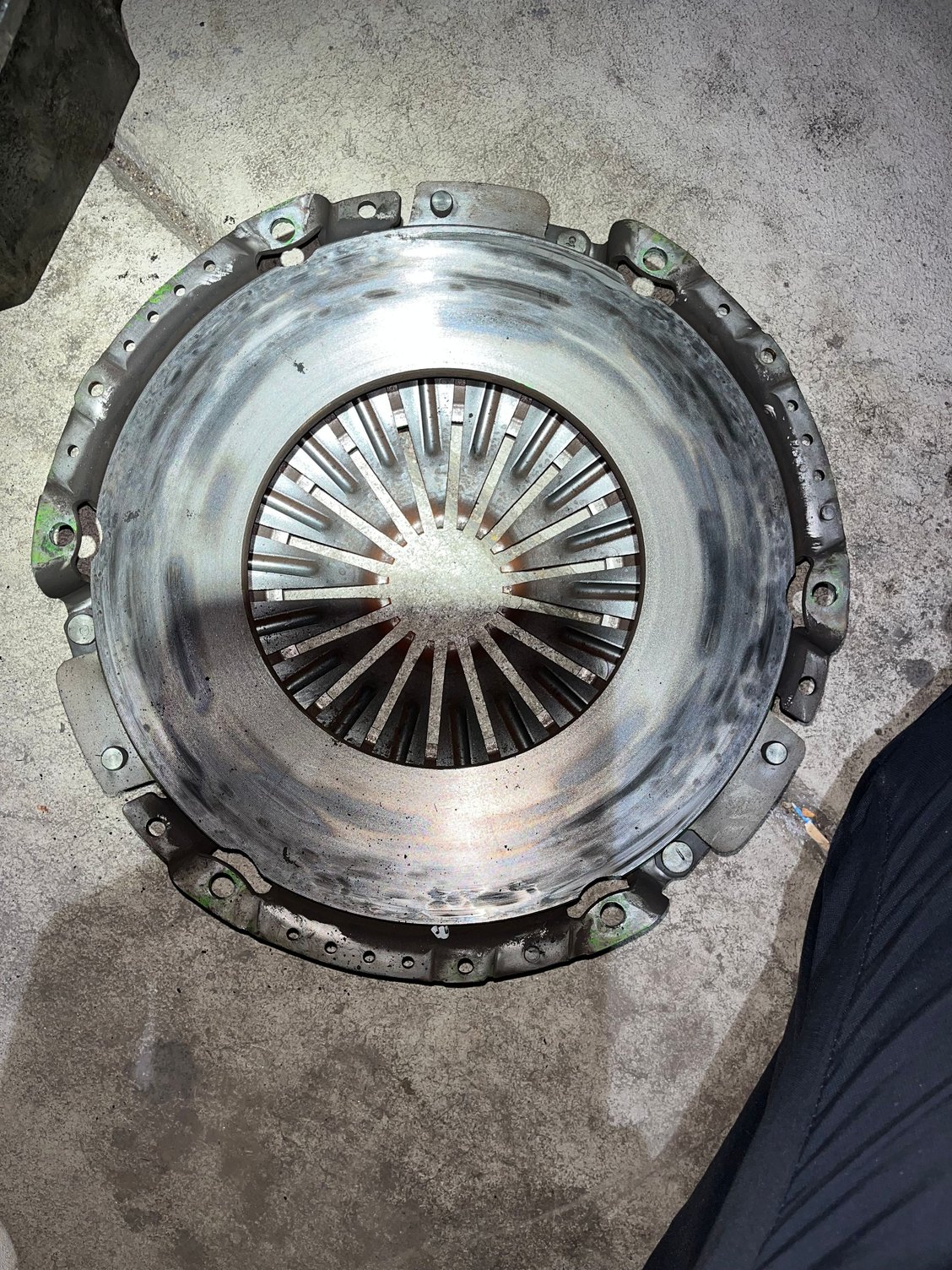

Noticed clutch slipping going up driveway and heard a grinding noise so I pulled the trans and when I removed the pressure plate I found this. Do these look normal or is there something I should be looking at replacing? Pressure plate
Pressure plate
Flywheel
Flywheel

Well if it's slipping I would replace it.

do the flywheel and pressure plate look like they were overheated?

that is heat scoring. what does disc look like?
the flywheel can be turned if has never been. PP can't so new PP/disc

Maybe a little bit? I'm not sure. Doesn't look too different from any of the clutches I've taken off. Only one of those clutches was bad, the rest were taken off for other reasons.
It doesn't really matter though. The clutch was slipping, so you're going to need to replace it. You may be able to have the flywheel re-surfaced and re-use it but I'm not sure. I've always replaced them when I did them.
