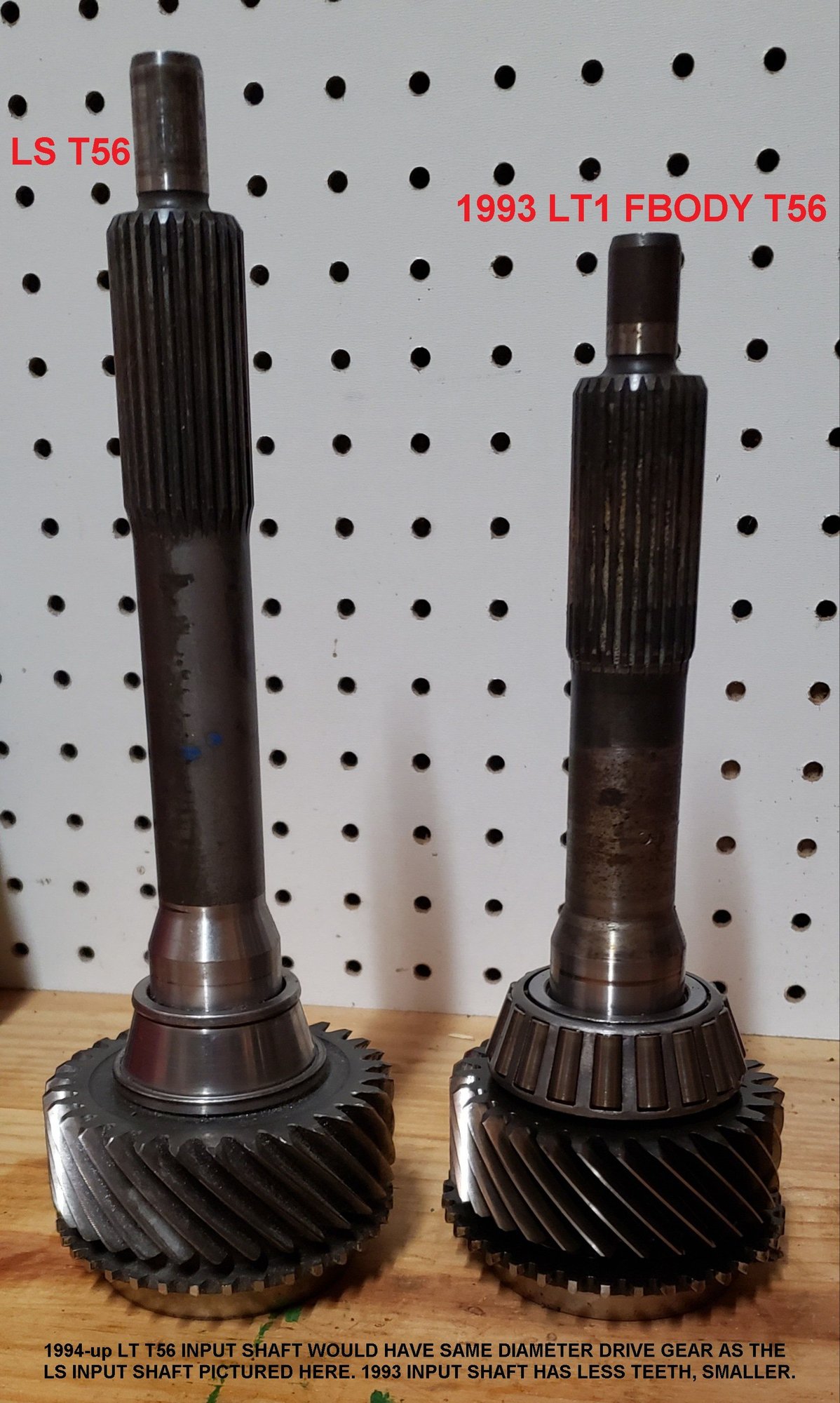

So all that, is for an Auto setup. Pilot refers to the dimple on the front of the Convertor.
LT1 Input Shaft is 1" shorter than the LS Input Shaft. Given how the LS Internal Slave works with the Clutch setups you'll need to convert the LT T56 to the LS type or sell/trade for an LS T56. It is the easiest way.
Pic for reference, I built one a while back.

The most boring, missionary way around this is:
Verify input shaft gear teeth count inside. These mesh with the countershaft.
if 31, get LS1 Camaro T56 input and front plate.
If 29, get the aftermarket conversion input shaft (LS1 Camaro length, fits 1993 Camaro T56), and LS1 Camaro T56 front plate.
You're trying to go kustom without a single upside over "stock" parts.

Easiest way I've been able to spot a 1993 T56 is they don't have the Skip Shift Solenoid on them. That hole is a casted dimple in the side of the case.
Then again that's a complete factory unit no one has been in.
Converting to LS spec or getting one will be the simplest way.. just how it is.

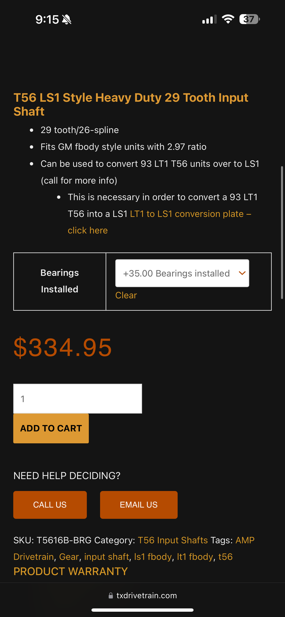

so question i have a early t56 i believe the splines on the countershaft are 26 i found something online that would make it to where i can convert to a ls style input shaft. i think its a 93 or 94 i will send some pictures of the case when im home but the guy who built my trans said that a normal basic ls1 input shaft would not line up with the countershaft i have 2.97:1 first and know for sure its an early model t56

do you by chance have the link for the 29 spline i think i may have found it but want to make sure
29 TOOTH, not Spline. Attention to detail here. Literally says it in your pic you posted.
I am very familiar with the 1993 M29 stuff, I build T56's and converted one into a LS Fbody unit with C5 Corvette Gears because I got the parts to do it.
Again, in this case built it to LS Spec, it's easier.
