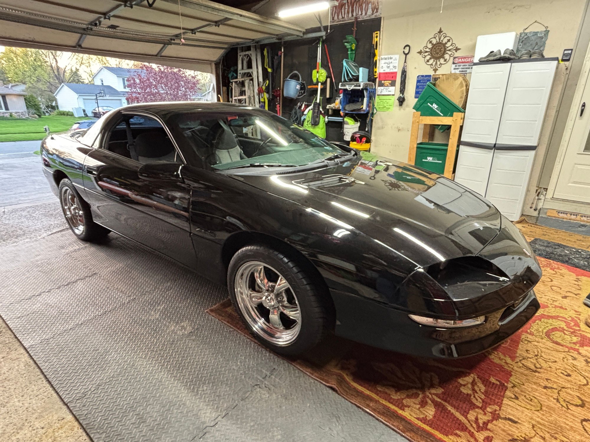

I have a new to me 94 Z28. This is a pretty nasty build.
LT4 intake
LT4 Hot cam W/1.6 rockers
Cam= 218/228 duration@ .50", .525 lift , 112 centerline
Airflow research LT4 heads
.20 over pistons 11:1 compression
Forged Eagle H-Beam rods
SLP light weight flywheel
Centerfource Dual Friction clutch
12 Bolt 4:10 Posi rear end
Spohn Performance Torque arm with relocation brace and drive shaft loop.
All Spohn rear suspension
Completion Engineering drag shocks.
This is basically a street bruiser drag car.
I was able to get her out and about some and finally and drove her to work today. Trying to learn the car and what is a normal noise and what is not.
She runs great, shifts, smooth (I'm still getting used to the clutch, so sometimes NOT smooth) handles OK, its setup for drag racing, not corner cutting. (that's gonna change), brakes are good and over all feels good.
However, not being used to a build like this, not sure what is a normal noise and what is not. I have had all automatics for Camaro's and my manual trans have been little imports and trucks.
This car was supposedly built by a very good speed shop in Detroit, but without papers - it's all hearsay. Mike's Machine Shop Wixom MI did the engine work. All of the suspension and rear end appears professionally done and done right and not half assed.
Not being used to a T-56 and this setup, not sure what is a normal noise and what is not.
So I have a bit of a howl/whine in 4th at 40-50, which goes away on acceleration or deceleration. Shift and 5th is not too bad, still a slight howl/whine but not bad, and 6th again a bit of a howl.
Its at the cruise point, when you're not accelerating or decelerating.
Now with the rigid rear suspension build, relocated traction bar, trans cross member and hardware, I don't know if this is normal because nothing is really dampened for noise. For all I know this is to be expected because it all radiates the noises, or this is normal because of the 12 bolt spool and 4:10 gears.
The noise seems to be coming from mid car. I do NOT feel it in the shifter. It does NOT change cornering or braking.
I have not checked fluids, that was suggested to me. I read some posts about where to check that on the T-56. GM diffs are all the same. The car was at a consignment seller, there was no indication of fluid leaks from either trans or diff.
Does the car have to be level to check the T-56? Or can front be jacked up enough for me to slide under and pull the plug and check it?
So what I'm asking - could this be normal? Or should I start looking deeper? Anyone with a similar build?
Thanks gang!
Pic for attention!
