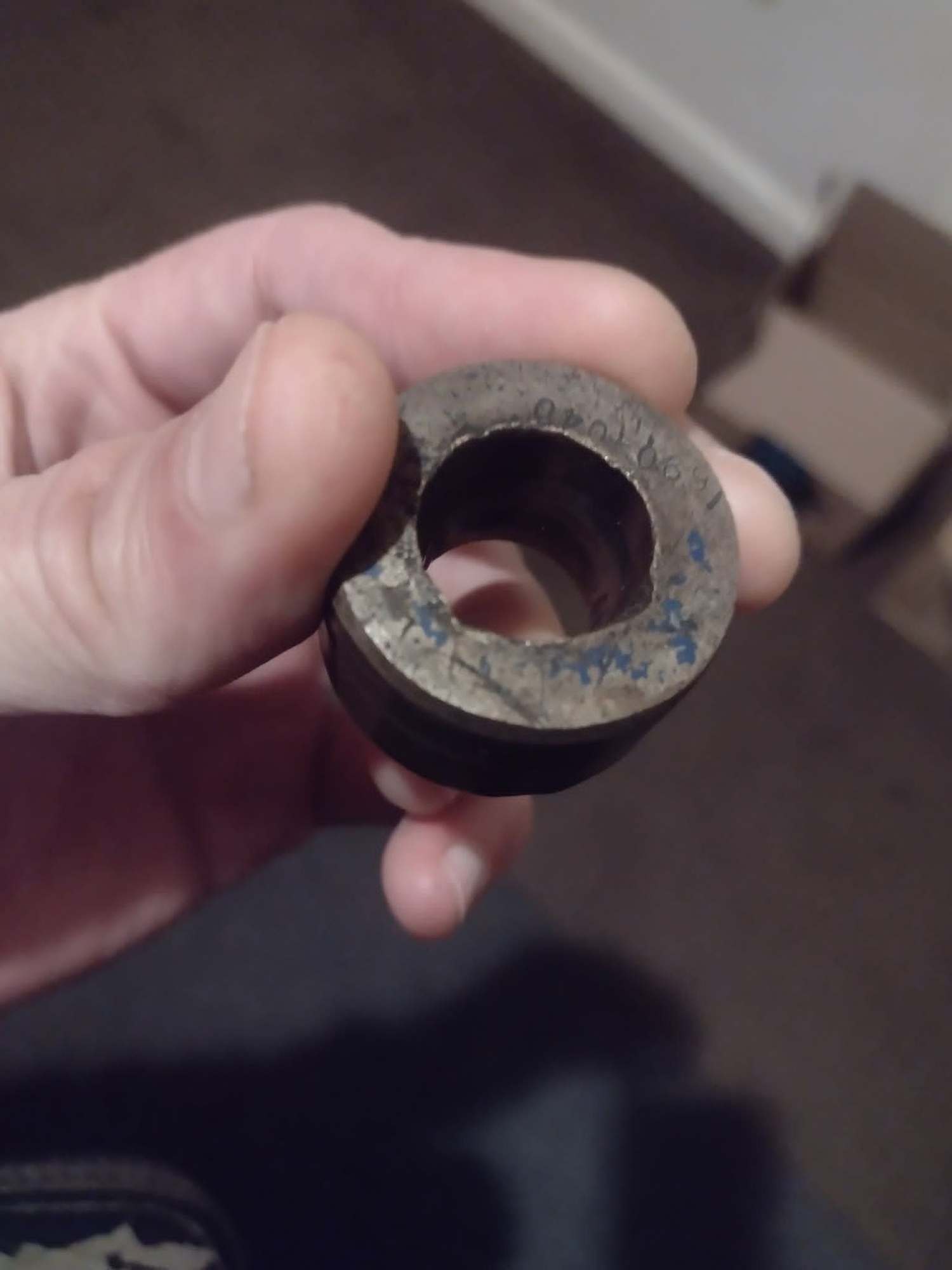

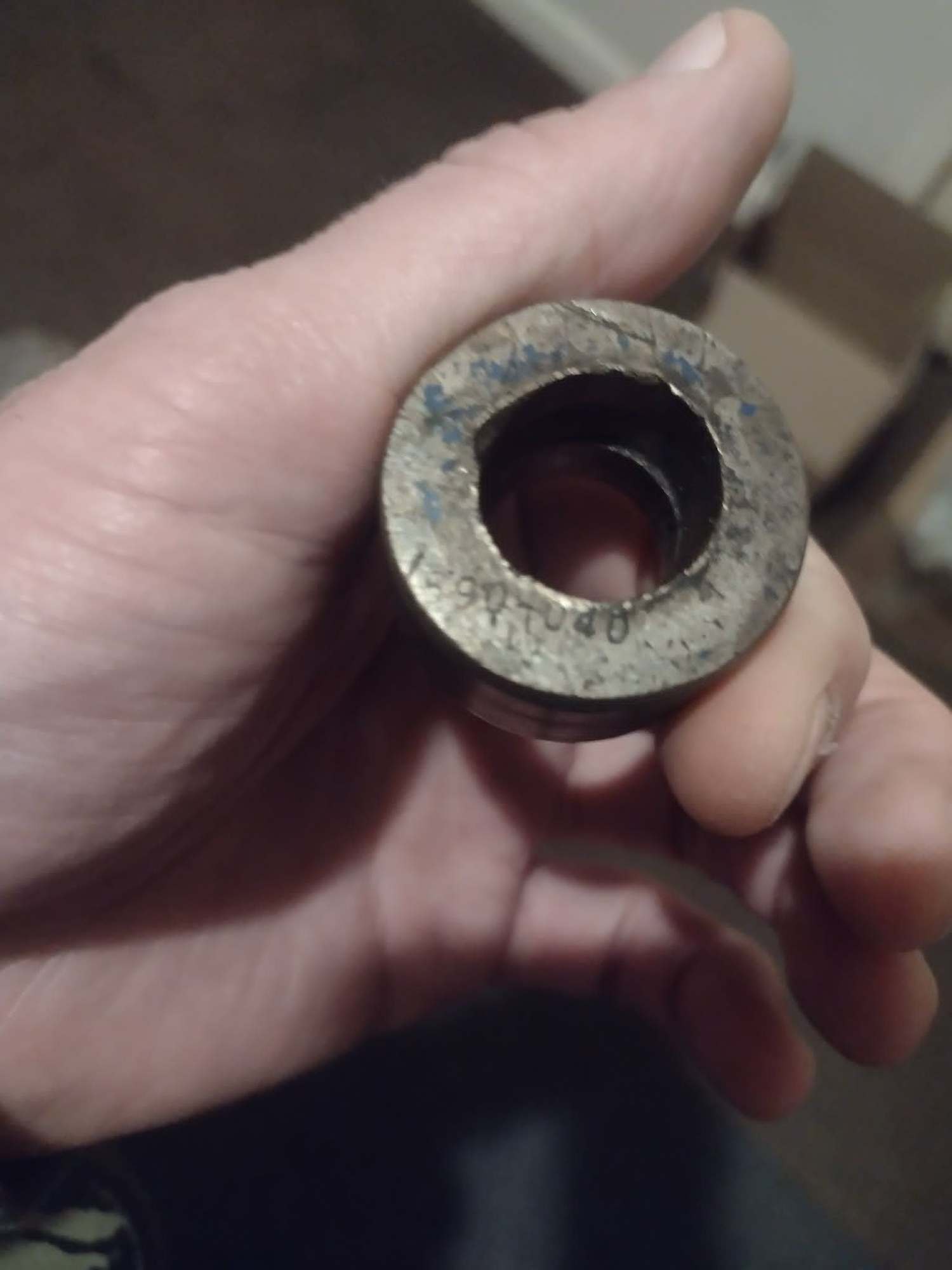

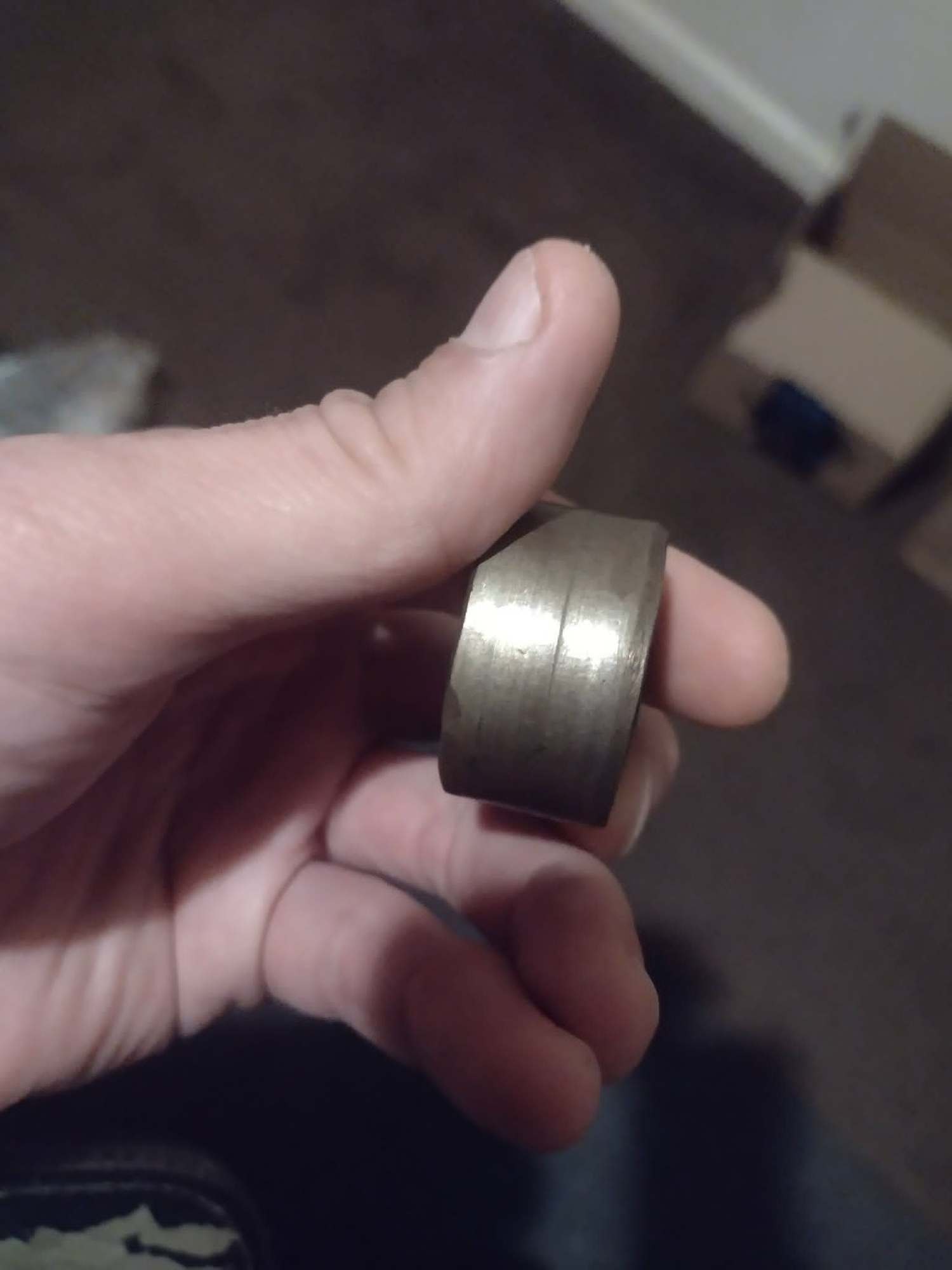

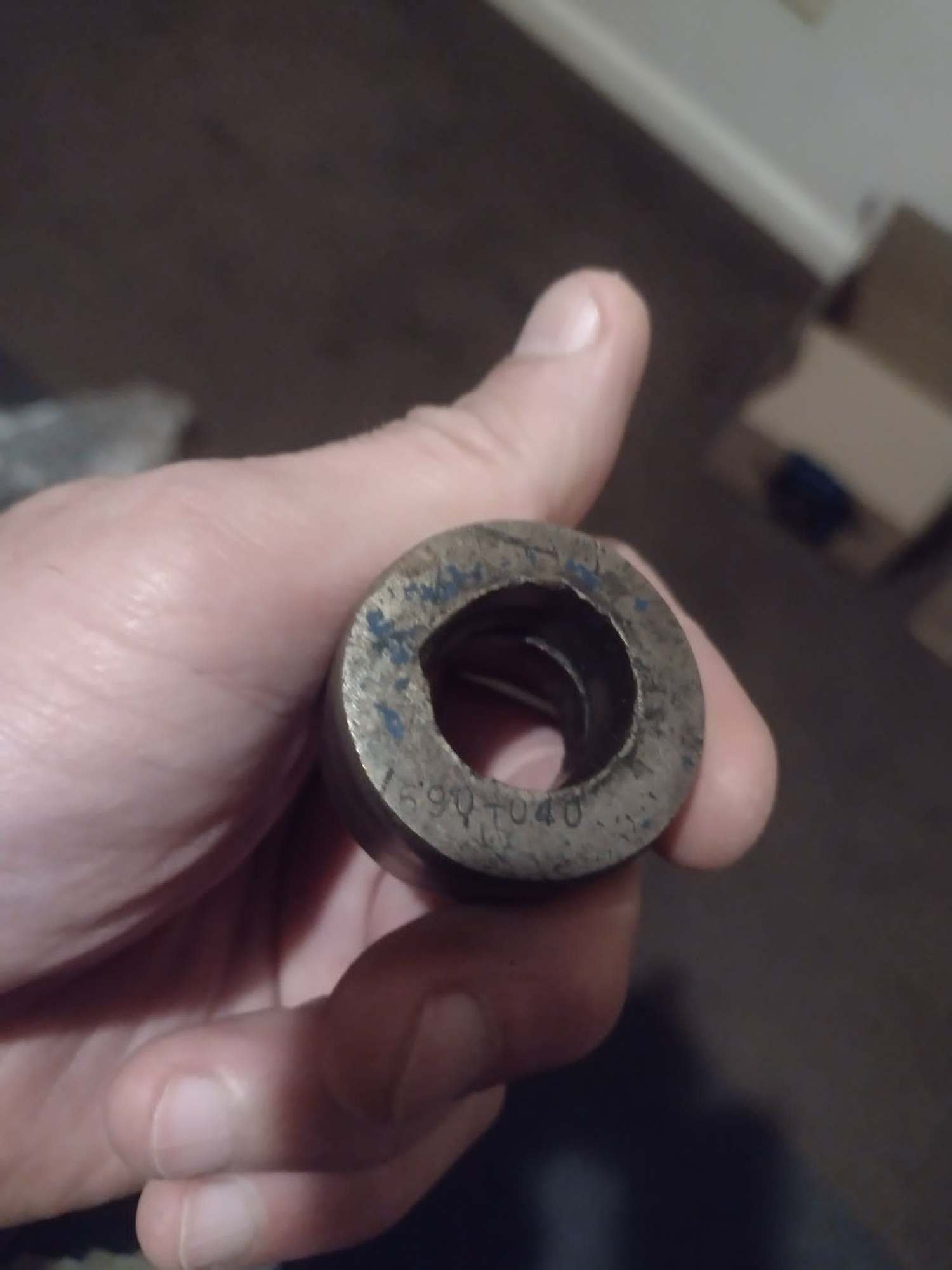

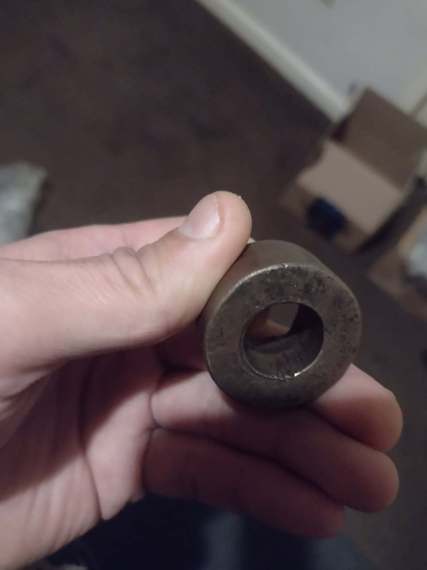

Anyone use the pilot bushing instead of the pilot bearing? There should be one thats functions or is a direct replacement for ls1 engine t56s. Usually theyre made of a softer material and wont chew up the input shaft like the needle bearing will when it fails. I believe its cintered cronze or powdered metal material?

Yes I've used both. Currently running a bushing but plenty have run the bearing on high HP builds. I had an issue with the bearing so just went bushing given I don't drive the car much and can swap it out without too much issue.

Im curious the bushing material should wear and not the input shaft. Only because i had a needle bearing chew up my 98 z28 t56 input shaft i had to have it refinished. Im trying not to mess up the m12 t56 500$ input shaft and thought possibly the softer bushing would be a better option.
