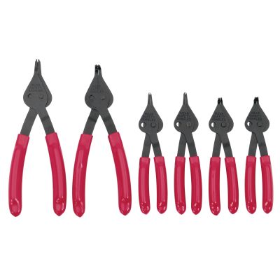

hey guys im gonna buy some snap ring pliers for my T56 and because im sure ill need them in the field soon. ive come across these so far...
http://www.matcotools.com/ProductImages/psri4.jpg
http://www.matcotools.com/ProductImages/mst690.jpg
i see that they have different tips, but why and which would better suit me? thanks guys!

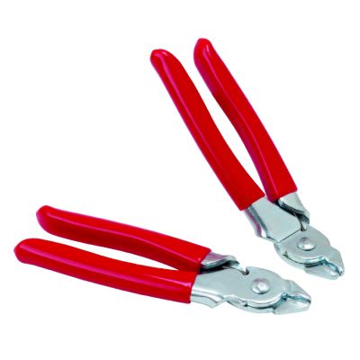

these r "hog ring" pliers. i cant find lock ring pliers. any help?
http://www.matcotools.com/ProductImages/ms2phr.jpg
